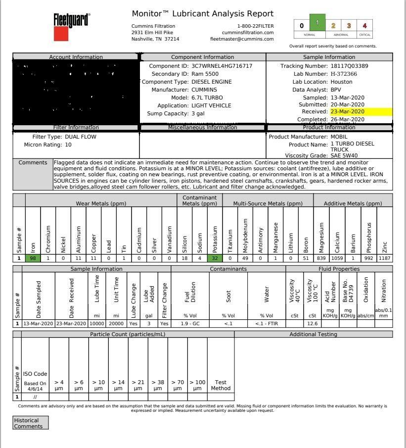

Friends,
I received the oil analysis back on my 2017 Ram 5500 19970 on the clock, 2nd oil change with about 10K miles on the last change, Mobil 1 5w40, FG Stratapore. I put about 10K miles on the factory oil fill and filter, but forgot I had oil sample kits. So thiHappy to hear any comments from the gallery. Truck duty cycle is between 80 and 90% heavy towing (~34KLbs GCW), the rest is to keep er running and running around while out on the road; (Gary, did I do OK approximating duty cycle?)
Anyhoo, appreciation the input.
Cheers, Ron

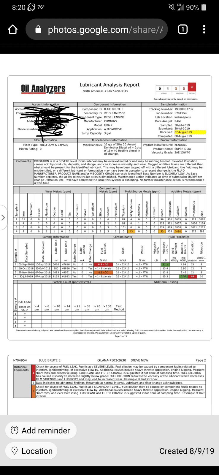

I have always had my iron less than 15 ppm. The longest run though is 8155 miles.
https://photos.app.goo.gl/aGGPQ4P6hooQTmrx7

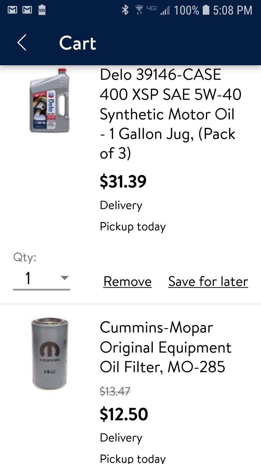

That MOPAR filter shown above is NOT a StrataPore. Couple bucks more StrataPore , Donaldson Blue or re branded AMZ/OIL filters are far superior.
