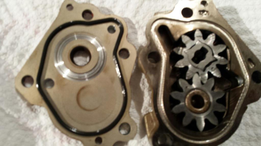

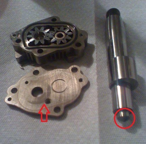

Most filter specs are extremely mis-leading, the Owner of this CP3 pump is going to pay a high price, He put faith in a WIX filter 33527 / 33616 Both filters should have never been used, The Pump is our 11.2 stroker Race CP3, The 1st gear is the suction side of the gear pump, 100% of all fuel entering the feed cavity must travel thru this GP,The entire pump is destroyed it blew up form lack of fuel (starvation) and contamination. It blew up shortly after installing the new filters. The truck was 1/2 tank when this happen, so its unlikely that the tank fuel is contaminate, either something was in the filters or poor handling, The eccentric shaft was not snap off at GP key way. This picture is a good for what happens over time when you feed a CP3 GP to much pressure, the gear will wear against the backing plate and eventually span the shaft.
