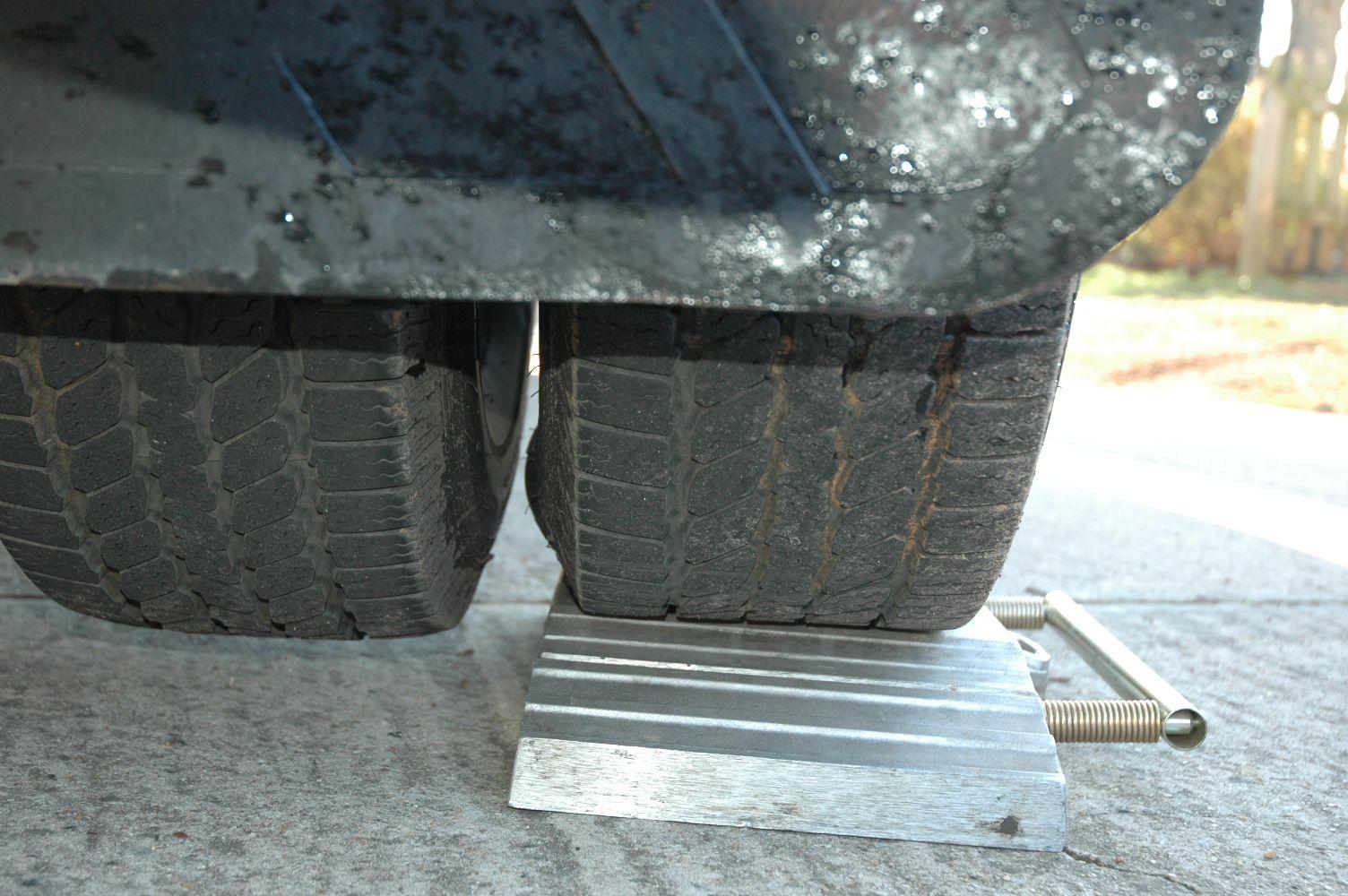

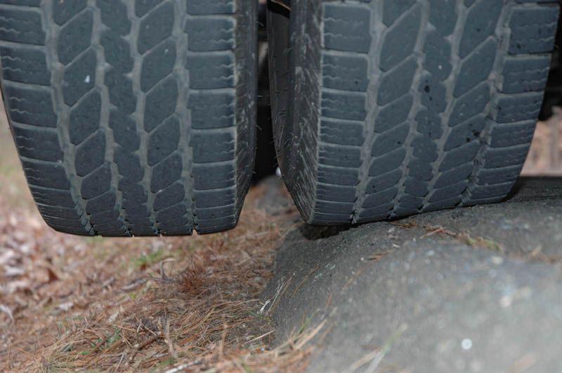

Everyday when you tow heavy with 17" tires you overload them not even knowing it. That in itself is not the biggest problem. Especially when you tow in excess of 30k... Now it is 35k with new rigs you have a problem especially when several things happen at the same time. You are driving along without a care in the world and your axles/tires on the towed rig ease off the shoulder. That sets off a chain reaction. The front of the rig at the king pin violently kicks the rear of your truck toward the center of the highway. Your nearly overloaded 17" tires squish one way. The driver reacts to correct this. The towed vehicles tires re-enter the road and violently kicks the rear of the truck in the other direction. During this time one side of your truck those two dually tires slide off the shoulder. What if the should looks like they do in the photos below. As soon as the outside tire leaves the ground the inside tire have 6k of simulated load on it. By this time your wife is jumping out of her door. Repeat this situation with 19.5s you are calm.

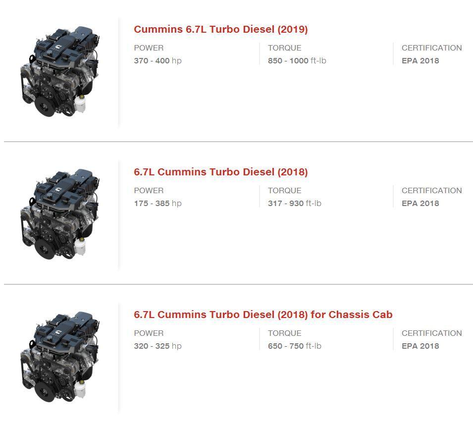

Goes to show you how much time I have being retired. This is the only reference I found to this, but I believe the Cummins website bears this out. The show Cab and Chassis motors as a separate category and show max HP at 2400 RPM. The pickup engines and specs are listed in a separate category with 2900 max HP.

Check this on the Cummins website: (note 2013 has same HP/TQ specs, but 2018 must have different EPA specs). I was blown away too.
"Everyday when you tow heavy with 17" tires you overload them not even knowing it. That in itself is not the biggest problem. Especially when you tow in excess of 30k... Now it is 35k with new rigs you have a problem especially when several things happen at the same time. You are driving along without a care in the world and your axles/tires on the towed rig ease off the shoulder. That sets off a chain reaction. The front of the rig at the king pin violently kicks the rear of your truck toward the center of the highway. Your nearly overloaded 17" tires squish one way. The driver reacts to correct this. The towed vehicles tires re-enter the road and violently kicks the rear of the truck in the other direction. During this time one side of your truck those two dually tires slide off the shoulder. What if the should looks like they do in the photos below. As soon as the outside tire leaves the ground the inside tire have 6k of simulated load on it. By this time your wife is jumping out of her door. Repeat this situation with 19.5s you are calm."
CUMINZ, Just my perspective on your scenario of catching the edge of the road: I love the 19.5s, but I learned the stiffer sidewalls and lower profile tend to push the rear in the direction of a slope. I have to be careful on narrow roads. In Texas on two lane roads with extra wide shoulders, it's a common courtesy to provide "Texas Courtesy Pass," many 18 wheelers do it, but not me... I stay firmly planted in my lane.
Not disagreeing with you...just adding my experience with loaded low profile 19.5 tires.

The C&C will get an output bump from 2018 numbers, and yes, the emissions and output are certified using different methods. Since the 2019 pickup engines have two different compression ratios (among other things) I think it safe to say the engines are not all the same inside.
Taking this backto the top, 30HP/70TQ is an incremental increase that happens to take the total to big numbers 400/1000. Sure there will be beefier components, improved programming, including torque management.
