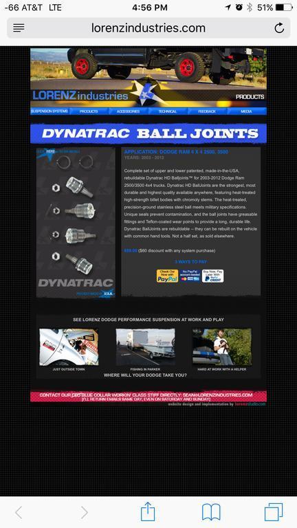

http://lorenzindustries.com/products_ball-joints.html

Do you like the DynaTrac ball joints? I have not made up my mind on brand yet (except no Moog!)......I had been thinking of going with Carli.
