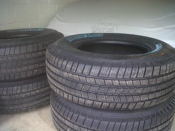

I needed a new set for my work truck, so after reading about them here, I ordered a set of the LTX MS/2 and they arrived today. I didn't have much luck with the tread wear on the last set of LTX AT 2's I had, but we will give these a shot and see what happens. I'll get them mounted this weekend and will probably have 6-7K on them by the end of June. Hopefully I'll have a good report to share with you all.
