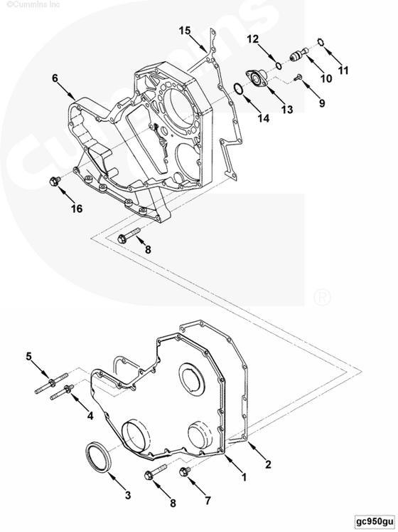

I've got an oil leak which appears to be coming from the timing pin. Any ideas how to fix this? Does the vacuum pump have to be removed? Thanks.

I assume that this is on your '96.
I have attached a picture of what is there. There is an o-ring on the pin itself plus one where the timing pin holder bolts to the rear of the front cover.
#12 3913994 O-Ring
#14 3915772 O-Ring

Does the pin come out by itself or do you remove it's holder also? Thanks. Anthony
As I recall you remove the retaining ring (#11) and then the pin will come out of the holder.

Yup use a pick type tool to pull the retainer then the only thing holding the pin is the o-ring that might be a little stubborn You don't want to pull the holder out unless it has to be repaired. It is adjustable to make the pin accurate
