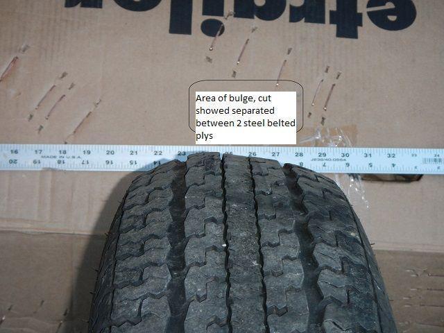

Mine were getting there, starting with a bulge... I did a cross-section cut to confirm ply separation was the cause.. given more miles it would have no doubt started to come apart, but the spring broke first in my case, likely due to the increased vibration on that wheel/axle.
I'll try to attach the picture..
