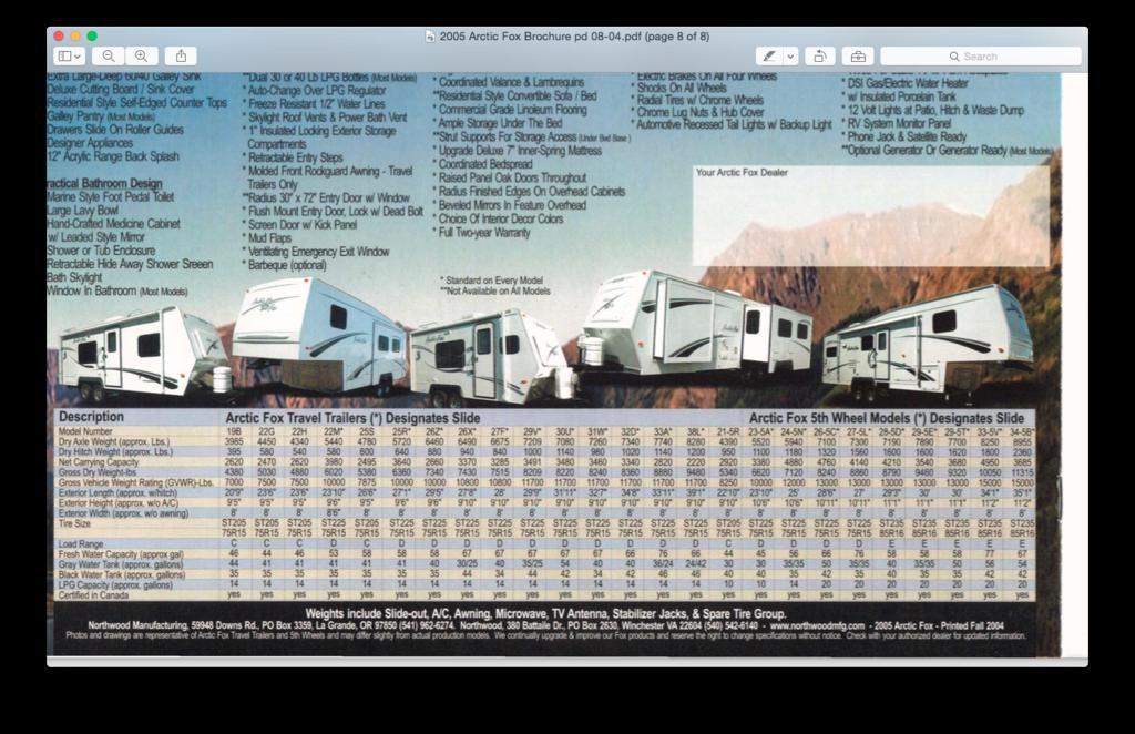

This is from the Manufacture. A 2005 Arctic Fox Trailer 38L weighs dry, 9480 lbs. with a dry axle weight of 8280 lbs. and tongue weight of 1200 lbs. A 2005 Arctic Fox 5ver 29-5E weighs dry, 9460 lbs. with a dry axle weight of 7890 lbs. and pin weight of 1600 lbs., so whos smoking now. Thats 400 lbs difference transfered to the pin by manufactures numbers. I know our weed (Calif) is much better than Idaho's dirt weed, but its still gets you high. :-laf:-laf:-laf
Now concider the stability of moving that weight to the front and rear axle of the TV compared to that weight on the rear of your TV frame/bumper. Thats why the 5vers are more stable than trailers, especially when it starts to sway.

I am thoroughly enjoying your attempt at this, but sorry it's not working. You have also changed your story.
Let me re-quote you.
2nd) Because it's a 5ver it effects GCVWR in which transfers weight to the trucks GVW and subtracts some of the 5vers weight.
But now you are stating it different.
Thats 400 lbs difference transferred to the pin by manufactures numbers.
YES!! Transferred to the PIN, NOT THE TV.
So which one do you really believe??
The GVW of the trailer doesn't change based on being a TT or a 5er, simply where the weight is carried. In neither circumstance does hooking the trailer to a TV reduce the GVW of the trailer, as you stated earlier.
I hope it's the second, as that is a transfer of weight. The first one, the one I questioned you on is not how the weight works on a 5er.
