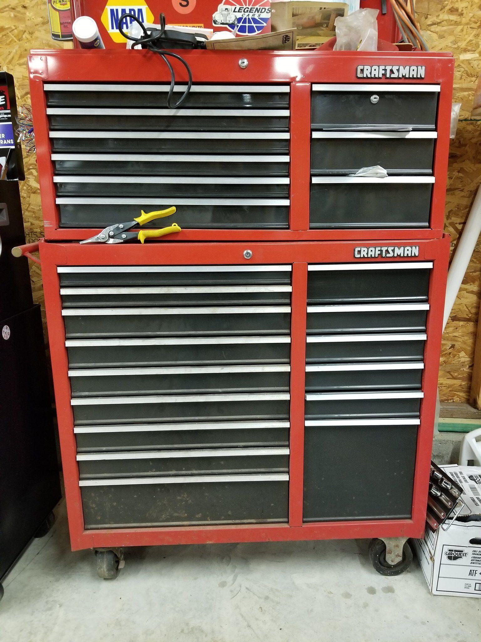

I have had my Craftsman box since 1996, it has the basic old school slides, its special because I paid for it and worked hard to have a nice box, I started to refresh it a bit, pulled all the drawers lube the slides and replace the drawer liners, no plans on getting rid of it. It has paid me back many times over for sure.

The box you show looks like my box that I got in 89 or 90. The slides are pretty shot, but still sorta works. I removed anything heavy and now just have light stuff in it.

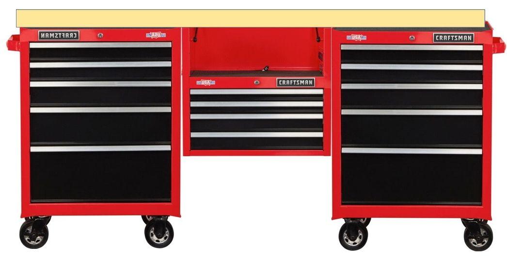

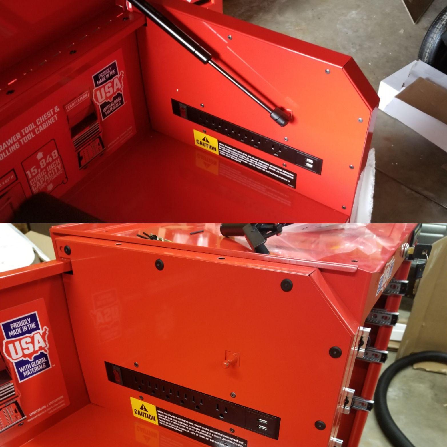

Got distracted with this project but I have my plan.
2- 26.5" 5 drawer with one 26" top boxes in the middle. Im going to remove the flip up lid and use the shelf area as a charging area for stuff. Then a 7' butcher block counter top.
A local Sams club closed so I picked up a brand new 40gal fire cabinet, a portable sink thing on wheels, and a stainless steel cart thing so thats where my tool box money went. The portable sink has hot and cold water, 10gal of gray water and 5 gal of fresh water. Its pretty neat, I dont have water out by my shop.
Here is a quick hack of what Im thinking about. I think it was $836 for this set up, unless I wait for a sale or a ding and dent floor model.

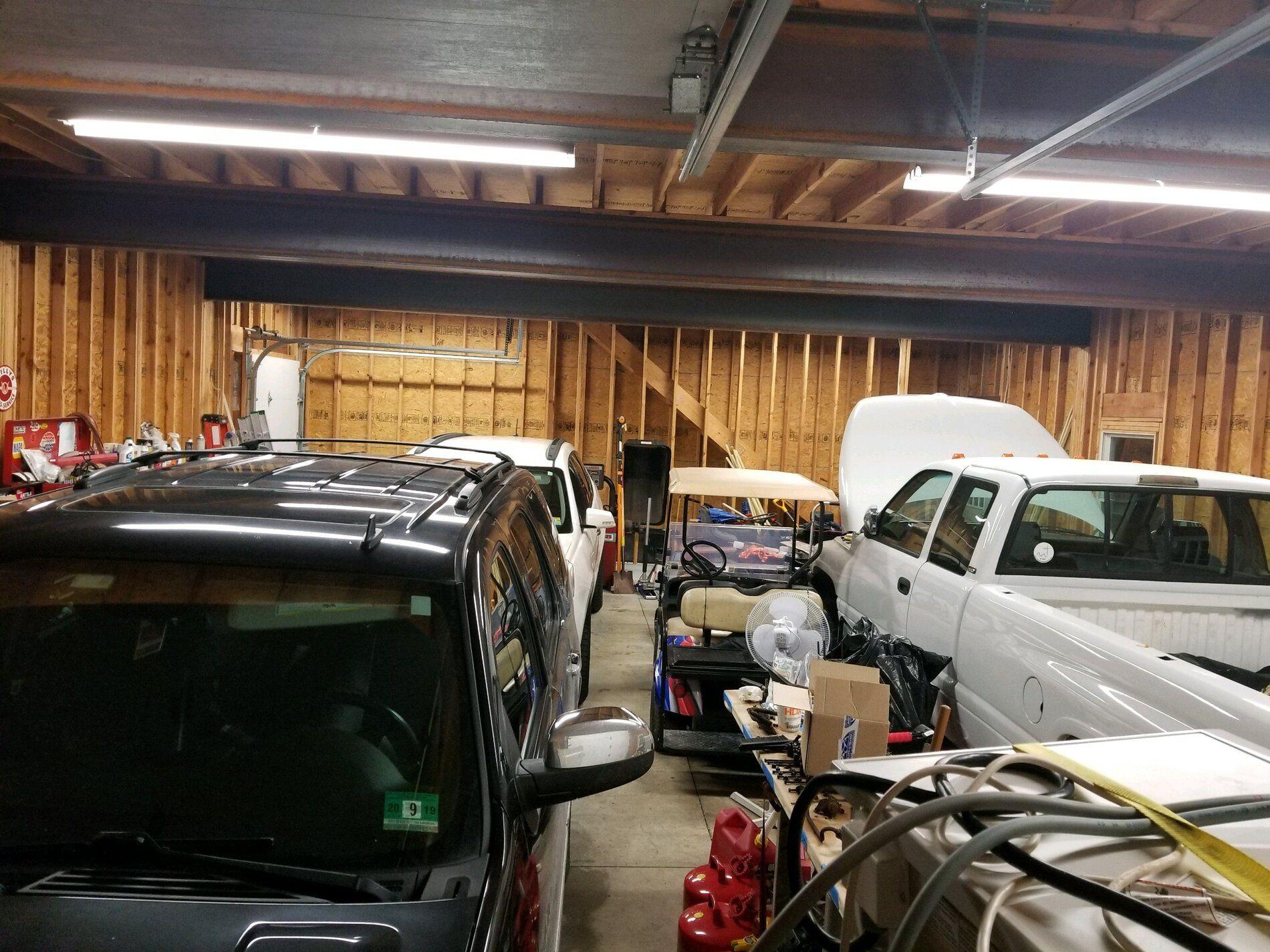

Tim my shop looks alot like that at the moment. Knee deep in 3 projects and dont have time for one.

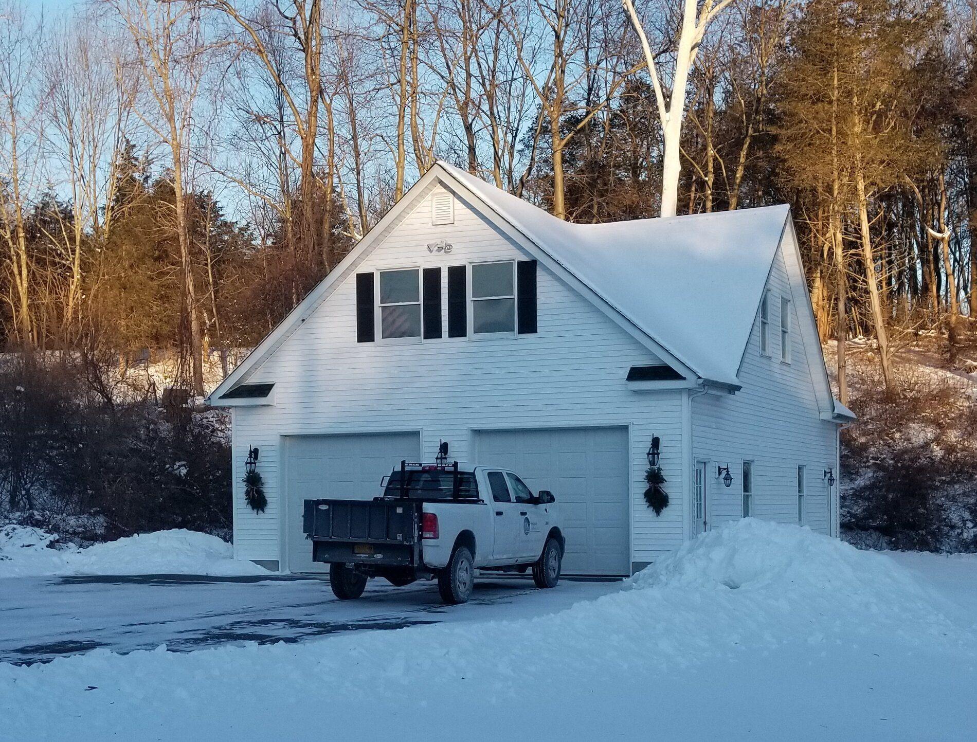

OK, I am analyzing your picture. And hijacking that thread. So, you have a two story garage? Those beams are very large to hold up a roof. I see you have a tire balancer. Do you also have a tire changer? I finally upgraded to a Rim clamp one and sold my old 4040sa.
Yeah its a building house style garage. Upstairs is empty.
I have a Coats 5040 rim clamp, and I think that is a Coats 1080 balancer.

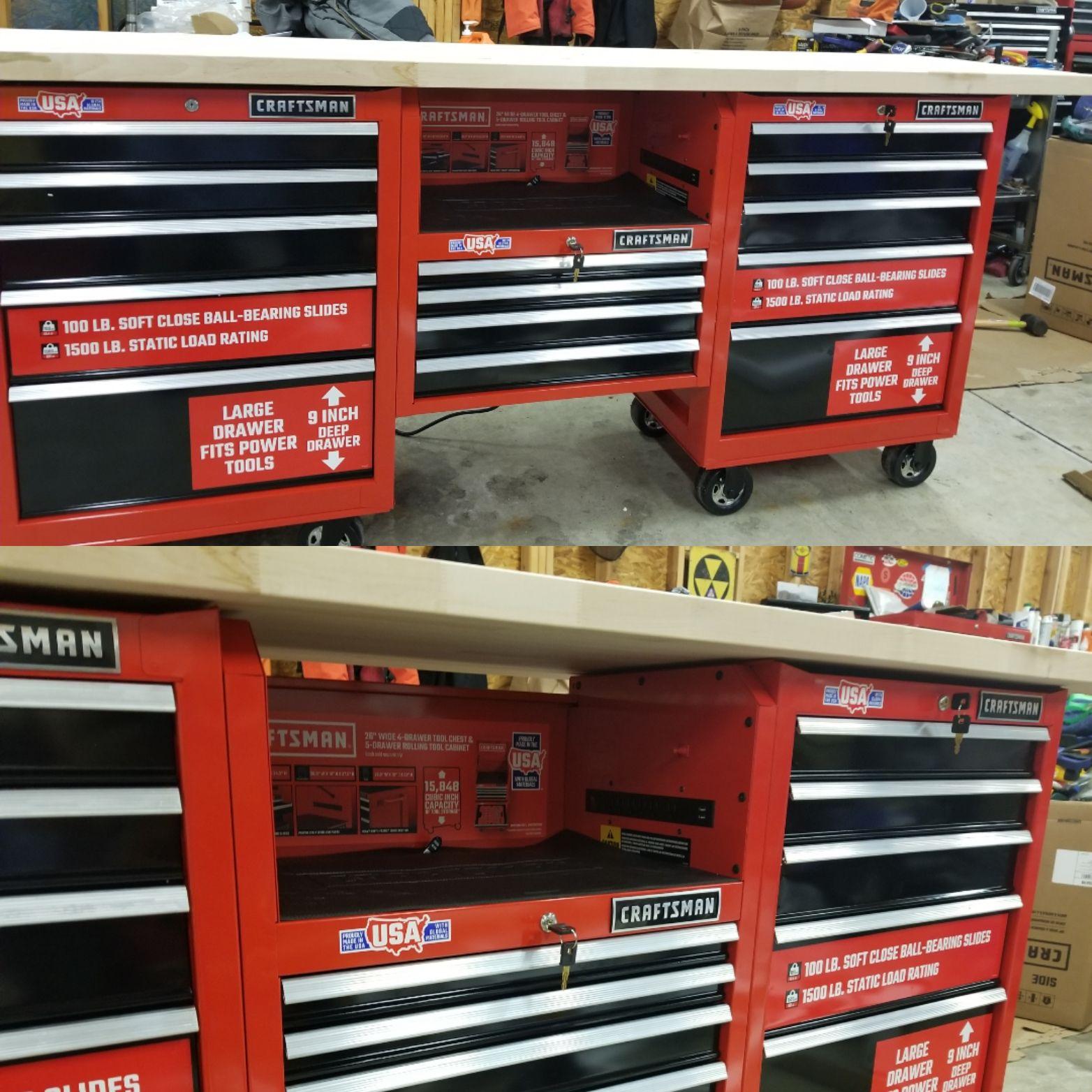

So was able to almost start and finish my tool storage project.

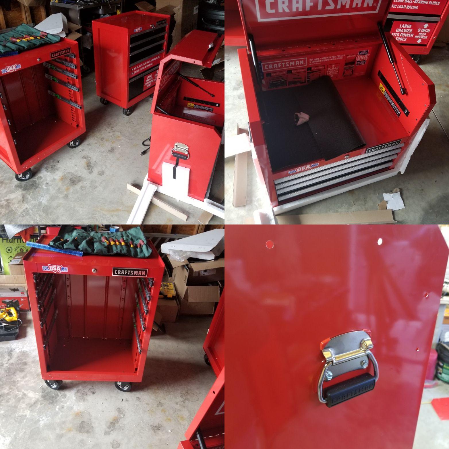

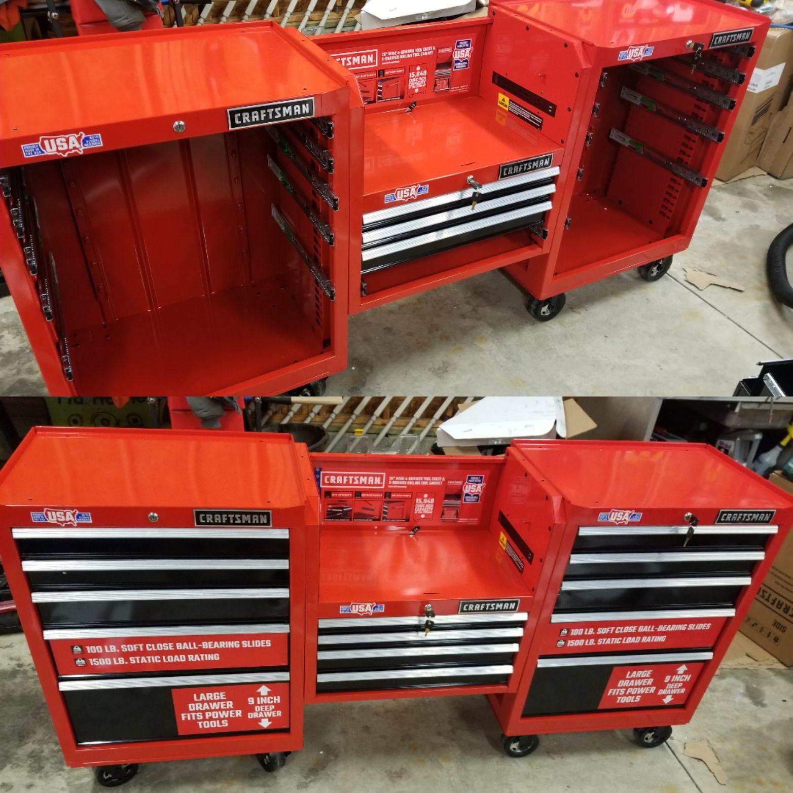

Had to drill out some rivets to get the top off and drill and bolt the 3 boxes together. Was able to use some plastic rivets to put that trim back together.
Still have to secure the top have to flip it over.
But happy with the results.
I put all the swivel wheels on one box and the fixed wheels on the other, it moves around pretty well for 72" long.
Coming together great. Not that it really needs it, but do you plan to make filler panels for the top of the boxes, beneath the top?
I have some 1/2 x 1" wide rubber weather stripping, I think I have like 600' of the stuff from a outdoor switchgear job, I might just put that on the leading edge the sides and back have that litttle edge, I think its 1/4"-3/8" top gap possibly.
I need some square washers from my shop at work before I lag the top down to make up the gap from the box top to the wood.

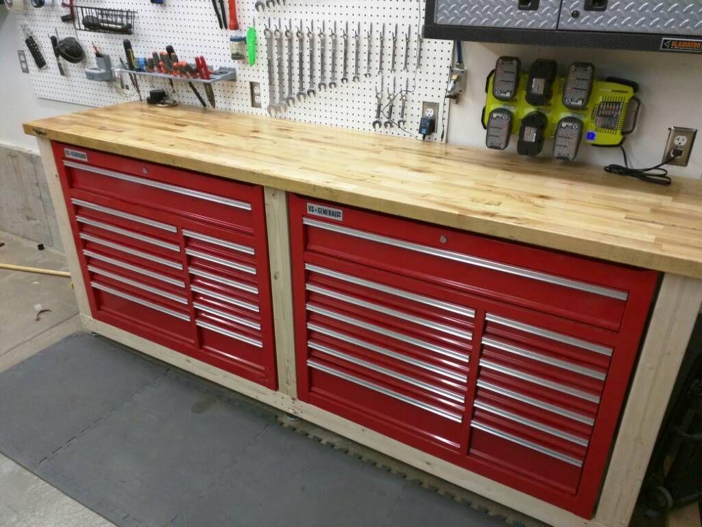

I watched CL and FB for a while to find a nice metal storage cabinet with shelves and doors that was 24" deep. The cheaper ones are usually 18" deep or less which imo is too shallow.
Doors are nice because it keeps everything clean.
