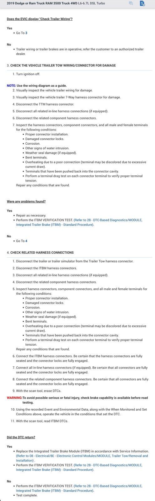

I could only find that message for the check wiring, not the trailer disconnected message.
I also only found these steps under a "C" code, so there could be additional info available to the dealer at time of the message? For example these steps are listed under...
  • C10C7-19 ITBM Output Overcurrent (ITBM that's the integrated trailer brake controller)
Also listed under a few other ITBM codes.
Here is a screenshot of some steps.
It involves a bunch of connectors.
There are some pre-check and post-check stuff way too much to post in this format.
But besides bringing it in and having them run all the tests never know you might stumble on something here.
There also was a website like autocodes or something someone links to that once im a while, maybe they can dig out that above code and see if it has steps for these messages.
