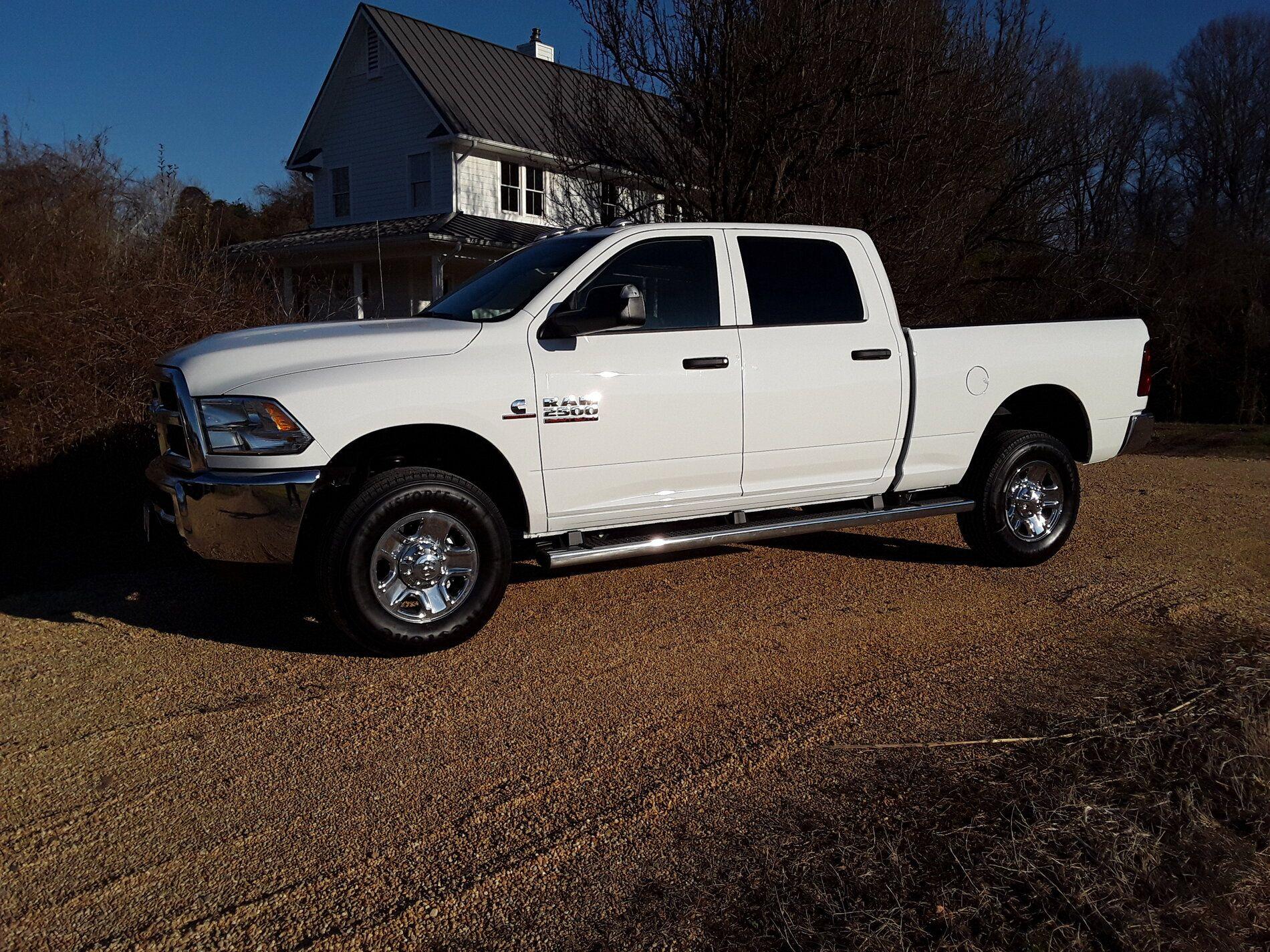

The one thing I know is the loaner truck worked perfectly. It's a 2018 Tradesman 6.7 crew cab. 68RFE unit.

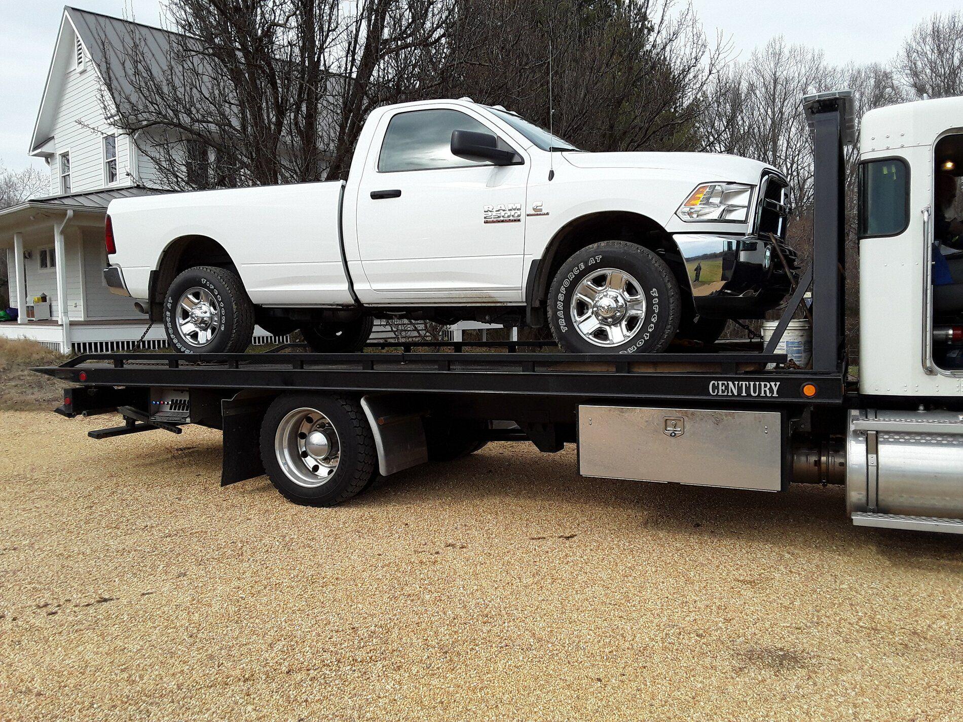

Last ride on my watch.
Nice pick'em up truck. Your support team is backing you up. Recommend keeping slight throttle going down hills.
Cheers, Ron
