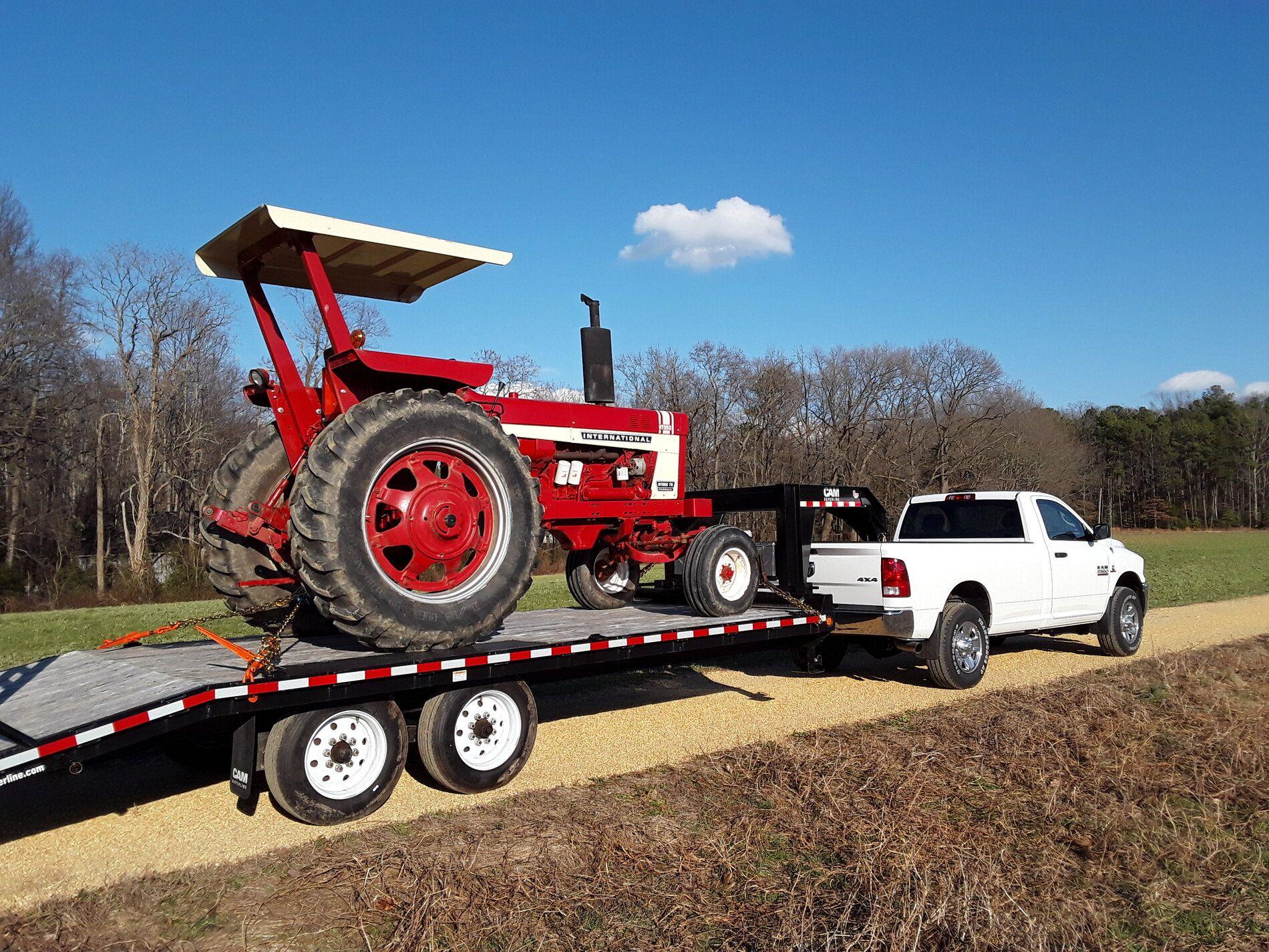

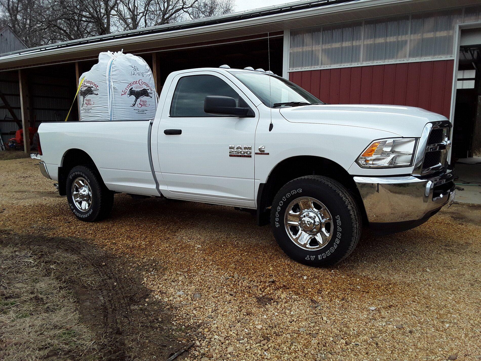

You do realize, that the two pictures you have there are not of the same truck? One is a four-door, one is a two door.
I see what is wrong! You were driving someone else’s truck!
I mistakenly uploaded the loaner photo. My truck is the regular cab two door.

Photo: hours before the first failure. Loaded trailer is 13,500 lbs.
