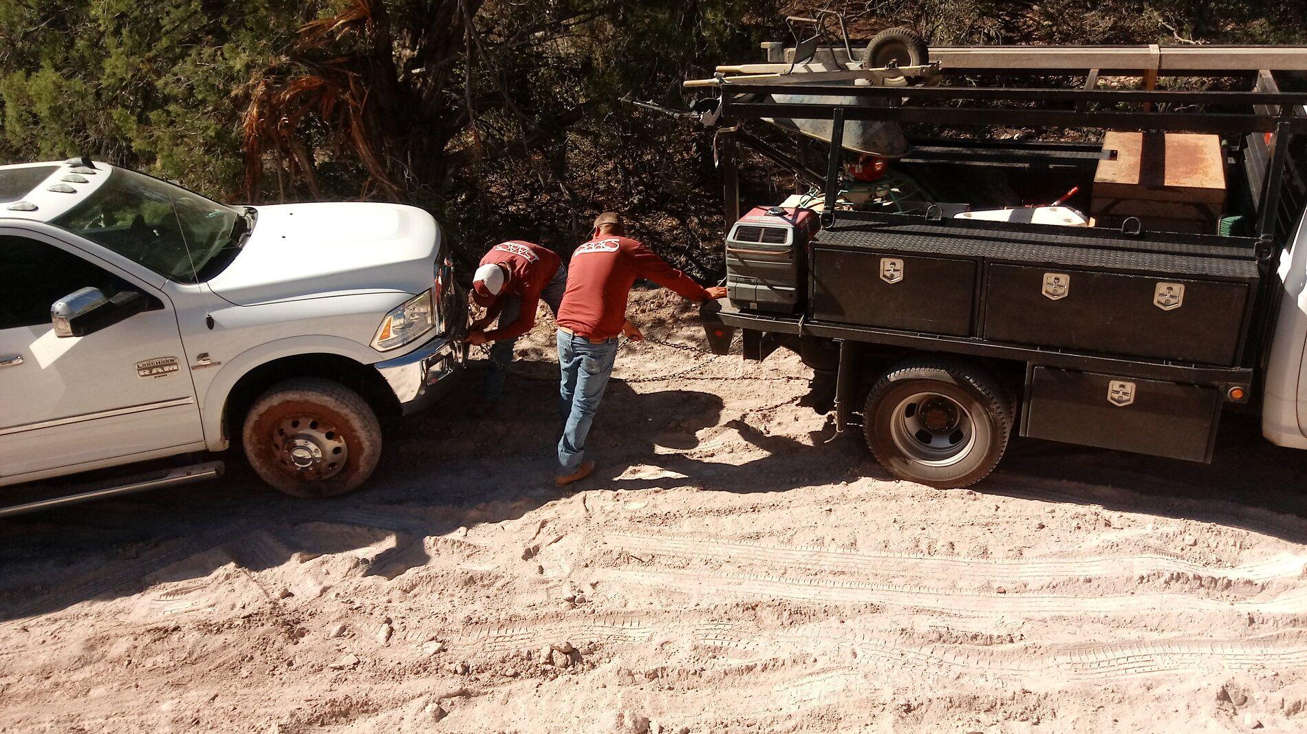

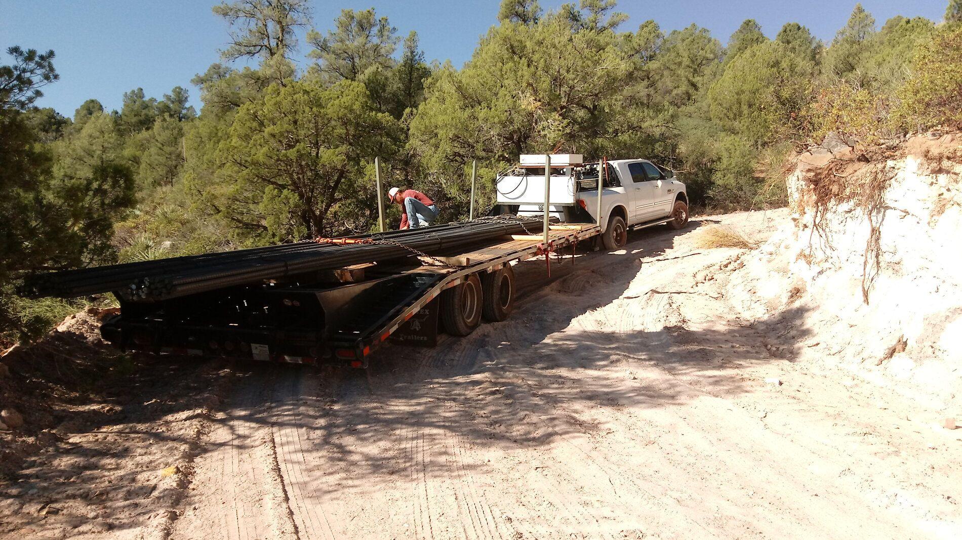

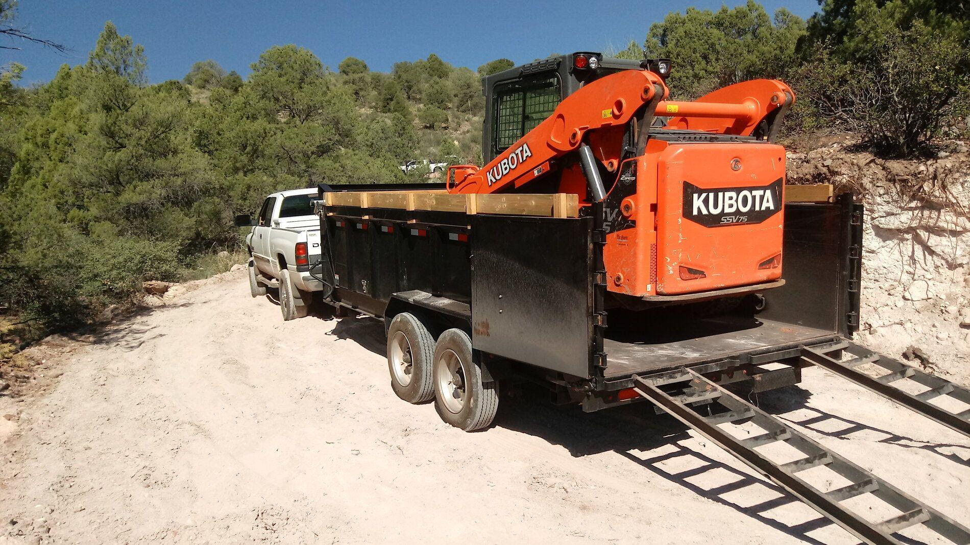

That truck should run off and hide with that load, on highway or off. This is what these trucks and t-case are capable of. First picture is a '16 Ram 3500, 30+k GCW, spun out in 4x4, second picture is '01 Dodge/Ram 2500, 23k+GCW spun out on the same hill. We made several trips on this road. Third picture, Ram tows Ram.

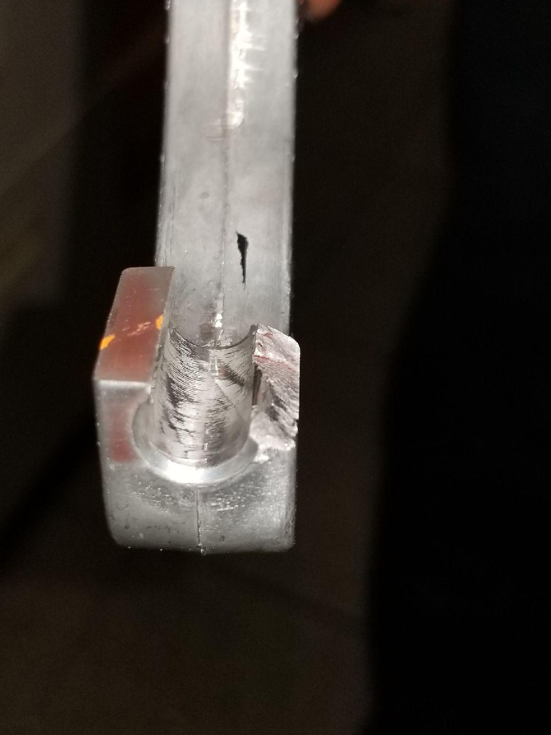

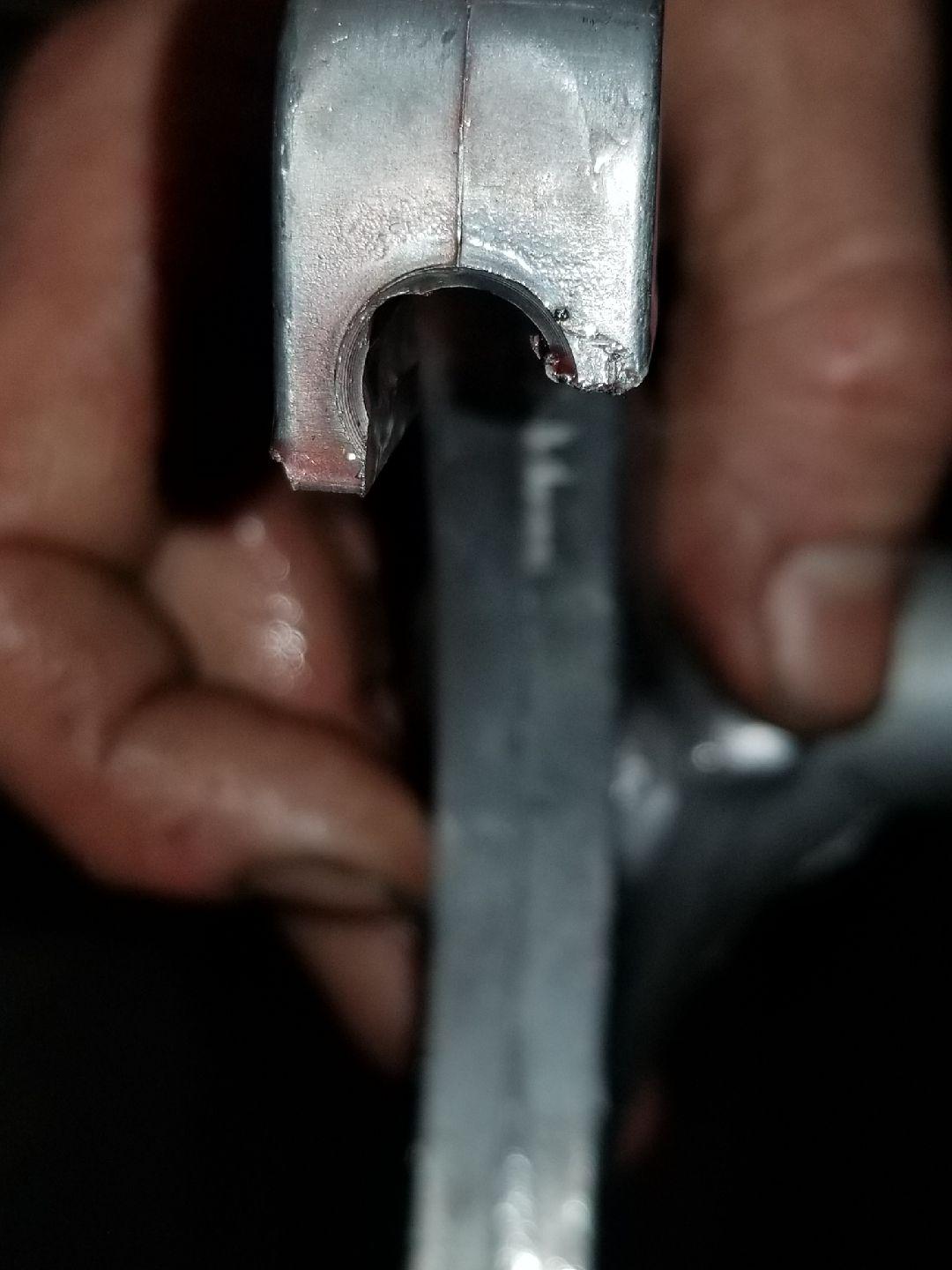

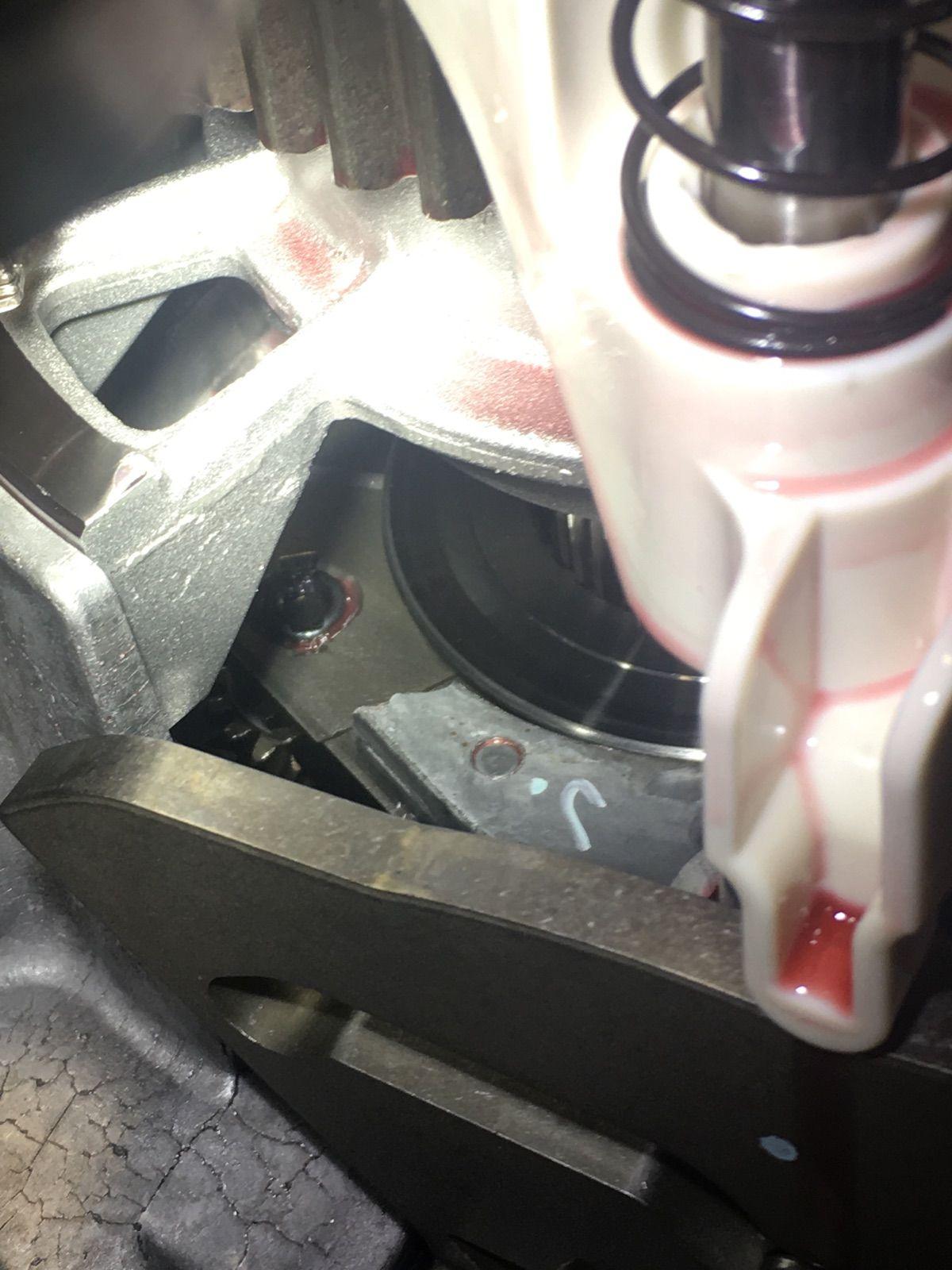

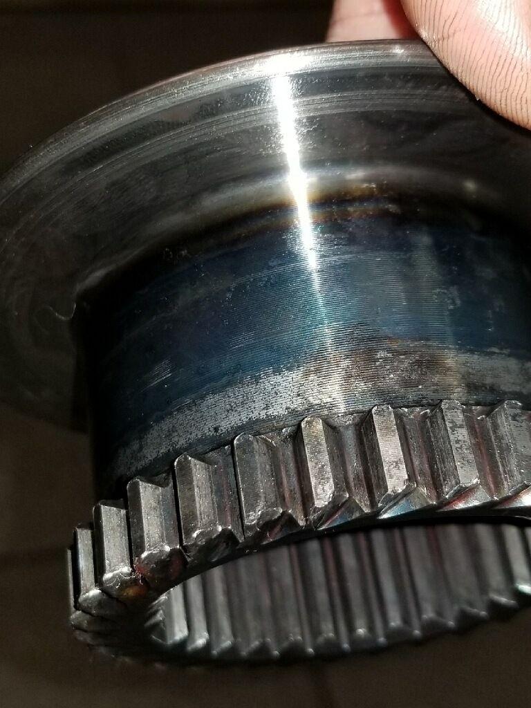

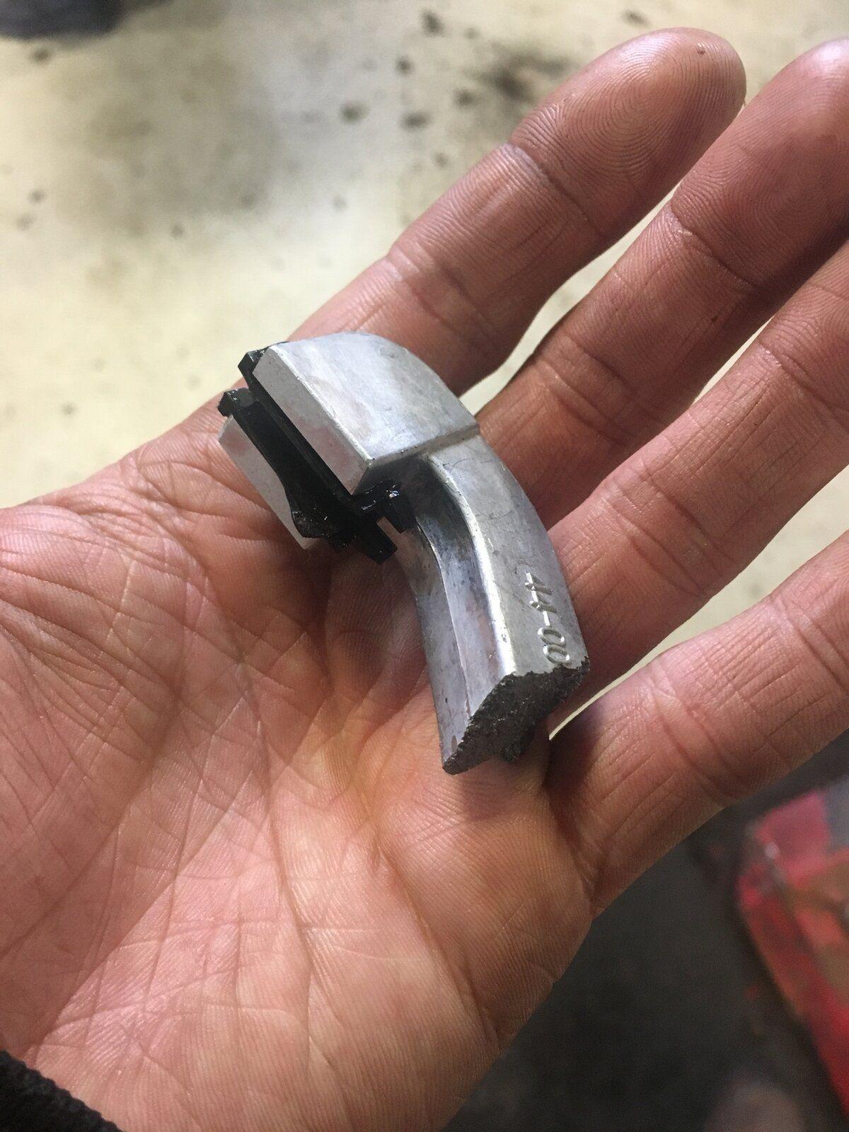

Those pics show me that the unit was not fully engaged into gear. the only way you can have that much force to brake and bend the shift fork is the gear is not fully in. It's riding on the incline that helps align the gears so they can slip into each other. If the unit was fully engaged there would be NO force on the shift fork. You could remove it all together. All the torque would be transmitted through the gear. The gears did not fail. That said something did not allow or was causing the shift fork pull the gears part. Was the linkage adjusted wrong? did the case fail/ stretch not allowing full engagement? I can't answer that. I don't see the case failing there are too many out in the field that have not failed. I can see the linkage being miss adjusted and or something is allowing the engine or the cab to move under load and that could pull the unit out of gear. Years ago I blew my TC on my ford ranger. The shift fork had worn out and wasn't allowing it to get fully into gear. I finally slipped while trying to back up a hill. It never slipped going forward. That said someone is missing something very big in this truck for 2 TC units to fail the exact same way.
I agree with your assessment. I've maintained this was a suspected the problem from the start.
