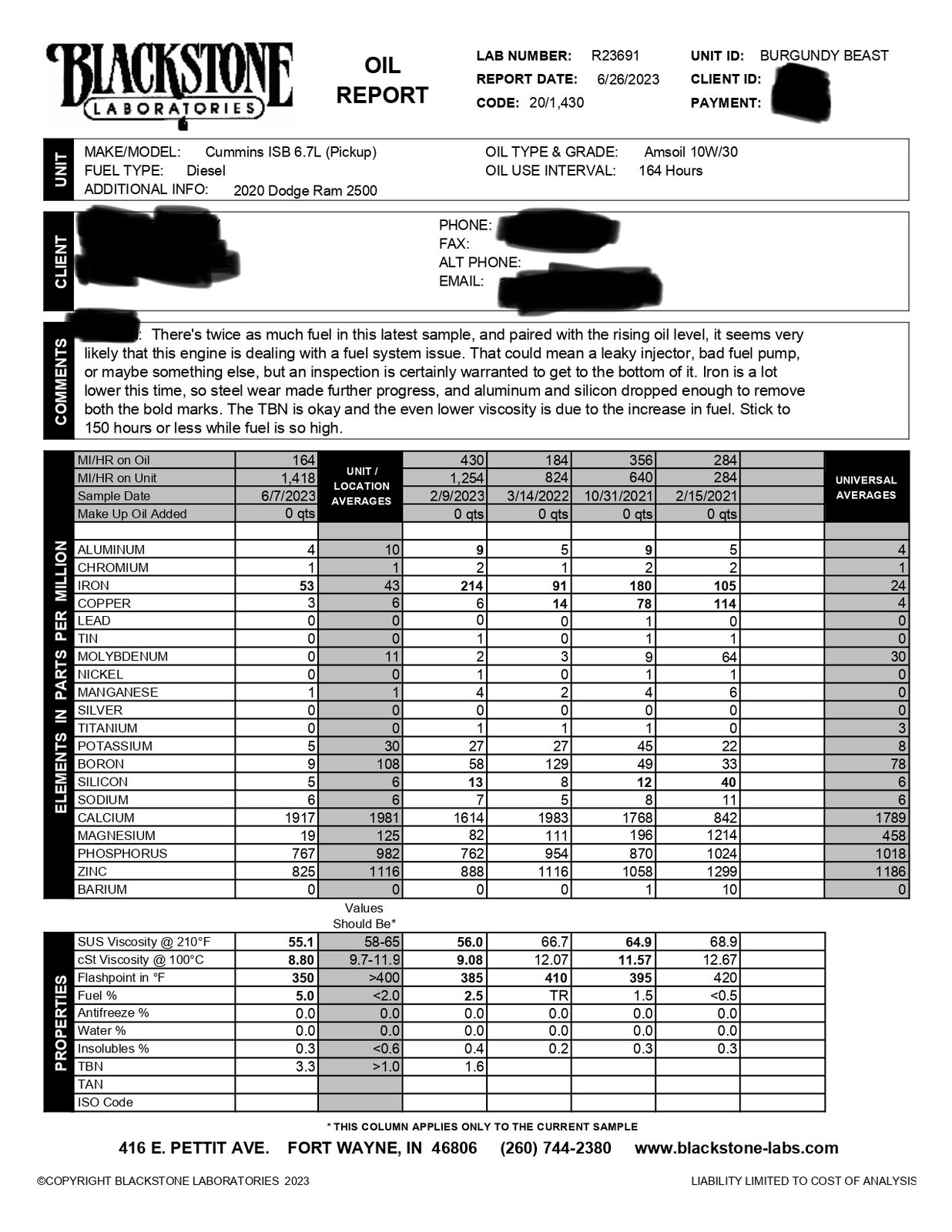

I Have a '20 2500 37,000 miles on it. I have been having an issue with the oil level constantly rising, I always get analysis done with every oil change. There has been an increasing trend of fuel dilution, with the most recent sample at 5%.
I have been to my local dealer's heavy truck center. The tech was less than helpful. Even though I gave them the oil report and pictures that I have been taking of the level on the stick he told me;

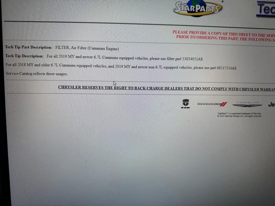

Is it a CAI setup or just a non MOPAR filter like WIX or other reputable manufacturer?
Go back to a stock air filter and you likely will decrease the frequency between regens, which will also decrease the fuel in the oil.
For the 19+ trucks be sure to use the 53034051AB filter.
There is a newer filter that ends in AA that shouldn’t be used on the 19+ 6.7’s per Ram.
Lots of reports of increased regen frequency with filters that aren’t the AB filter.

The thing I’m having a problem understanding, is it hasn’t done this since new, it has only started in the last year, and it appears to be filling faster. Here is the recent oil report.
I just sent away another sample today so those results should be in about 2 weeks. It rose 3 quarts over 1,022 miles in 33hrs of run time. That just doesn’t seem right.

Go back to stock with the AB filter I listed above. You cannot get a better CAI than the stock setup. It will likely fix your regen issue.

If it rose three quarts in 1k miles the dilution would be closer to 20%, not 5%. Frequent regens were a big contributing factor with the 2007-2012 trucks. I would still swap out the filter setup for the stock. You are gaining nothing using an aftermarket CAI and filter.

The 19+ trucks are much more sensitive to air filters, so much so that they can’t run the new “improved” OEM filter that was released for the 6.7 and they need to keep running the AB filter.
The oil change and 5K interval is a perfect thing to do and let the dealership confirm your statements.
Are you saying we should/can not use the 68517554 AA air filters? If that is correct, I have had one sitting on the shelf with no way to return do to how long I've had it...
In 19+ Cummins trucks that is correct. They are still fine for pre-19 6.7 Cummins.
