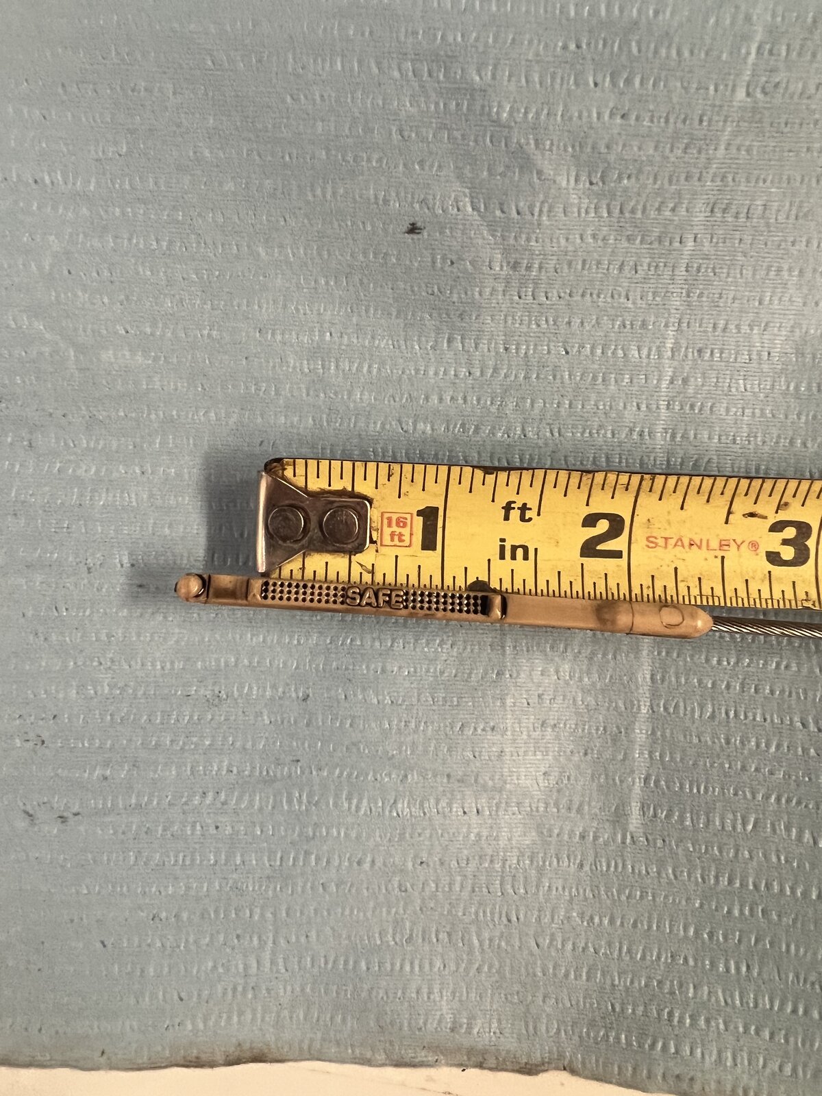

12 quarts on the 2022 should have you right at the upper mark, not above it by 1.25”. This is the dipstick used, and add to full is 1.25” or 2 quarts. What you’re stating is that 10 quarts gets you to full, so something is wrong with how you’re checking or changing your oil since 10 quarts will only get you to the add line if properly changed/checked.

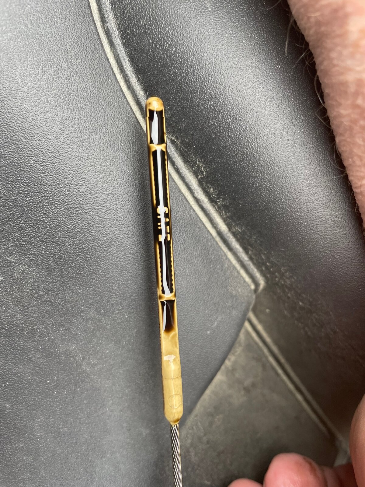

I have been ridiculed for this by some but this is what "I" do.
Drain overnight in my shop with a level floor. Fill with 11 2/3 quarts. Next time I drive it I pull into my shop and let it set overnight and check. Guess what, it's right on the full line pictured above.

With the overnight sit the filter is probably only 2/3 full. With the claimed 1 quart capacity on the filter there is your extra 1/3 of a quart, making it a full 12 quarts to the full line with a full filter.
You won’t have any issue with the 11 2/3 quarts, but folks also won’t have any issue being slightly above the full mark after an overnight sit. 1/3 quart is right at 1/5” on the dipstick.
Temp also comes into play. 85° oil sits just above the full mark (1 3/8” on the above photo when I checked today) and 30° oil sits just below it, same level and same location being checked. The 55°F shift accounts for 3% change in oil volume, which works out to a hair over 1/3 of a quart or 1/5” on the dipstick.

3 gallons only overfills it by 2 quarts with improper draining, it’s really that simple. If your photo is of an accurate check of the truck sitting level and overnight the truck has 12 quarts in it when you account for filter drain back. Your Cummins isn’t any different than anyone else’s, so it’s a procedural problem if 10 quarts got it to that level. If it was properly changed then 10 quarts would get it just above the add line with overnight filter drain back.

2 quarts overfilled is 1.25” above the full mark, which is above the plastic end. Your oil was that high?
