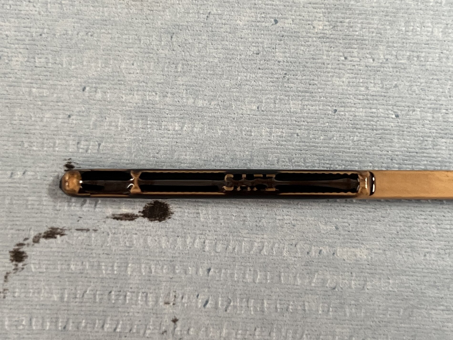

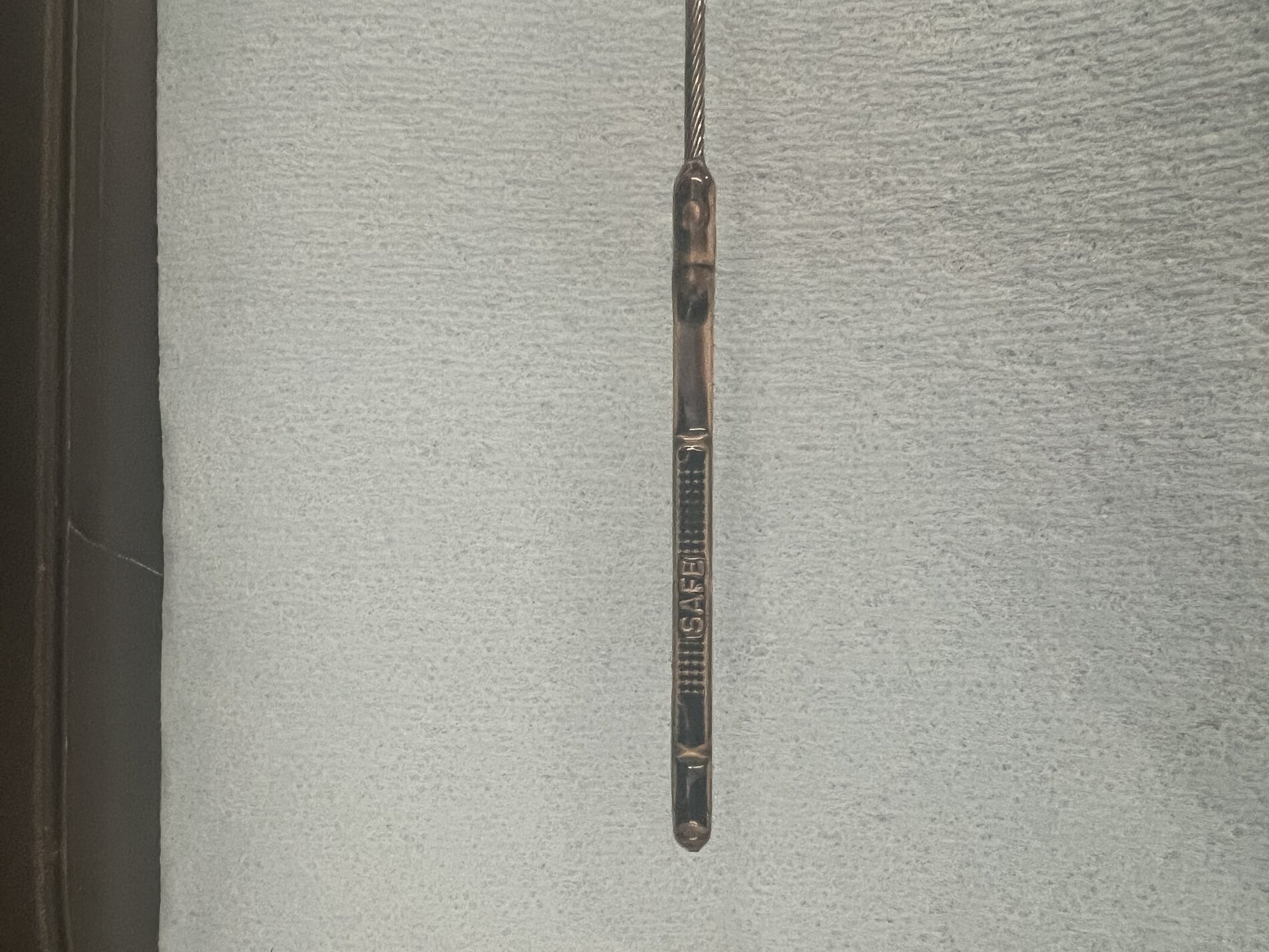

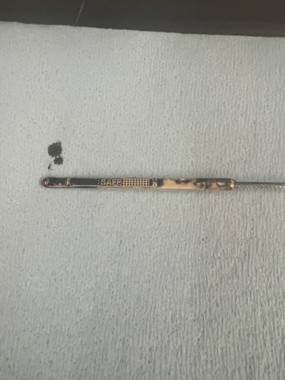

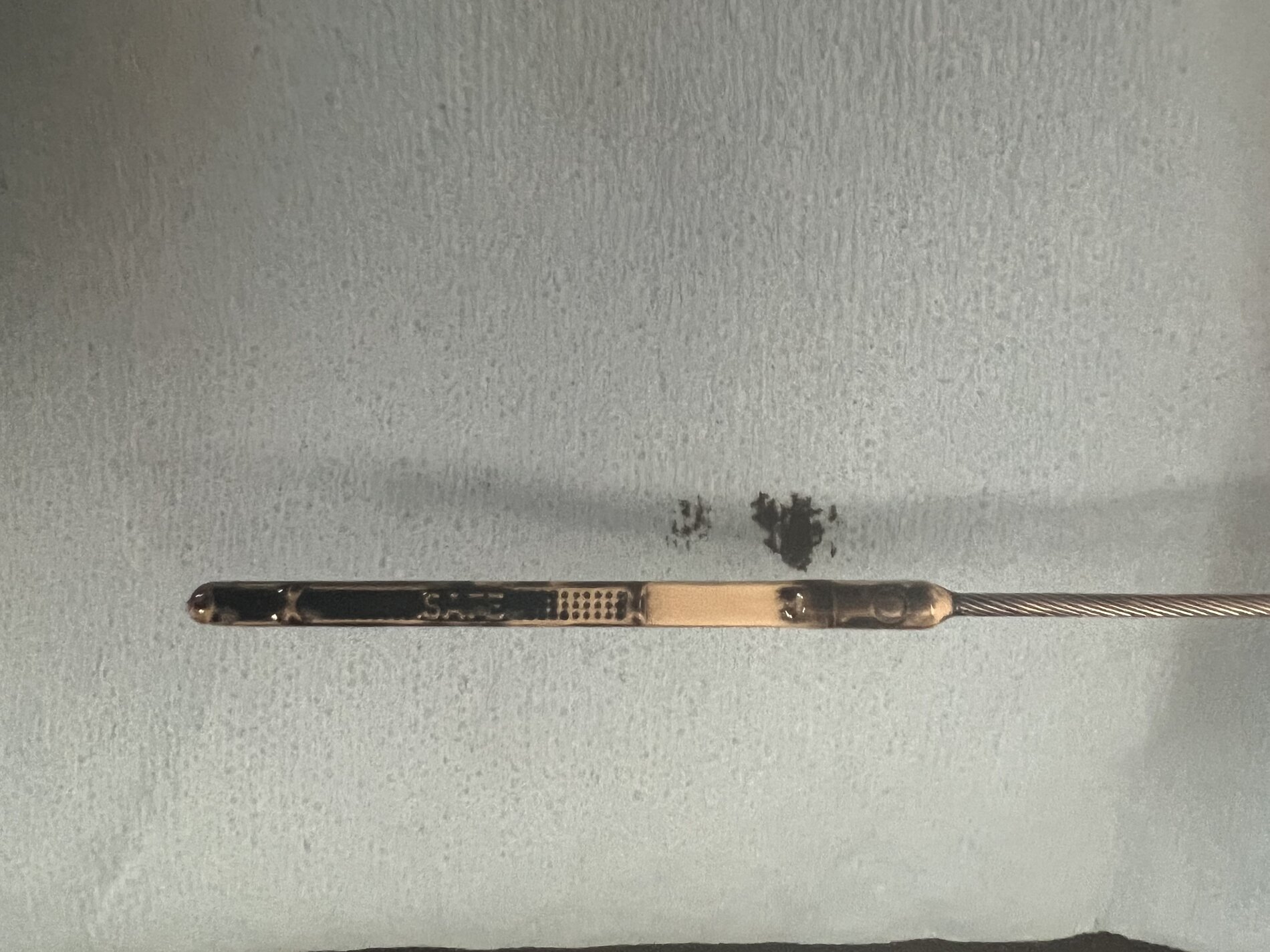

Alright, here is what I have found. There is a difference in level from 5 minutes, 30 minutes, 4 hours, and overnight. The difference isn’t huge, unless you use the shorter intervals to fill the pan to the full mark. 30 minutes and 4 hours are nearly identical with the contraction from cooling being absorbed by additional draining.
As noted above I had to clean and recheck after 5 and 30 minutes. At 4 hours the level was discernible, but not as clear as the overnight sit.
5 minutes. Approx 1 1/4 quart lower than sitting overnight.
30 minutes. Approx 1/2 quart lower than sitting overnight.
4 hours. Approx 1/3 quart lower than sitting overnight.
Overnight.
Bottom line is that they are all in the safe zone, but I wouldn’t add oil based on anything outside of overnight unless it was below the add line and then I would only add what was needed to get it to between add and S in safe.

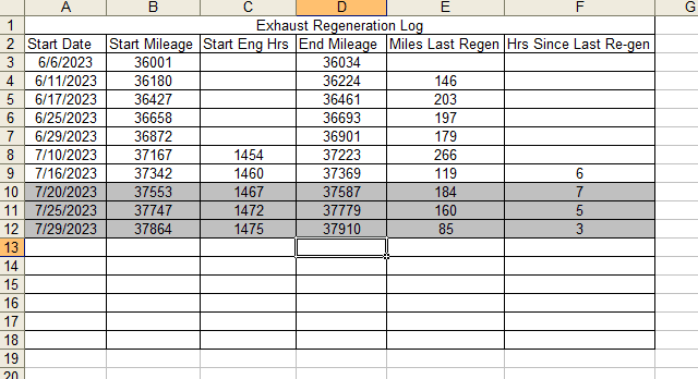

An update regarding the regen frequency after having reinstalled the factory air box and filter...NO CHANGE still going into regen just as often as when the cai was installed. I have been tracking the regens, (see pic) what is highlighted in grey is after the oem air box was put back on. So I don't think the cai was causing my issues. Also the oil level is up about 1/2" since the dealer changed the oil on July 6th at 37,082

It's apparent he does his oil change in a consistent manner. It's also apparent that he has fuel dilution and frequent regens. At this point I would troubleshoot for a P2459 regens too frequent. That involves ensuring the charge air side is leak free and the EGR system is operating as designed and is clean. He has enough data since re-installing the OEM CAI to drag the dealer back into the process of finding what the problem is. Unfortunately, there are many folks having frequent regens with no quick resolution in sight. Many have found leaks in the charge air system so that would be a place to start. There is a flexible coupler below and in front of the turbo that has a wire loom running near it that can rub on the coupler. Some have found that coupler with a hole worn in it. Mine was rubbing but not through. Others have found clamps loose on the hoses going to the intercooler(charge air cooler). Good places to start.

I have personally gone over all of the charge air system and checked for loose clamps or leaks and found nothing out of place. I have done everything I can without having access to a wiTech or other scan tool. Otherwise I would have done injector kill tests and leak-down tests to check for and rule out an injection problem.
