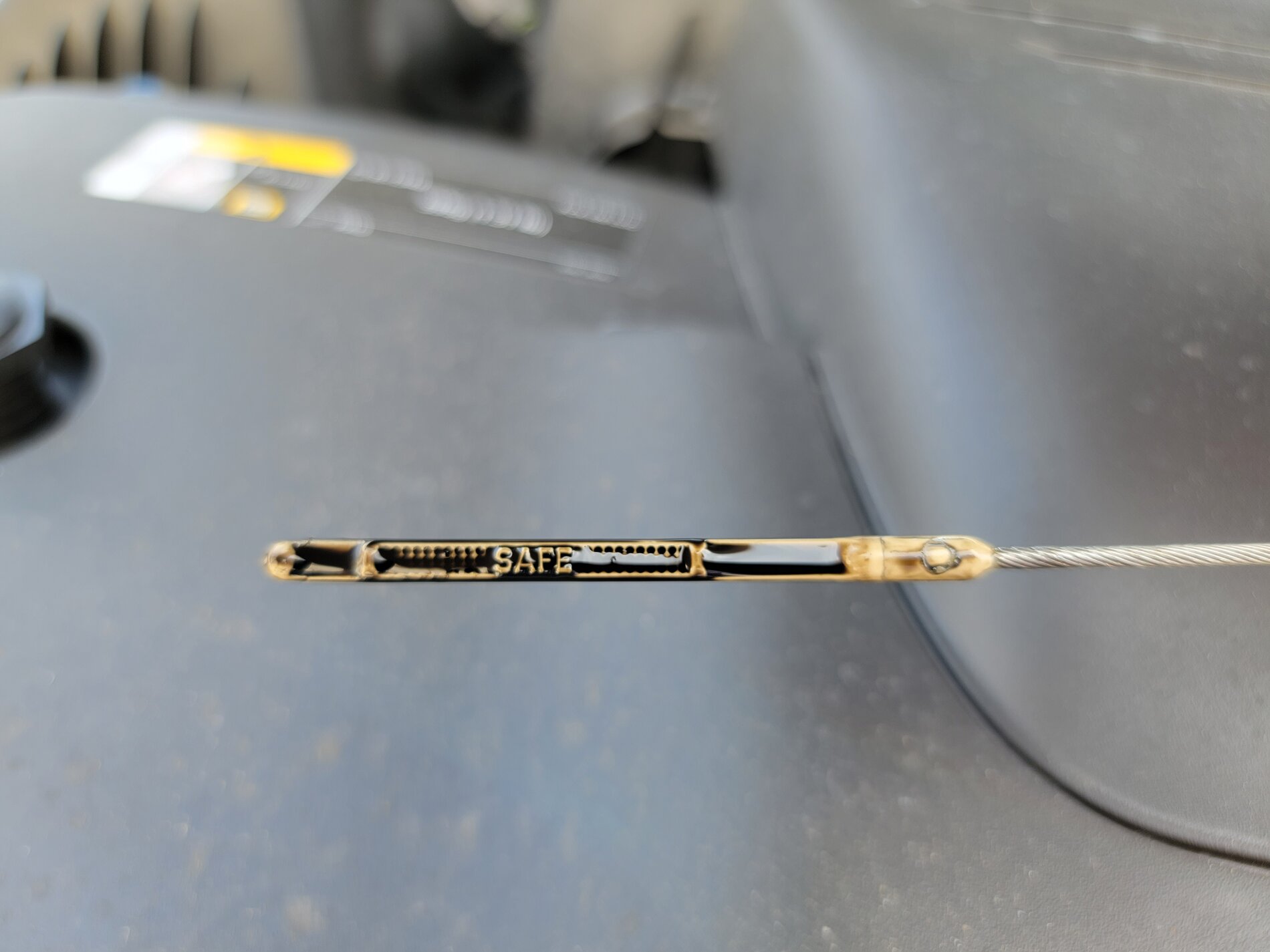

My '22 is out of the "Safe" area. It's above, but from what I read and what is here its allowed and within the limits. Call it 9k miles on the truck.
How high is too high? Is out of the "safe" really "not safe", if they thought they needed to add a level "not safe" since it's allowed to make oil, why don't they do that? I'm sure it's OK to be where I'm at and there is no harm to anything, but who knows.

This was drive 20 miles shut it off 4hr ago.
Tried it twice same results, no immediate plans of lowering this level at this time.

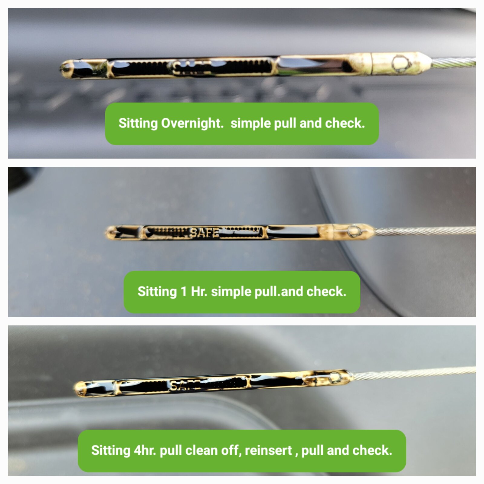

Another question, how many times are you pulling your dipstick?

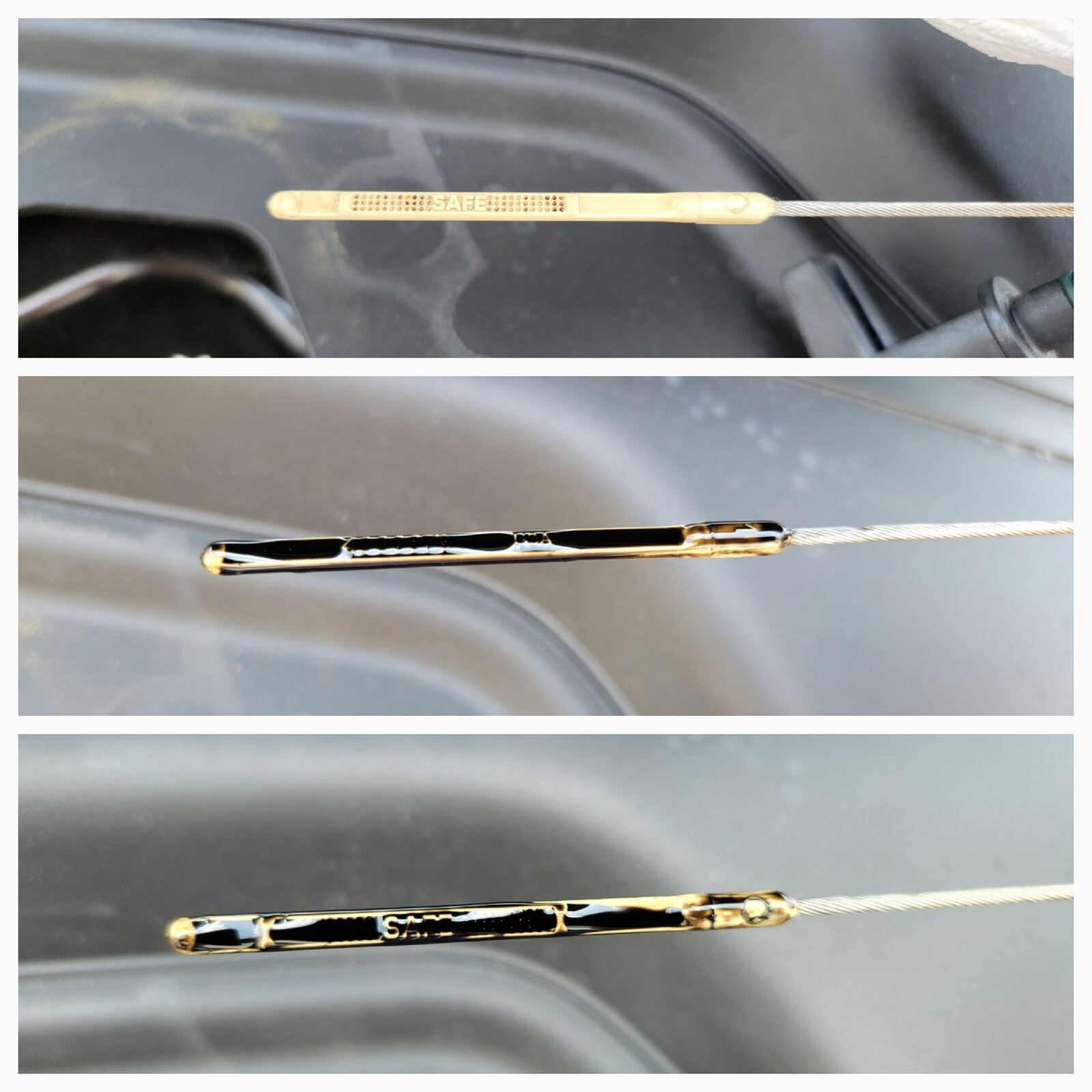

If it's been siting over night, pull it and look at it, that's where it is. If you pull it, wipe it off, stick it back in, and pull it again, you've pulled oil into the tube and that will skew your results.
That's on me then.
Here is after an hour of sitting since the last pic.
Will try tomorrow AM.
That wasn't aimed at you, just in general. :cool:
It made a distinct difference with just an hour of sitting in my case. Still above the safe. But I really don't think anything what so ever is wrong with my truck or have any worries where I have found it.
It's a great point. Go back to basics for sure at times, pictures don't lie on this for my exact truck.
It's good to have a process and stick to that when doing this chase the tail deals.

So this is a '22, 9181 miles, factory/dealer fill, no changes by me along the way.
I don't see much change from the 1hr sit and check vs the overnight check. (Why 1hr, no reason thats when I read the post saying "your doing it wrong!") I bet the 30 minute wait would be similar.
The simple wait, pull and check for me is really the way to go.
The bottom pic is all the stuff from the tube as Big Papa clued me into, stop doing that.

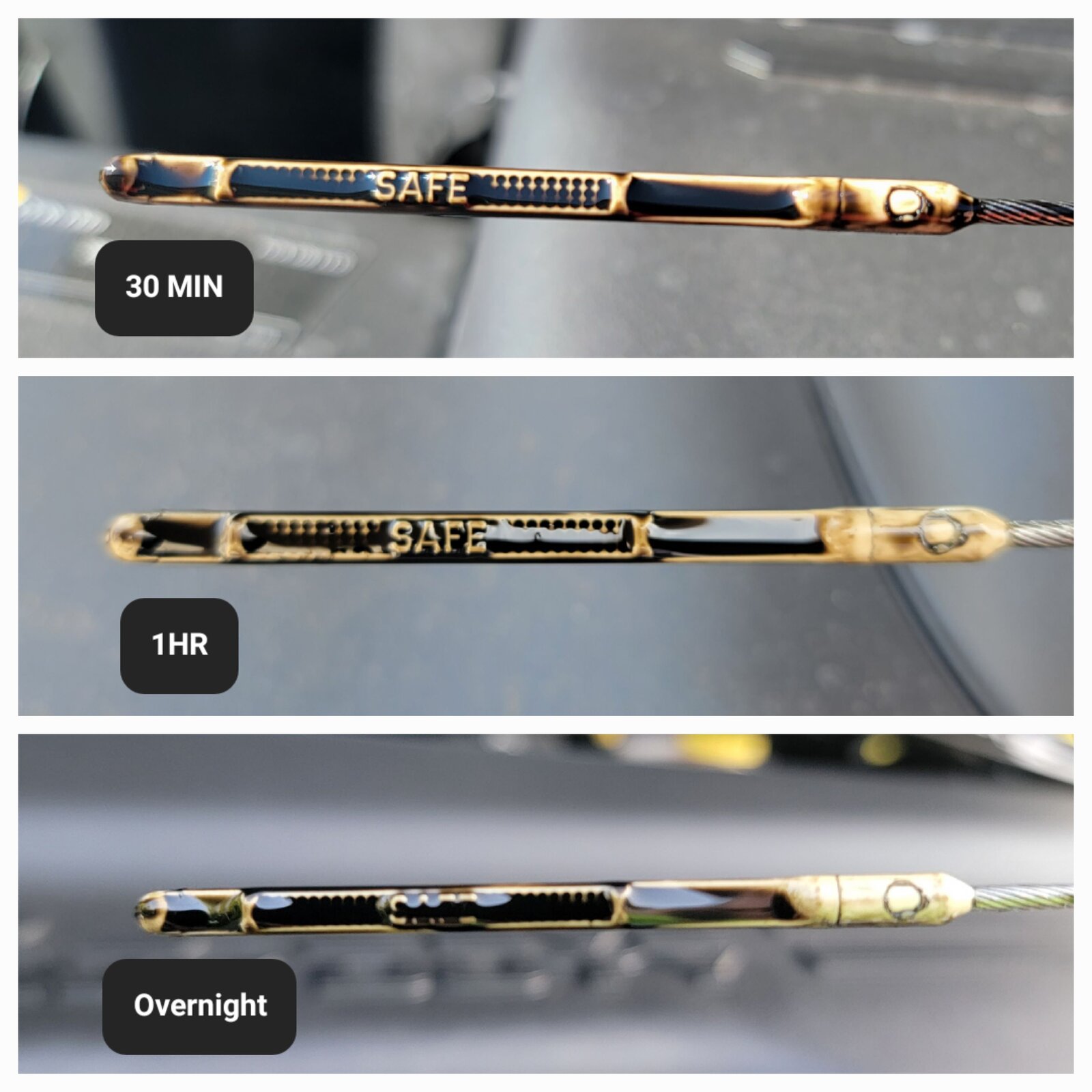

Really just wanted to show folks who might be seeing an increase in oil how another newer truck is measuring at different wait times after shutdown. All pretty much the same IMO level wise.
Here is the final from me on the checking the oil level 30min, 1hr, overnight, each was after an individual decent drive cycle then just pull and check.
