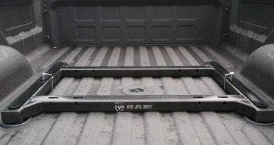

"Picture Frame" Mounting Bracket for the Ram 2500,3500 Fifth Wheel Hitch
Mopar 5th Wheel Adapter Kit will allow you to hook any Industry standard rail mounted hitch to your truck.
https://moparonlineparts.com/25003500-fifth-wheel-hitch-p-4313.html
https://moparonlineparts.com/docs/82213667.pdf

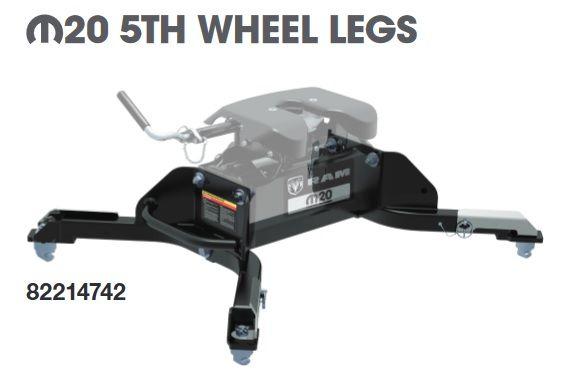

2 parts in a combo of: 82213822 20K Hitch and 82214742 Direct mount fifth wheel hitch legs.
20,000 lb towing capacity direct mount fifth wheel hitch legs.
82214742
https://moparonlineparts.com/25003500-fifth-wheel-hitch-p-6779.html
https://moparonlineparts.com/docs/82214743.pdf
82214742
