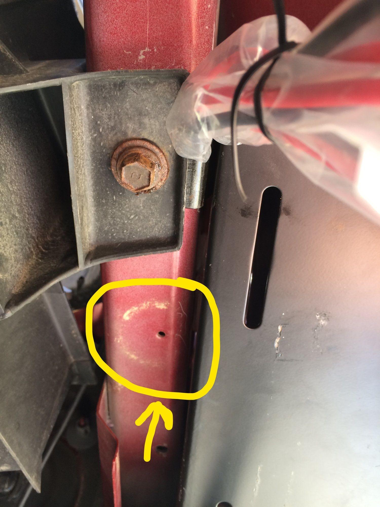

If you look directly up above the front tire at the left hand inner fender that screw / washer combo goes into this hole.

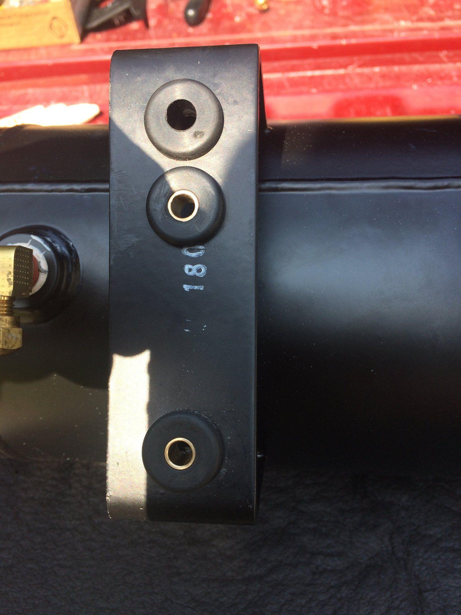

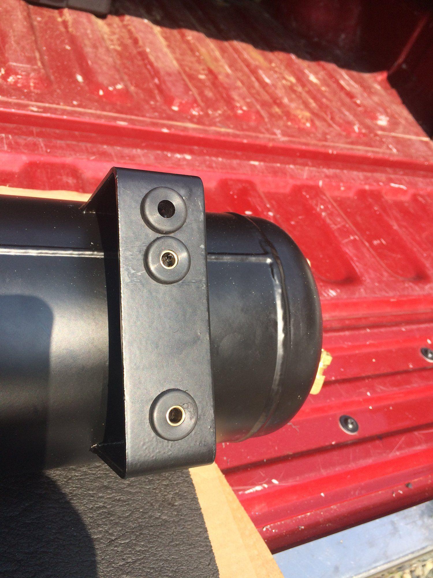

Air Tank Prep.......holes in the tank brackets were too close to the lower edge of the frame so had to drill two new ones. 1/2" holes, no big deal. They sent extra grommets with the tank mounting kit so used them in all six holes....

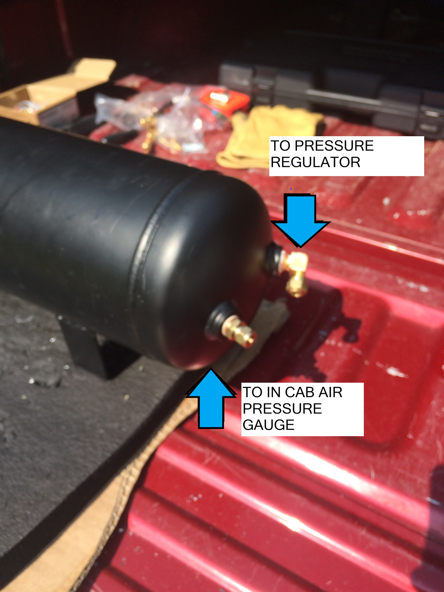

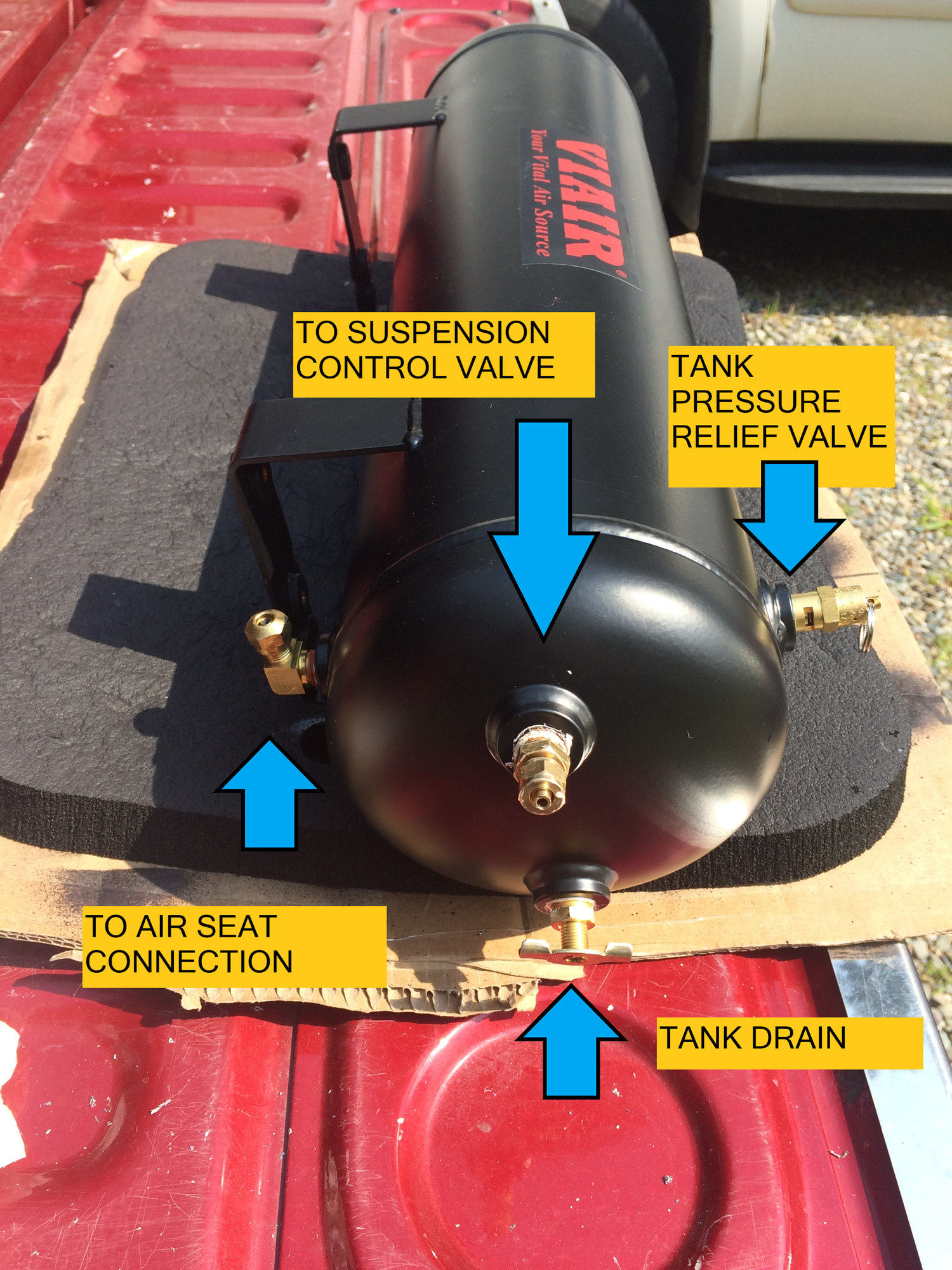

Fittings in, changed the one on the end to a 90 degree after picture was taken....
Not to intervene on your project Mike. I used 2 1 1/2" pieces of angle iron bent in a L shape painted with Eastwood's rust preventative paint attached with bolts to the frame. Then mounted the tank with the feet down and the drain down to hopefully make sure I would get all of the moisture/water that accumulates out of the tank.
Dave
Dave
Thought about doing that, if I see a lot of moisture when I drain the tank I will have to redo it.
