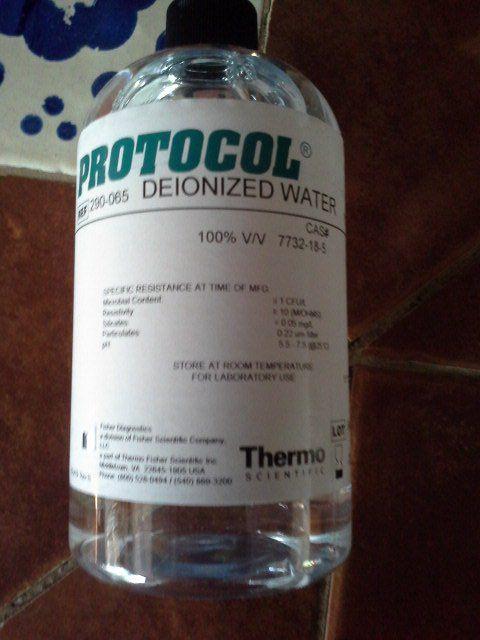

If you don't tow alot and def sits in your tank for a while, the injectors might clog.
I add one of these every 4 to 6 months to prevent clogging
Aren't you concerned that adding additional water to the tank will dilute the mixture and drop it below the 32.5% Urea concentration ?
According to Bob4x4, weak DEF will not hurt your def system. I use reagent grade DI because it is likely as clean or cleaner than the DI used in the DEF. I haven't had a problem yet. If the system detects weak def, it is supposed to trigger more DEF spray. Warmer climates call for occasional DI to be added (my opinion). Cooler climates don't need DI added.
