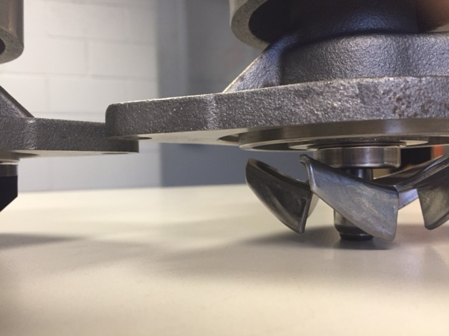

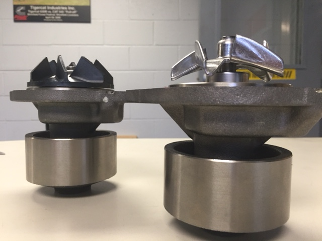

Ok, here's what we have so far......I want to stress this is for discussion purposes only at this point...Under no circumstances am I condoning or suggesting replacing the plastic impeller version with the steel version so far....
We are comparing the 2881804 (07.5-12) water pump with the plastic impeller to the 2881805 (99-07.5) water pump with the steel impeller.
The water pump housings share the same identical part number so weep hole and mounting are a match between the two.
The pulleys have different part numbers but share the same diameter. I believe the shafts are different sizes between the two which would result in a different pulley for each.
2881804 is on the left, 2881805 on the right.
Note that the 2881805 has a slightly longer shaft on the impeller side SO is there room in the 6.7 water pump cavity for this????
Again, 2881804 to the left, 2881805 to the right.....

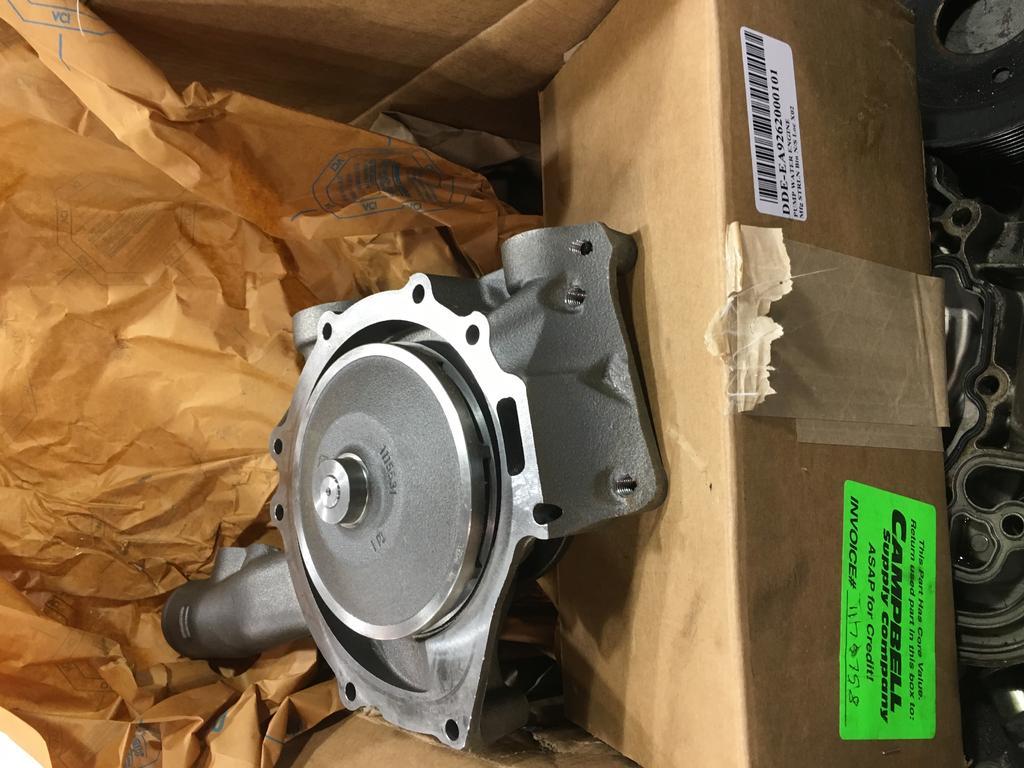

Well this STINKS. It's definetly a trend. For the last 5+ years the Mack MP7 (Volvo) waterpump impeller was plastic. And they're known to spin off the shaft.*:mad:
Mike, I know it's a nutty request, but can you check other engines pumps as you come across them?*
Yes I will. I recall seeing a plastic impeller on a Detroit water pump, DD15 maybe??? I'll ask the guys to let me know as they run across them....
That's an "EA" prefix which means that is a new part with a core charge on it. I wonder if the "RA" (which would be a reman part) prefix is plastic...(or will be in the future)....
Cummins does the same thing, if part number ends in "NX" that's a brand new part with a core charge. If it ends in "RX" or with some injectors (PX) then they are rebuilt parts.
The OEM's do the new part with a core charge thing to get rebuildable cores into the system....
