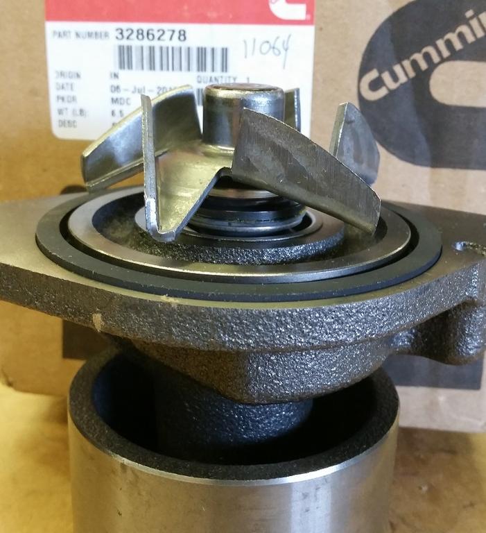

Thanks to everyone for chiming in on my pump question. Still, I have to make the decision on which pump to use today. I need to drop by the dealer for some antifreeze(I'm switching my truck from the orange to the green coolant, after a thorough flush) I am going to look at the OEM water pump they have and make my decision. If it has the impeller like the picture Mr. Wilson posted, then I'm going to put that one in. At $267, I'm hoping to get another 93K out of it. I guess I will save my original pump and the one I posted as my back up water pumps.

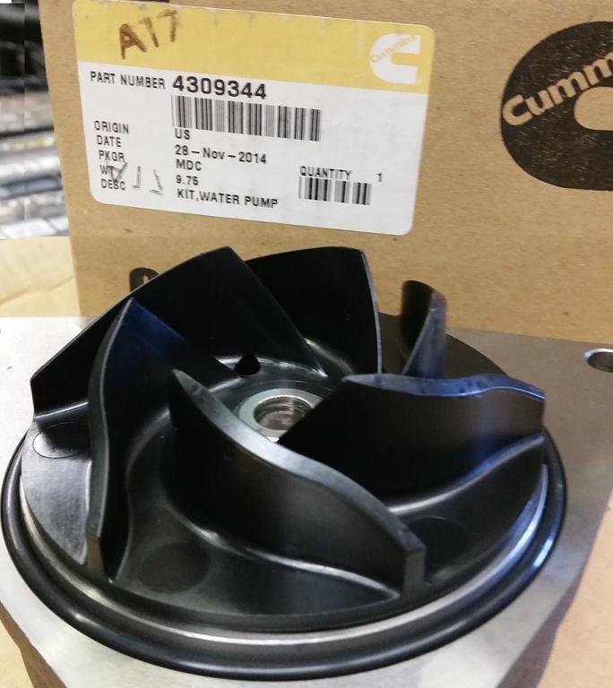

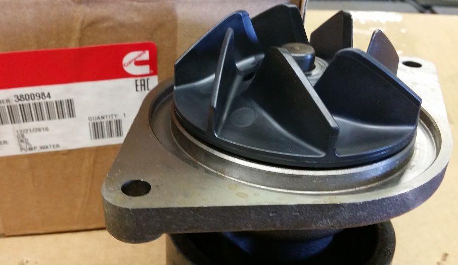

Here are the others I have. The 4309344 is not for a 5.9 but I wanted to show the composite impeller:

Had to refer to your very first post, took a minute for it all to come back to me....from that picture you posted of the new water pump I would say it is NOT a Cummins item. Aftermarket for sure.....

AND, I'm going to say the pump you received is most definitely NOT a Genuine Cummins part. As Mike asked, is it in a Cummins box and does the label look like the one in my pics?
Finally, I purchased a Genuine Cummins water pump, it came in a Cummins Box and has Concentric stamped into it. Pump has the composite impeller. I guess that's what we get from now on. Thanks for steering me straight on Cummins OEM pumps, for the price I paid , I was expecting maybe something made out of titanium or some other precious metal.:-laf Now, off to EBAY to report the company that deceived me with false advertising and won't return my emails or phone calls. Thanks again for the information.
