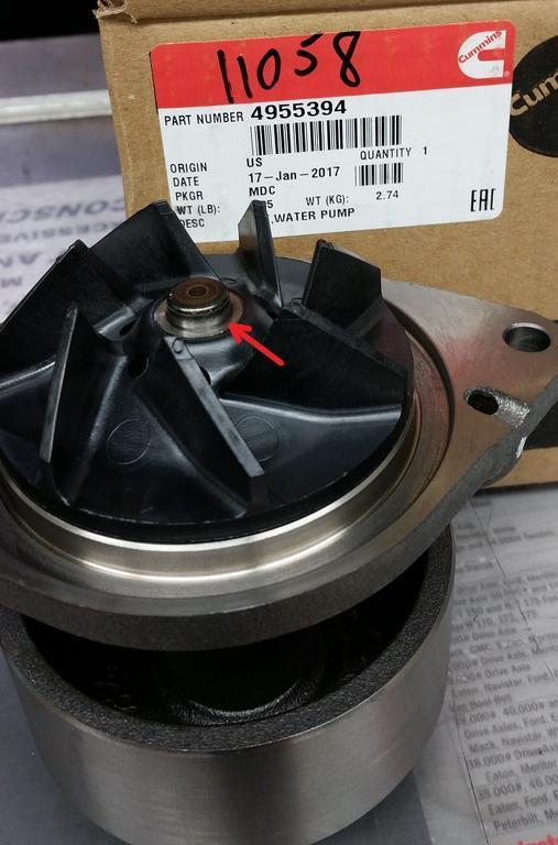

Well obviously whatever material the impeller is made of, it's subject to breaking the impeller during shipping. That's not acceptable! Still my question remains. Why does the pump impeller on my original post look different than most others I've seen? Is this their latest, greatest or a knock off Cummins OEM pump?? gsbrockman, I'm curious how many miles you got on your original pump. I'm still debating changing mine out with 93K on the clock, since I have to change coolant soon.
My theory... the pump's impeller design has changed to include the ring around the blades to add rigidity and strength to the plastic impeller in order to prevent prevent the impeller blades from breaking during shipping !!!*
Now you're thinking like an Engineer, have to keep the part intact during shipping, so that it can fail in the application and cause more damage! Engineering 101 on how to keep your job. Honestly as long as the flow rate is close to the same, I prefer to see the impeller fins with the ring helping hold them together. Thanks for the laugh
I agree Bob. Bob, would you recommend pulling the pump and checking it out while the coolant is out or could that possibly cause the seal to leak?? I think I'll keep the original in and hold on to the "new" for whenever it decides to fail.

As I mentioned before, my issue with the plastic impeller is that they tend to slip on the shaft. Whatever attaching method is inadequate in the application I see this happening on.*

Sorry guys, got busy at work and forgot about posting more pics. Here is a pic of one of the other WP's. Also, I finally got a reply from Concentric. I put an arrow on this pic to point out the insert he's talking about.
Dear Sir,
I have tried to check this and cannot track the part number, I assume it is a Concentric product.
We do not make an aluminium impeller for them but we do make composite. You should be able to tell by the presence of an insert.
Flow performance is likely to be the reason.
Best regards,
Paul Evans
