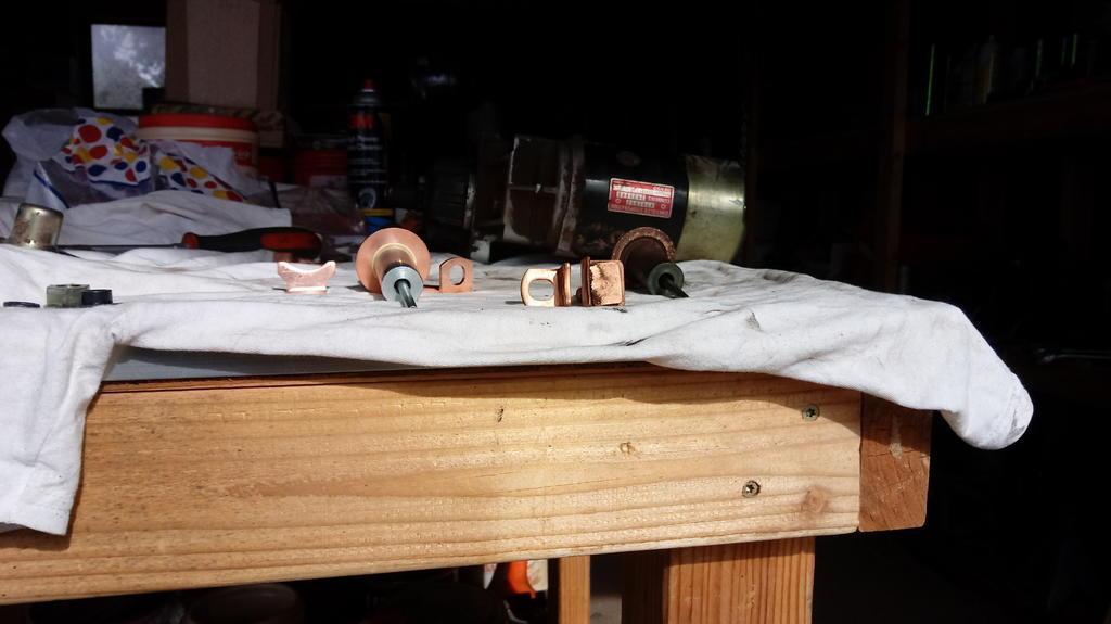

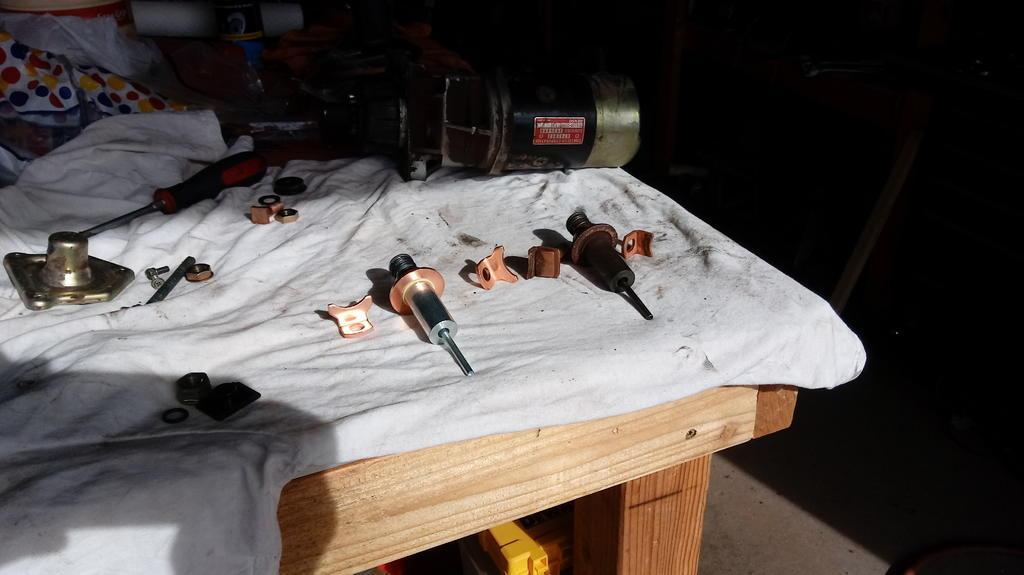

Time for starter contacts, so changed them today. Note the knife blade edge on the battery cable side, the starter motor side was fine as was the plunger disk. Used the HD Gould set from Geno's.
Nick

Michael, no, not really, it always worked good, just started to get the click, click at times. It has 316k, so it was due. The only issue I had was the rubber cover over the battery cable, it was rock hard so I had to break it off, the rest of the job was no problem. The bolts were a little tight but not really an issue.
Nick
Thanks Nick. I removed the starter about three years ago when I replaced a crank position sensor and at that time cleaned the contacts and inspected things. No issues with starter such as click - click, but at 19 years old and 253K miles now it would be good preventative maintenance.

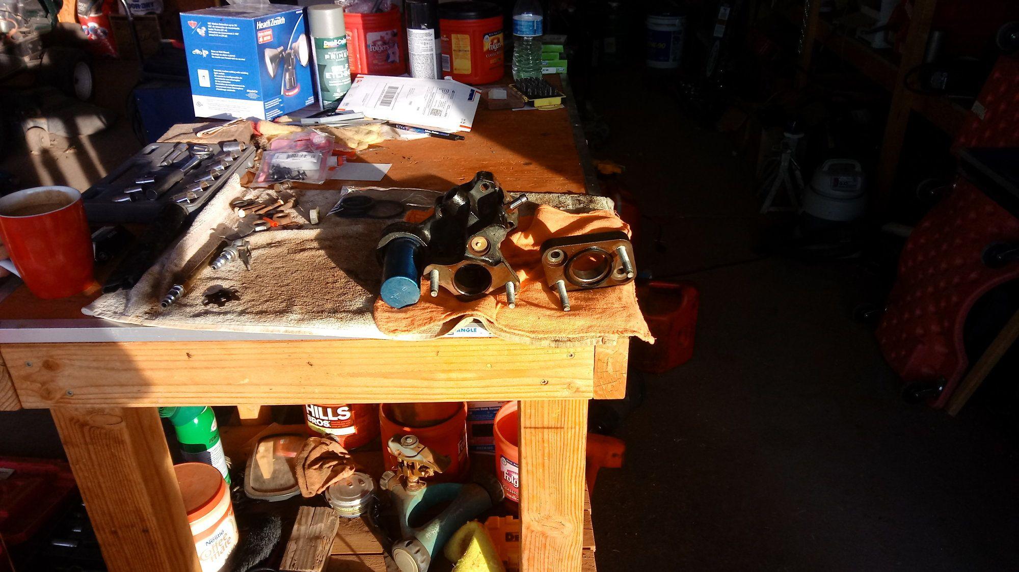

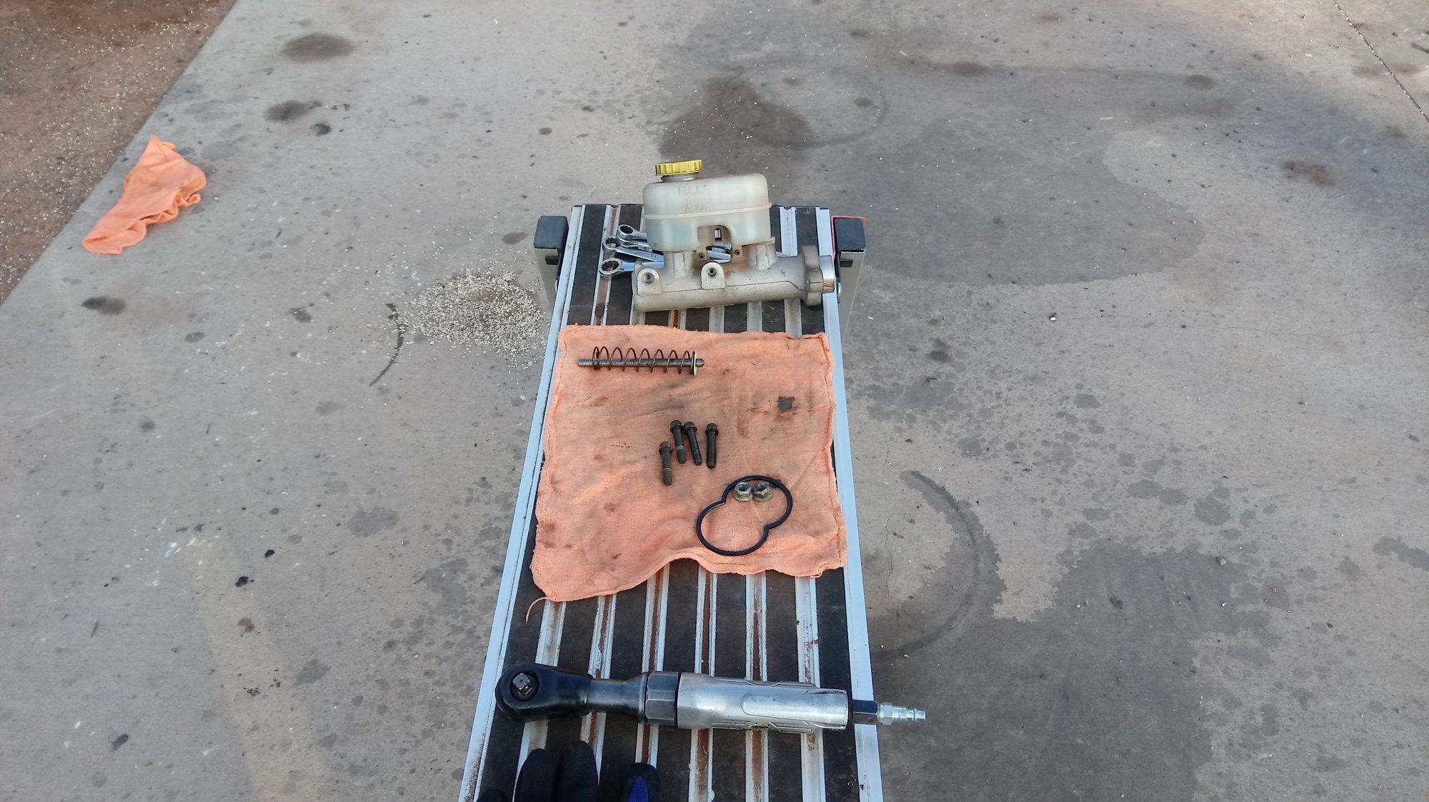

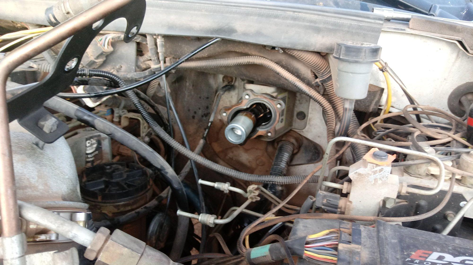

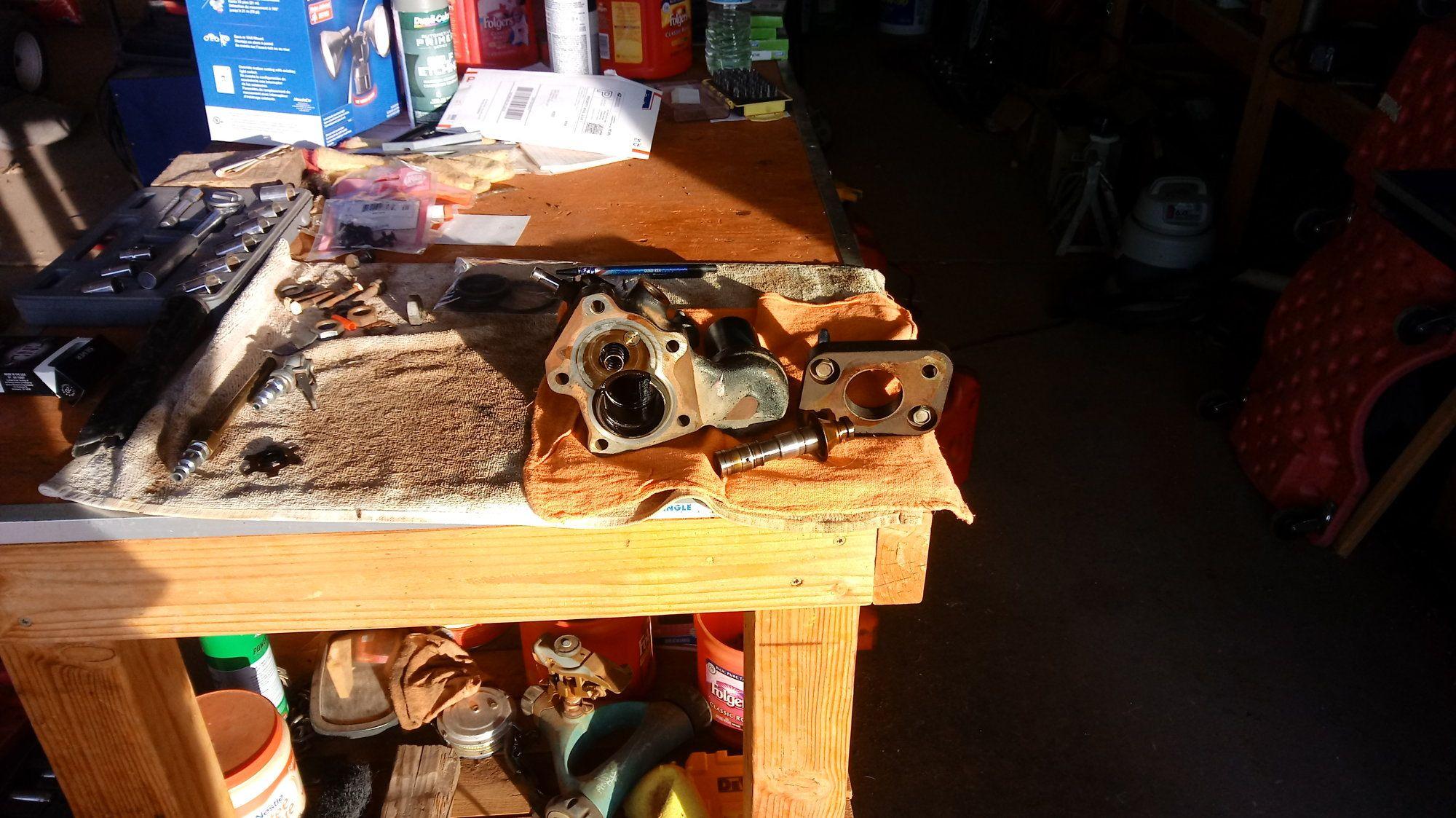

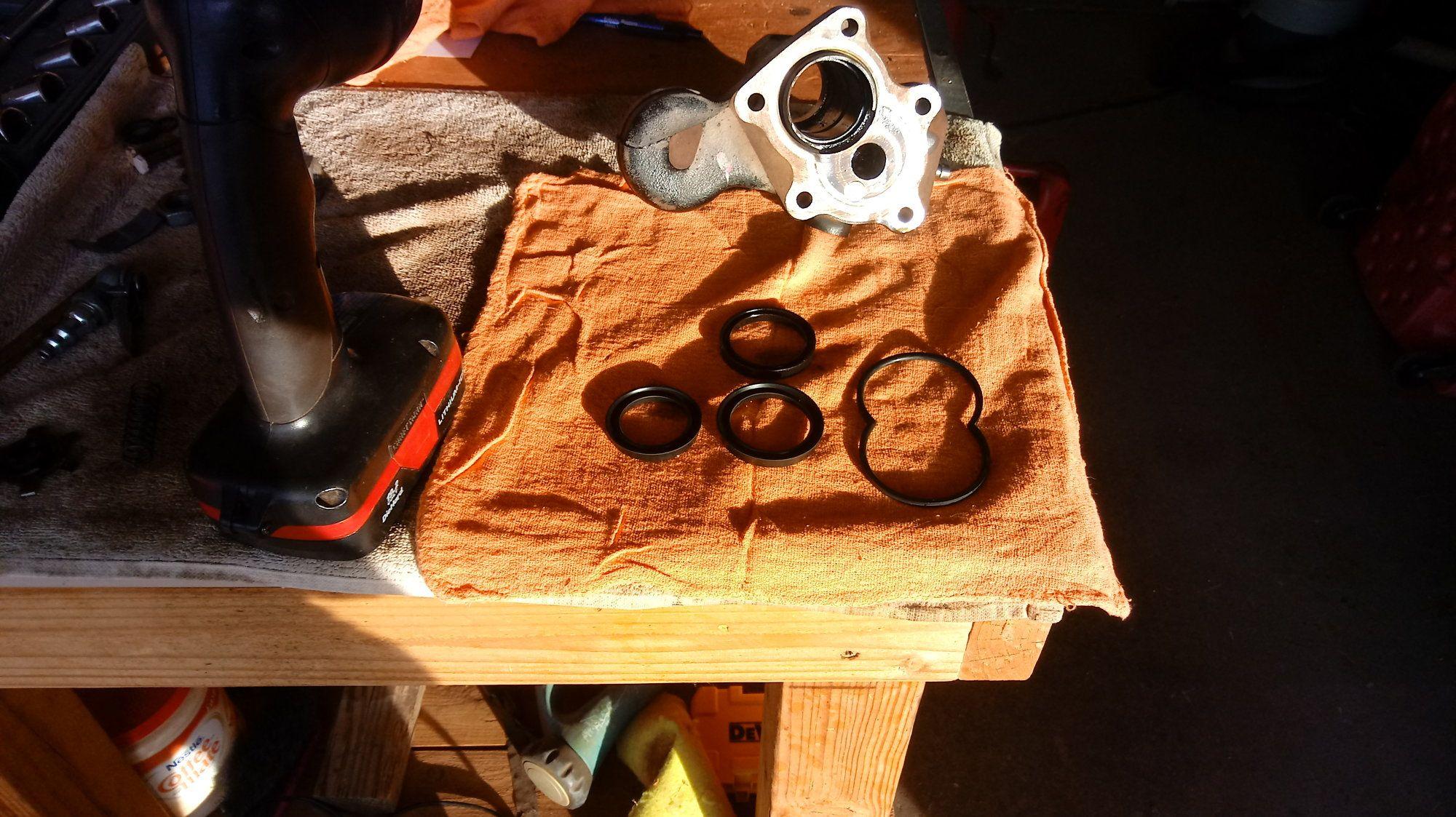

My hydro-boost started leaking this week so I ordered a seal for the piston and figure 8 o-ring seal for the case halves. The kit is universal with two piston seals, mine was the large one. You can also get a complete seal kit but I opted for just the piston seal. With all the research I did, it
appears to be very common. It will leak out a weep hole similar to a water pump. I did not have any seepage into the cab. I was completely intimidated but did it anyway, Lol I was not interested in a $200+ recon v/s $20 seal kit. It was genuine Bosch/Bendix. I also left the main case half attached to the cab and just separated them right on the truck. Not a bad job at all. I also rinsed and dumped the old brake fluid and filled with new. Some pictures.

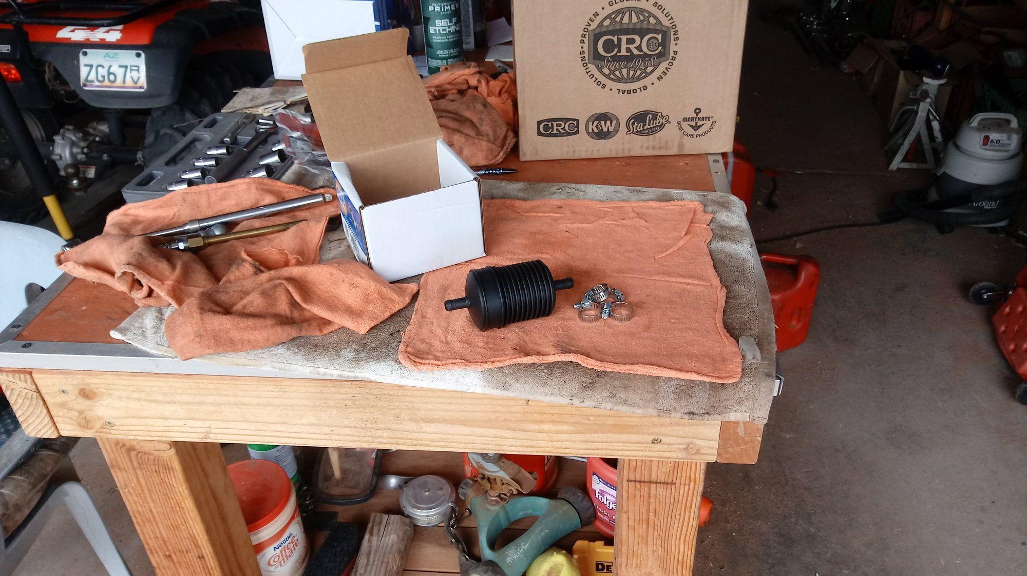

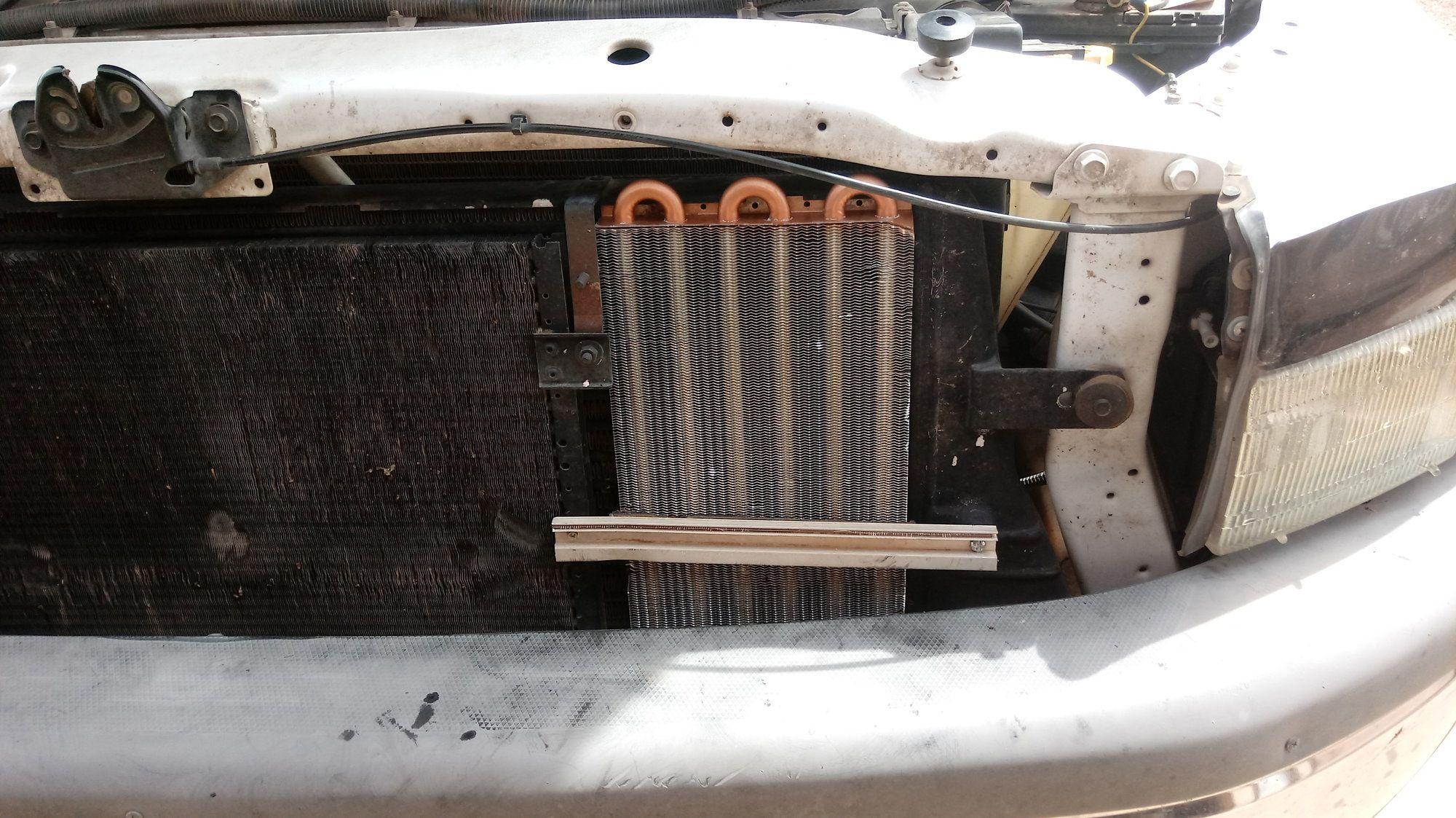

Just did an install of a power steering cooler, it is a little large but I had it new on the shelf. I bought it for my old Ford (auto transmission) and then bought a new Dodge instead, (1991) so it has been on the shelf a long time.
I also wanted to check return flow...on my truck, with the steering box return line pointed at my oil drain pan, I had my wife start the truck. The flow was massive and emptied the reservoir instantly. Granted, it only holds about a pint, but in about 2 seconds the fluid turned to foamy air. If I remember right, when I would change the fluid it only required a little less than a quart. The system now holds 1.250 quarts, a good thing. Here are a couple of pictures.
