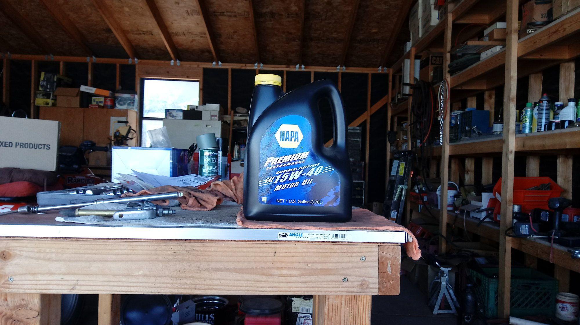

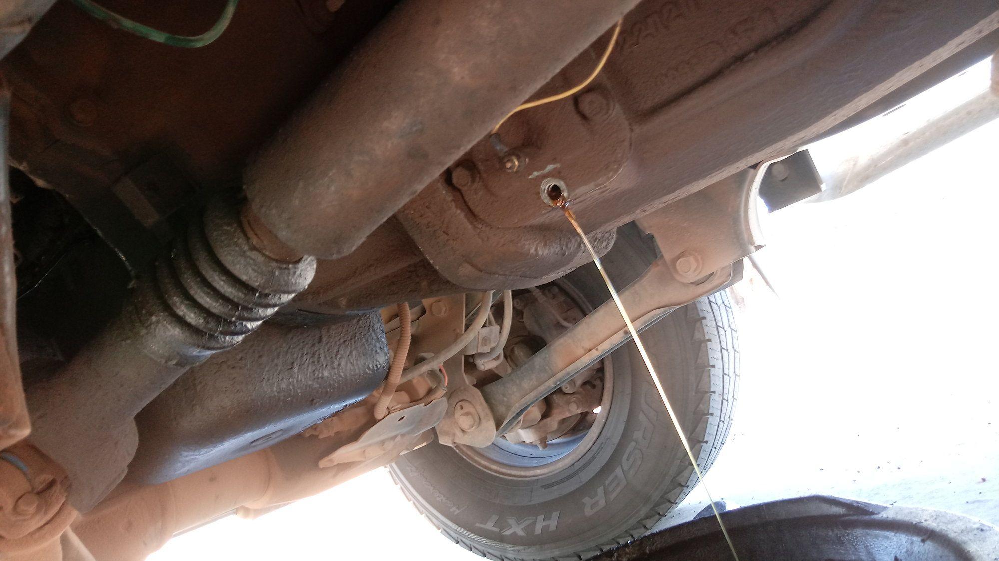

Changed oil in the transmission today, 36k so it was due, 322k total. Refilled with 1 gallon of Napa 15/40. Rear axle is due too but my 85/140 bucket was too low to change it, gotta get some. Note how clean the oil is, no need to pull the PTO cover this time.

Nick, the oil draining out does look clean. The oil in my NV5600 has always been clean when I have changed at 36k miled and at 50k miles a couple of times. Remember you mentioning in another thread using Rotella 15w40 and I have been considering giving it a try. Notice any difference between the Napa vs Rotella oil with transmission performance? And was wondering how much oil you think might still be in the trans when using the bottom hole of the PTO? I've done this a couple of times too. Just wondering....

Michael, I don't think much oil is left. When I pull the PTO cover, clean the magnet and swab out the bottom of the transmission, there is not much left. I drive the rear on 6" blocks. That tips the transmission down in the front (drain bolt) and tips the rear of the transmission up (fill plug).
When I first installed the Cummins in the Ford ('90) and bought the '91 Dodge, I used Rotella exclusively, oil was cheap then. Then about 10 years ago, oil doubled and tripled in price so I started using what was on sale. We have a new Walmart here so I have been buying my gasser oil there, (Supper Tech) We also got a new Tractor Supply in the next town over so I have switched to Travelers for my diesels. They have some good sales, currently $7 a gallon by the bucket. I don't think I have mentioned Rotella in ages, Lol. I do have several gallons of mixed 15/40 still on the shelf I need to use, hence the Napa. Some Delo and Car Quest left, Napa is gone now.
I don't really see any difference in the 15/40's. Several years ago I bought a 5 gal bucket of Valvoline 50w. synthetic manual transmission fluid and tried it. It is still in my '91 and Ford and they like it. My '01 did not, it shifted hard when it was cold, so on the next change I went back to 15/40.

Nick, thanks for the details and experience with transmission oil changes.
When oil prices doubled and tripled I have always been keeping an eye out for sales ever since and can usually find a decent price on 15w40 when needed for maintenance. The specialty transmission fluids and GL4 gear oil are expensive and rarely available at lower sale prices and since the 15w40 more closely matches the Mopar viscosity spec for the NV5600 is sounds like a good choice. And it has worked well for you for many miles and heavy hauling!
I'm going to try a 15w40 in the NV5600 for the next transmission oil change.
Thanks for the excellent write-up!

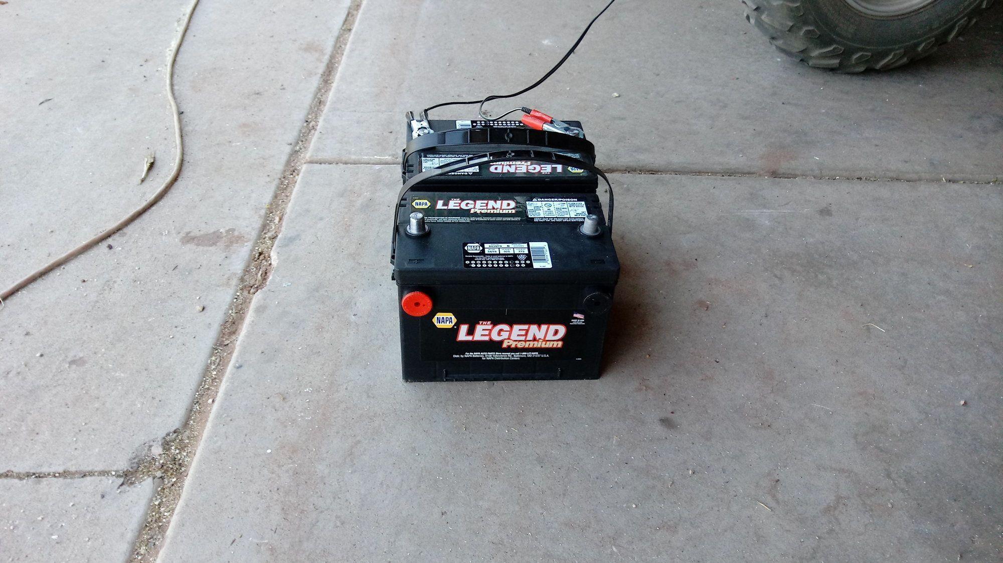

Batteries died this morning, so I had to change them. The old ones (Car Quest) lasted 8 years. Napa this time, hope I get another 8 years.

I got eight years with OEM Group27s and eight years with Interstate 27s. The NAPA Premium batteries look to be high quality. Are these AGM? And I've not tried the 34/78 Group size but have been tempted with some of the AGMs that are available now. Looked at DEKA batteries the other day and they offer an AGM.
How can you tell those are 8434/78? You got a good eye! I looked at the group 27 but they still have the vent/fill caps, I didn't want that. They are high maintenance (corrosion) v/s the no caps. The group 34 has a higher CCA than the 27 even thou they are smaller. These are the standard lead/acid. I didn't need the side post 78 but they only had one in the regular 34 premium. They have a big sticker that says MADE IN USA, then in fine print, with us and imported material, Lol.
Even the "sealed" batteries need checked occasionally or they will dry up.

Where is the lid at, under the sticker?
I cant tell from that picture but i would assume so. Is there something on the end where you can get a screw driver into to pop it open?
I probably wouldn't mess with them while they're under the full warranty period as they may deny you if there is evidence they were opened.
Nick I just looked at your other picture, yes thats where they would be. Some batteries have access to the individual cells, like a round cap, others the cap is one piece.
I don't know how I can tell for certain LOL, but there is something about the dimensions and overall shape that make the Group 34 very recognizeable and the Group 31 too. Classic battery sizes!
