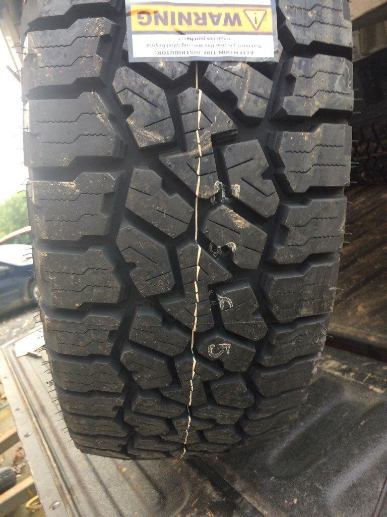

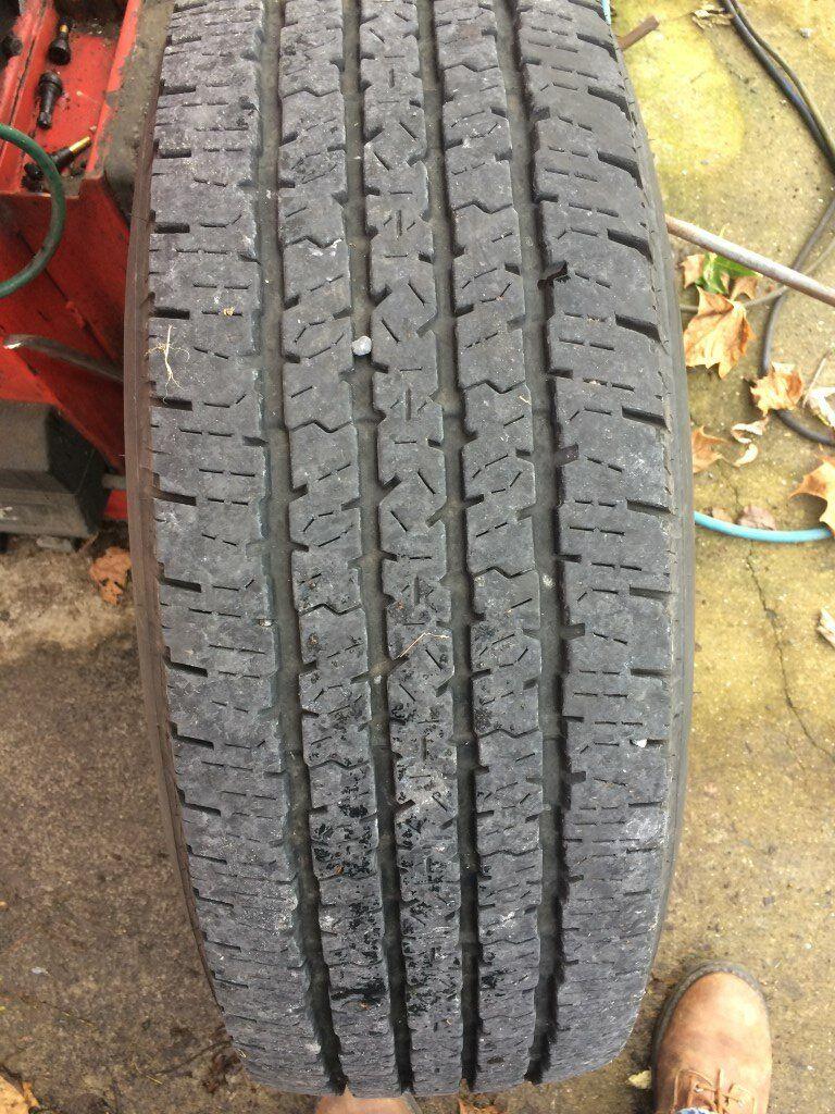

Finally replaced the OEM tires with something that should slide around as much in the field.
Sold the OEMs to someone on Craigslist to help recover costs.
Been a while since I've done larger tire mounting. Now I know why guys like the Hunter changer that lifts the tires for you!!! Oh well, at my stage in life that would NEVER pay for itself, so my older Accu-Turn will keep working just fine for me - but may need a new foot switch to control the clamps. Had to fiddle with it to make it not leak.
