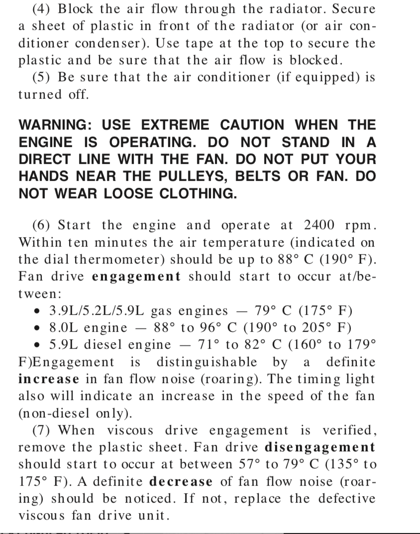

Nick, I just remembered some years back (3 or 4???) I installed a new fan clutch only because I read on the TDR that as they age they can lose 2-5 degrees cooling per year. Like I said I only replaced because it was 10+ years at the time. BTW I purchased mine (Mopar #52028615) at Geno's. I think I still have the original if you'd like it just for a try of something different. PM me if interested and for cost of shipping it's yours.

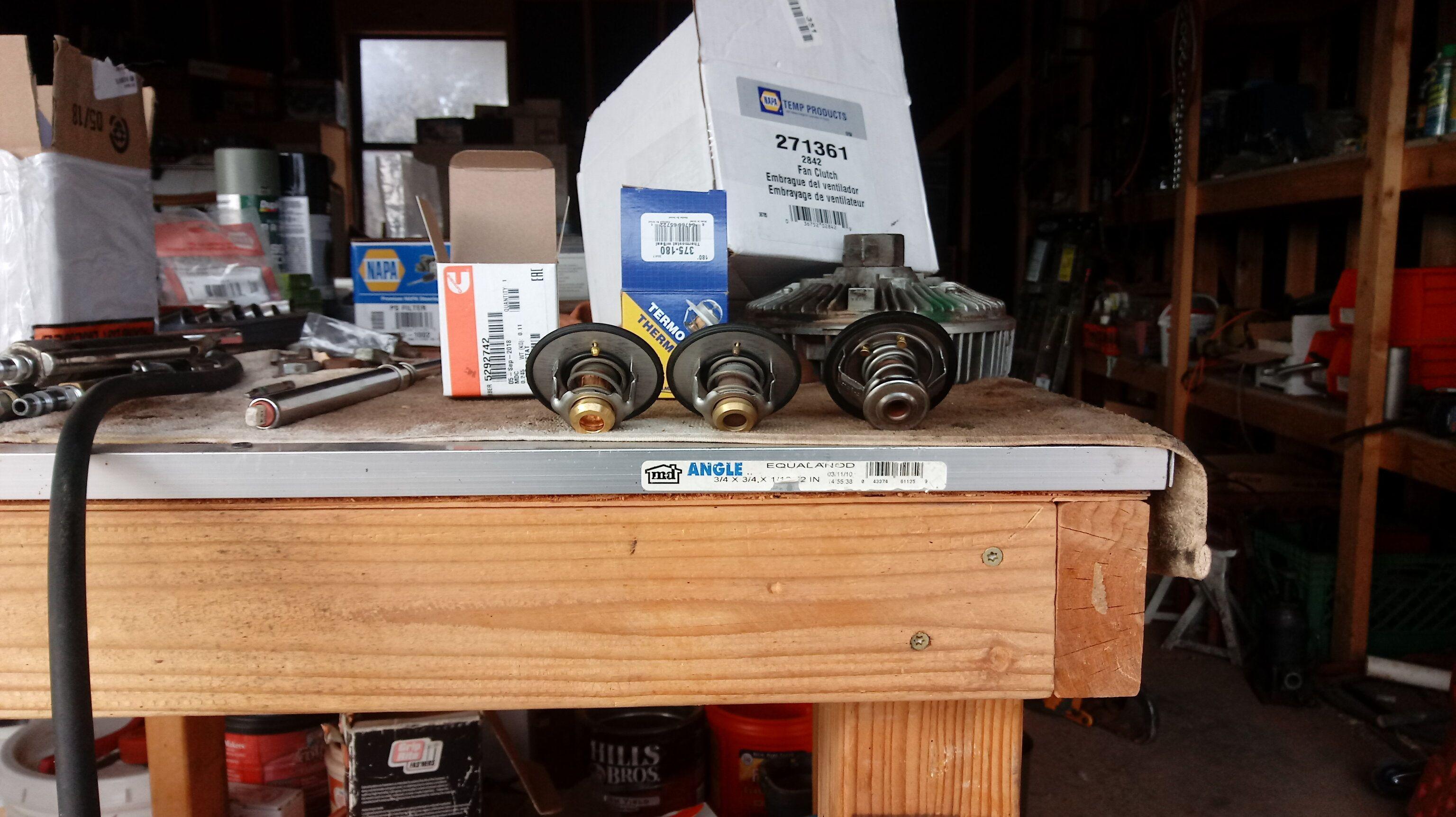

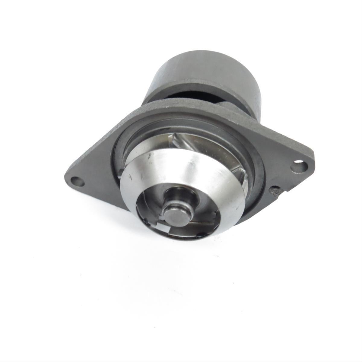

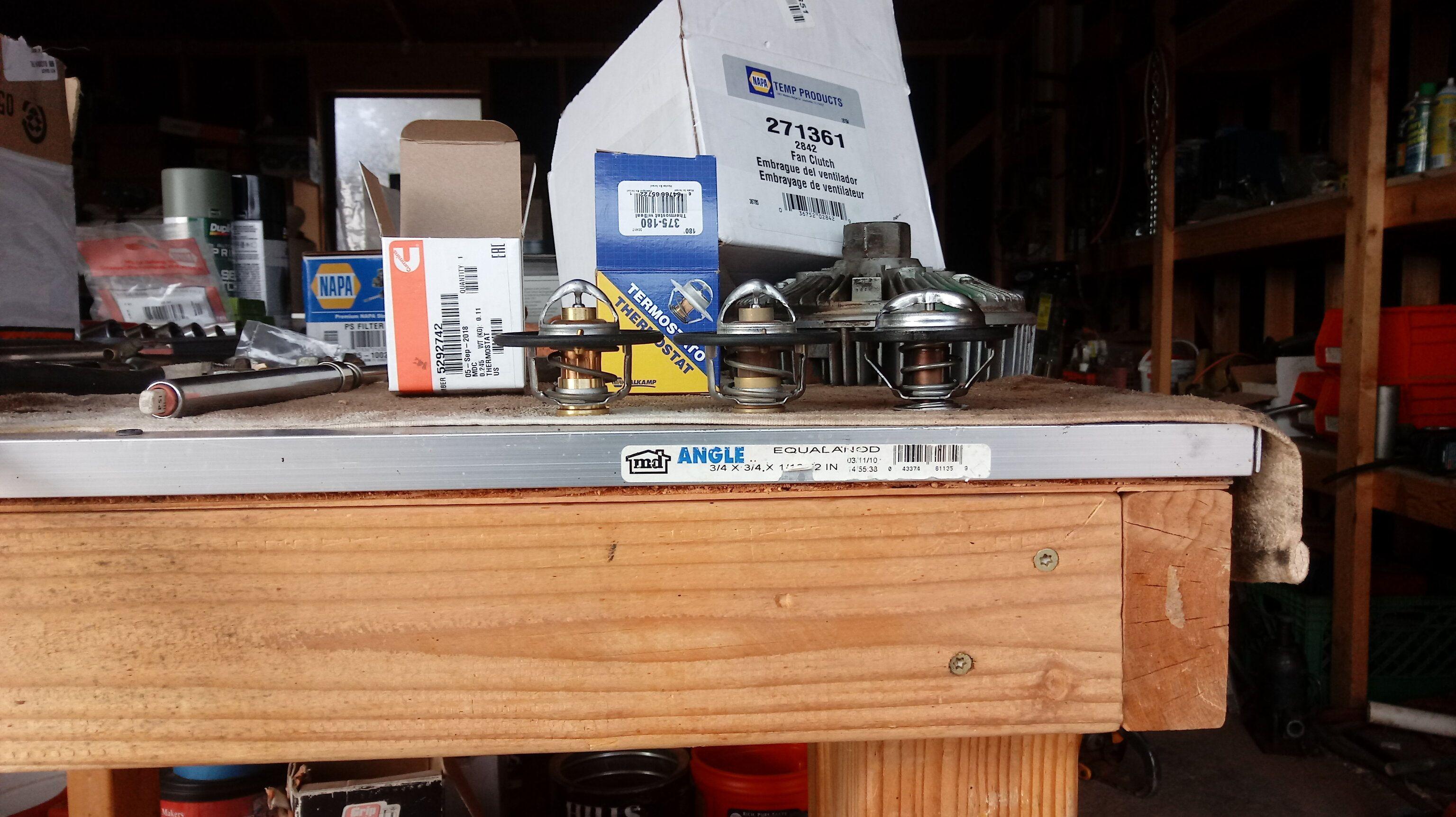

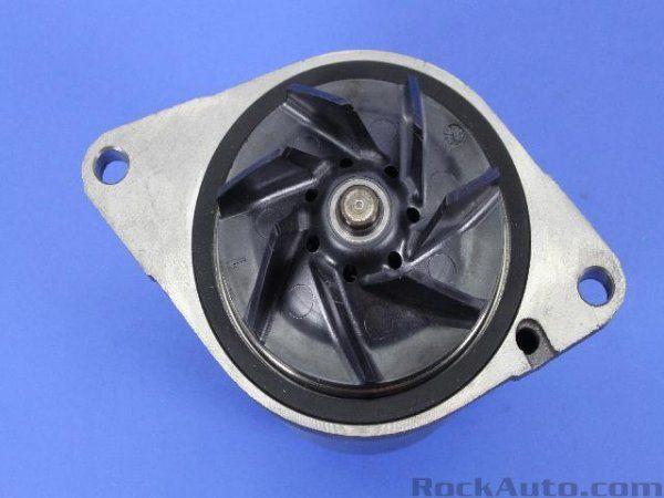

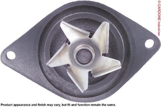

I have seen this time and time again about the Cummins t-stat, I need to order one (5292742). Here is a picture of my Napa 180 and 190. As far as water pump, I would think the impellers would be the same, Cummins v/s aftermarket but maybe not. I do know there are two types, here are some pictures.

Since the new Hayden clutch is no better than the old one, I am going to take it off and put my newest old Mopar back on. When I installed the 180 stat I only used the truck a few days before I changed to the Hayden clutch. I didn't give the Mopar clutch enough time for a good test. I wonder if my Napa stat is not opening enough when hot to give the radiator enough hot coolant to get it hot. Maybe my radiator is not hot, maybe it is just the engine that is hot. If so, that would explain why the Mopar clutch is slow to engage.

Nick, I wouldn't go out and replace the water pump, but I did notice the vanes on the Cummins pump are different than the parts store one that failed every year. Forgot to mention = the parts store honored their warranty and refunded me current price in full + tax when I returned their pump and said I was purchasing one from Cummins! Rare! I didn't notice any difference in cooling ability tho. I did replace the OEM radiator with like and kind (from Advance) back in 01/2012 (just went out and checked) it measures 2-¼" deep (across the top) so whether it's a 2 or 3 row??? Been thinking a bit about your dilemma... a few questions (don't be offended) 1- do you have a shroud, 2- have you checked the front of rad (between A/C condenser and rad) to see if it's clogged/restricted with oil/dust build up (not sure if you have extended the breather tube from the gear case or not, 3- are you running stock turbo and have increased power? Not sure but, does a 90CTD have intercooler? Are you fully gaged up = fuel psi/boost/egt? Seems like you shouldn't have cooling issues unless there's a restriction somewhere = internal, external, or lack of flow. I'd try the Cummins T-Stat and check radiator for cleanliness. If no shroud that makes me think the rad isn't able to cool like it should...

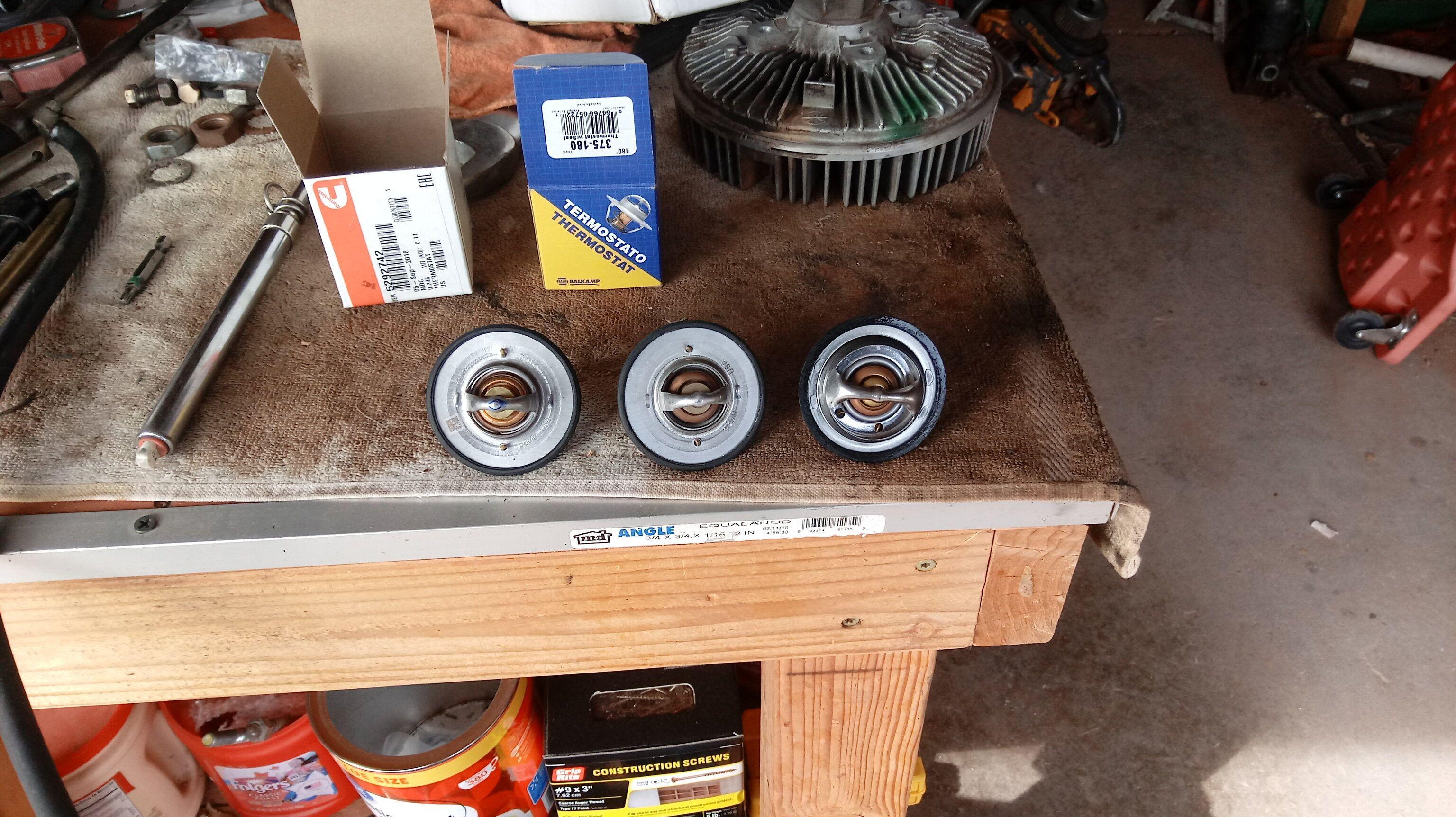

The new Cummins stat is on the left, center is 190*, no clue on the brand but looks like the Cummins style, right is 180 Napa.

There are differences in the water pump designs that affect flow rates. The newer trucks have the lowest flow rate with the open fin impeller, and the the 1st gens used the highest flow rate closed vane design... It seems the higher the HP goes, the slower the flow rate?? This leaves me scratching my head, but Cummins QuickServe still shows different pumps for the '92 vs. '09, while NAPA has the same PN for both.

Mikey, Good point! Now that I think of it the aftermarket ones I got (each "new" not reman pump lasted 1 year +/-) had open vanes the Cummins one (as well as the original one) had closed vanes.

The 6.7 has a 7 impellor water pump v/s 5 on a 5.9, so I think the 6.7 has a higher flow. I think a 6.7 pump will bolt on a 5.9 but I am not sure that would be a good idea/upgrade.
That is interesting that the open pump has less flow than the enclosed type, that looks/seems backwards. My oem was open, one replacement was closed and now my last one is open. I never really noticed a difference but I probably wasn't watching close enough. The closed one, Car Quest (GMB) only went 24k, I have a Napa open now.
