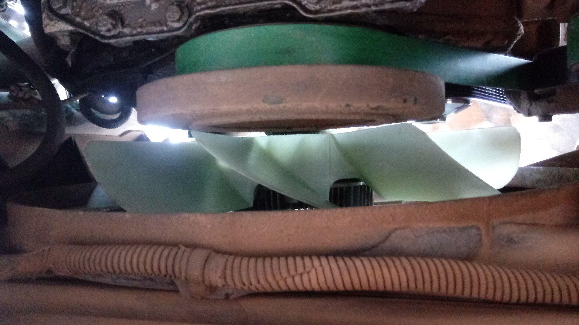

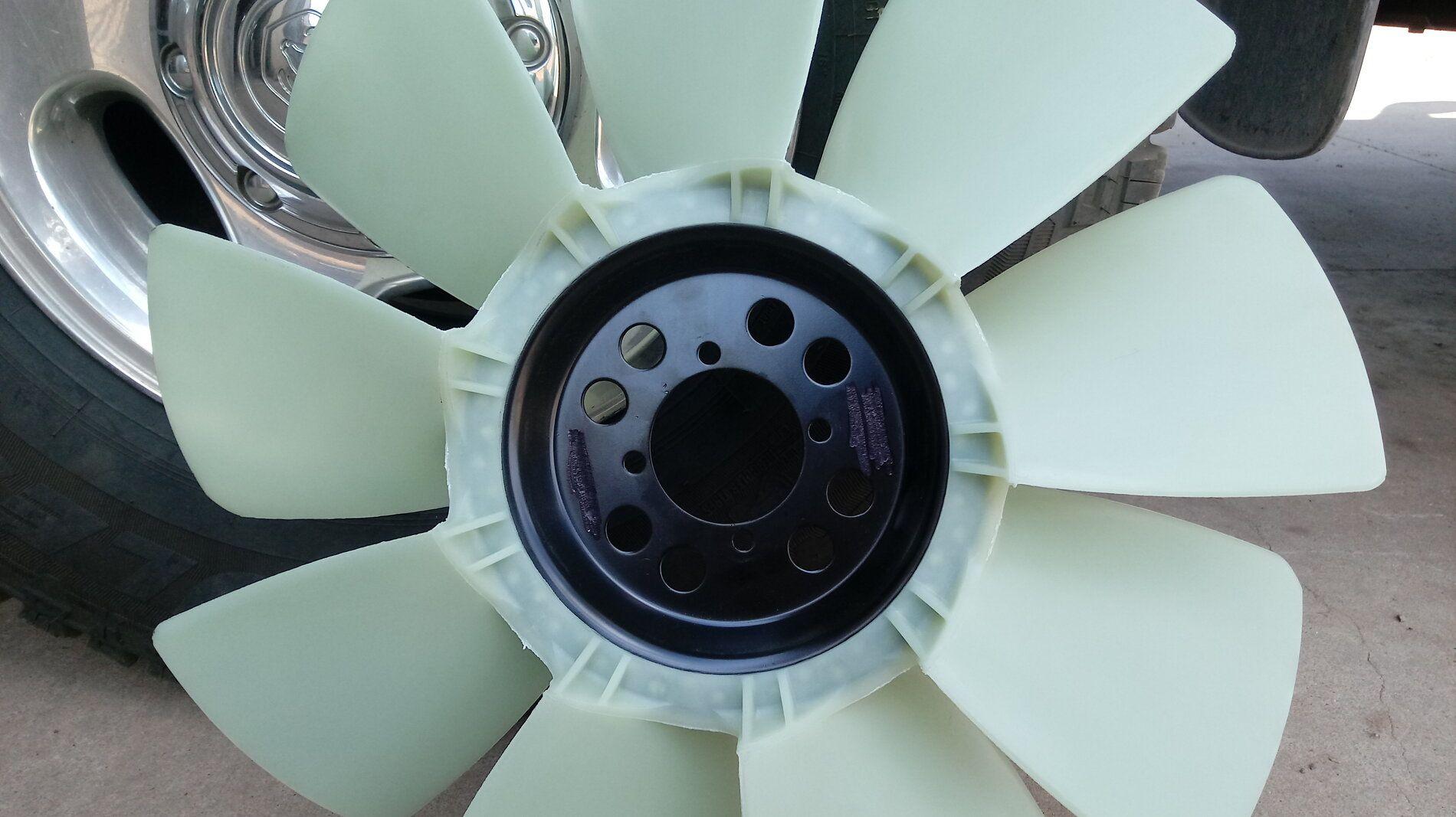

Installed the new fan today, it sounds cool, like a big truck:D I couldn't use the adapter spacer, it put my fan clutch into the radiator. So, I installed it without, and it only clears the harmonic balancer about a 1/4". With it revved up to 2k rpm, it flexed forward about an 1/8" so all should be good. For some reason the ID marks are ground off the fan hub so no clue who made it. The air flow is definitely more at idle so maybe the AC will work better at slow speed/stopped.
You think it will take extra HP ?
According to Geno's, it flows 39% more than oem, so in theory I will lose a small amount. Maybe even a hair in fuel mileage but only during lock up.
It is still a lot smaller than the 3rd and 4th gen oem's, so if you guys can take the hit, I can:) Anything to help a marginal cooling system, I am all for.

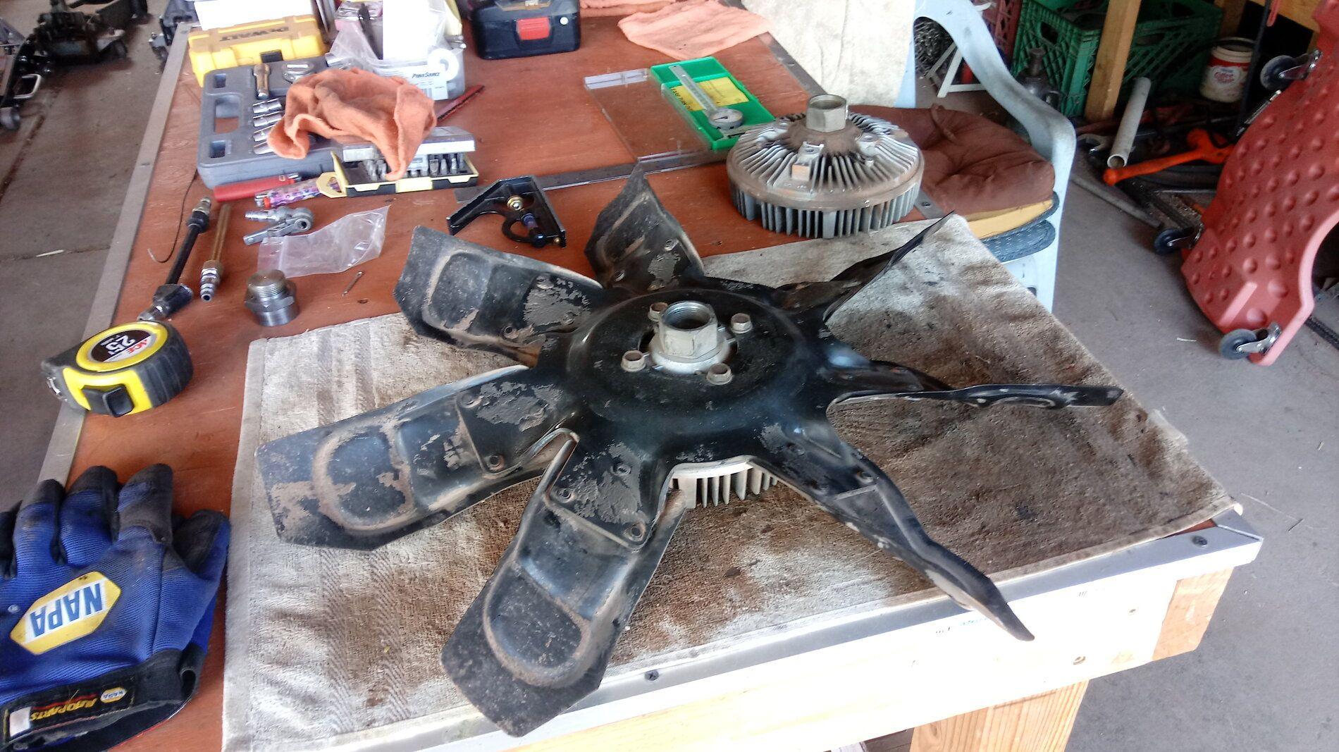

My oem fan:
Just think positive, if it does club the balancer it is plastic and will reform itself :D

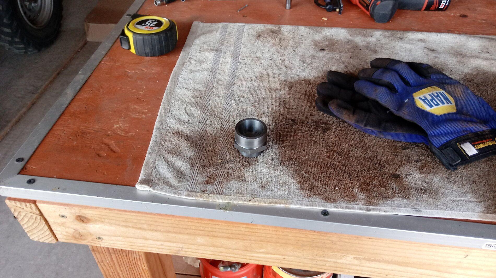

You scared me in reference to the "club" :) so I crawled under the truck and took a looksee, too close, more like 1/8" down there. So I picked up a shim from ACE and installed it behind the fan hub nut. It was a tiny bit small on the ID so I used my round file and made it fit. It is 14 gauge or about .075" or a little over 1/16". Since the threaded fan hub is on the short side, I figured I better not use 2 shims.

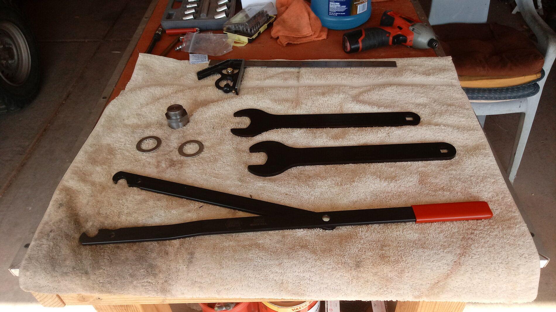

After R & Ring my fan clutch about a dozen times over the years with "make do wrenches" I finally picked up a set at Napa, they are on sale. With the deep counter sunk hub on the new fan, my standard 1.5" end wrench is a no go.

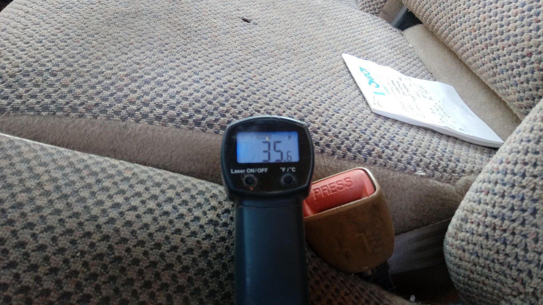

Filled my 18 year old pickup with refrigerant this morning, it took about 1/2-3/4's of a can. I do this about every 2-3 years. Never been worked on. With ambient temps at 71*, max cool, max fan and auxiliary cooling fan on, at idle:)
