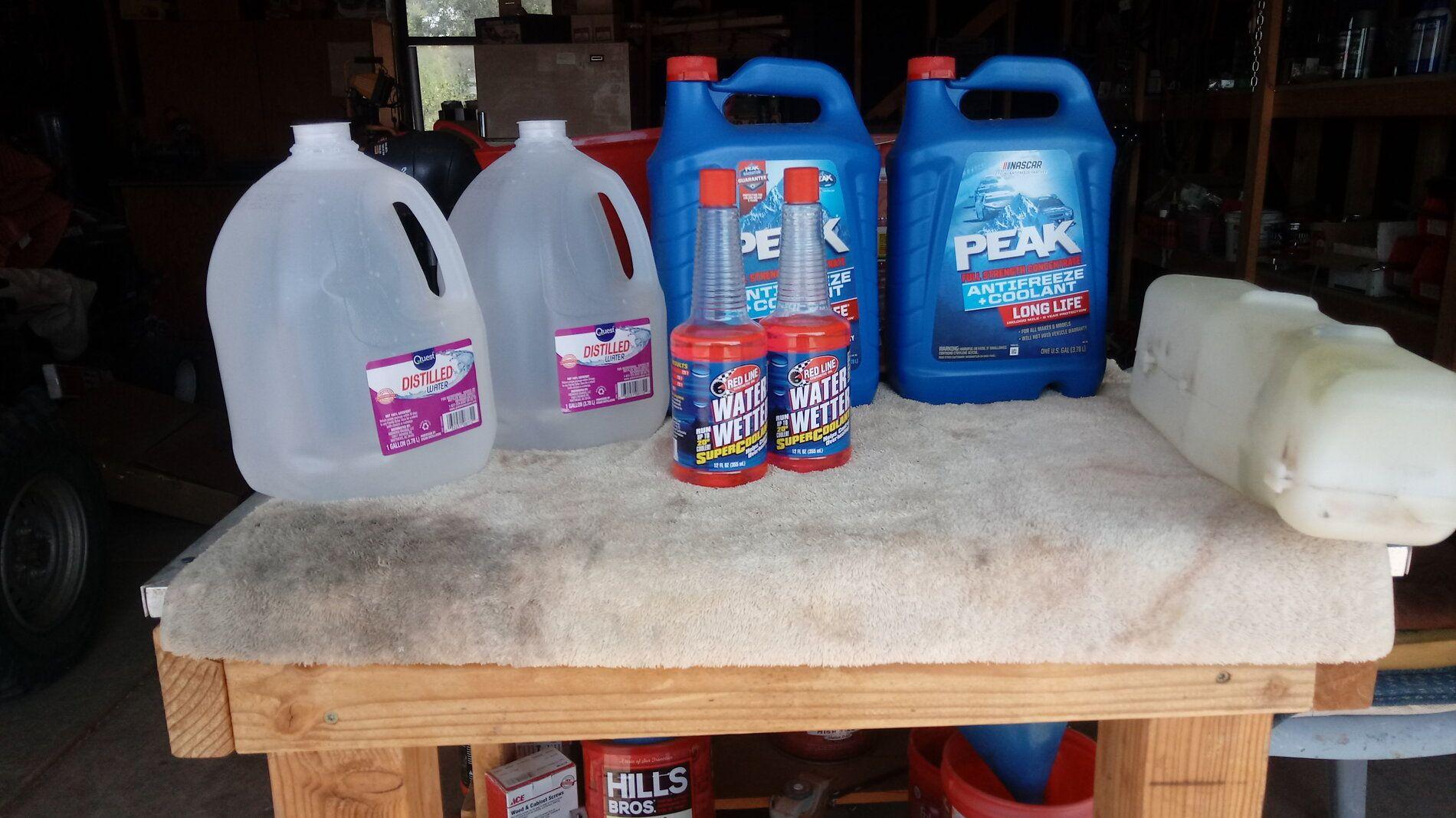

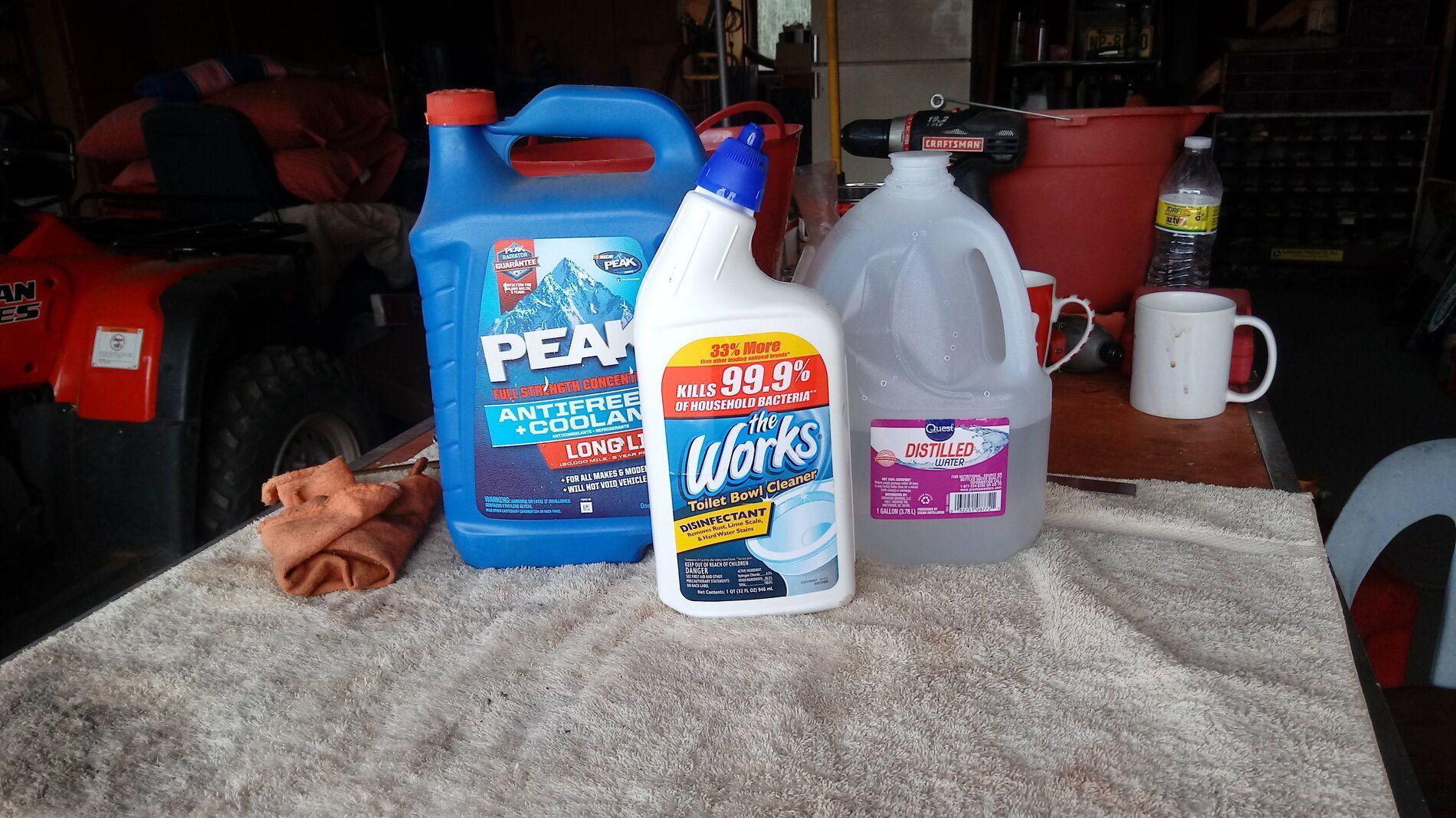

Changed out the coolant/flushed the system and flushed out the heater core with some toilet bowl cleaner:D Added some Red Line Water Wetter, they claim it is the "cats meow":) Gary, any updates on your VP coolant additive? I even removed the overflow bottle and gave it a good cleaning.
