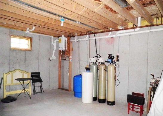

Hey BIG, is that a Rain Soft system In the picture?
We bought one when we were living at our old house to improve our well water, it was a great system. I actually brought it with us when we moved but this house already had a system and it's been good enough I've left it alone.
JR I cant remember what the names of the different tanks and system parts are, but Rain Soft sound familiar, Penny has skin that doesn't like the minerals in the water. So most of that is for her, Just above the white cylinder you can see a black filter mount with a blue filter cartridge below it. That and two others are what cleans the water. First one removes all the BIG **** and the second is a filter that removes parasitic organisms it also has a UV sterilization unit to kill EVERYTHING, the third is a filter that removes ALL chemicals and minerals from the water. I change EVERYTHING one time a year it cost about $200 buck for all the filters.
The upside to this is that white unit on the upper left of the wall is a tank-less water heater, its as clean as the day we put it in, those things aren't cheap, the wife's fridge has a water filter for the water (that tastes as good as any bottled water) we have yet to replace the filter. The lines in the house are clean, shower heads are running like the day they were installed. So it pays we think.
