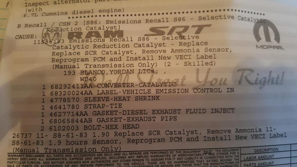

Anyone notice after having the SCR replaced, the truck goes through active regens more often? I wonder if this is part of the new programming? I get now every week or every other week. It consists of a 100% to 70% count down on the EVIC. The truck no longer runs differently during active regens nor any noticable smell.
Also not noticing fuel dilution of oil that i used to see by oil climbing the dipstick
Your signature is "2013 Ram 2500", which is not included in this recall for 2014-2015's. Did you get your SCR replaced under this recall or for some other reason?
I took mine in three weeks ago for the recall. Two days after that my DEF "pump" failed. Maybe coincidental. In addition to the recall, they flashed the PCM for TSB 18-037-16 and flashed a few other components for other TSBs. This makes it difficult to tell what difference the recall itself had. The result for me of all the changes has been better shifting, it appears to grunt up a few particular hills better where it used to downshift, and maybe I am getting better fuel mileage but that is a tough one to determine from just a trip or two looking at the EVIC. I may hand calculate for a while to see.
As for 2013 not being listed as a covered model under the recall #S87, that is correct. 2013 Cummins equipped Rams were recalled under recall #S86. Why the different recall number for 2013's vs 2014-2015? I am not sure, and there are others on this forum with the knowledge base to answer your question accurately. If i were to guess why there are different recall numbers for different model year Rams with virtually the same engine and emissions? I imagine maybe there were different instructions to the dealer service dept for those different model years. Or maybe the part number that is ordered for the recall fix is different. As for fuel mileage, i haven't seen a noticable difference. Ram claims slightly worse fuel mileage should be expected. I wonder if that is because it seems to active regen slightly more regularly even though the new regen programmimg seems a bit more fuel efficient because it dumps less fuel into the cylinder which doesn't end up in the crankcase? Others with accurate info are welcome to debunk my guesses/assertions in this post if they feel I have stated something inaccurate or if something needs clarification.
The only difference in the recalls by year is the software and veci labels.SCR's are the same 3 Part #s std cab,crew cab,and Mega cab.
