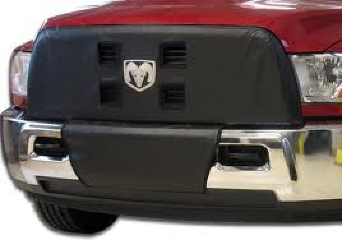

If you must idle due to the temps make sure to engage the high idle. Install that winter front. Plug in 1-2 hours prior to starting whenever possible even if in a garage, unless it is heated. A timer makes this task much more efficient vs plugging in all night or several hrs at a time. Electricity is cheaper than fuel!

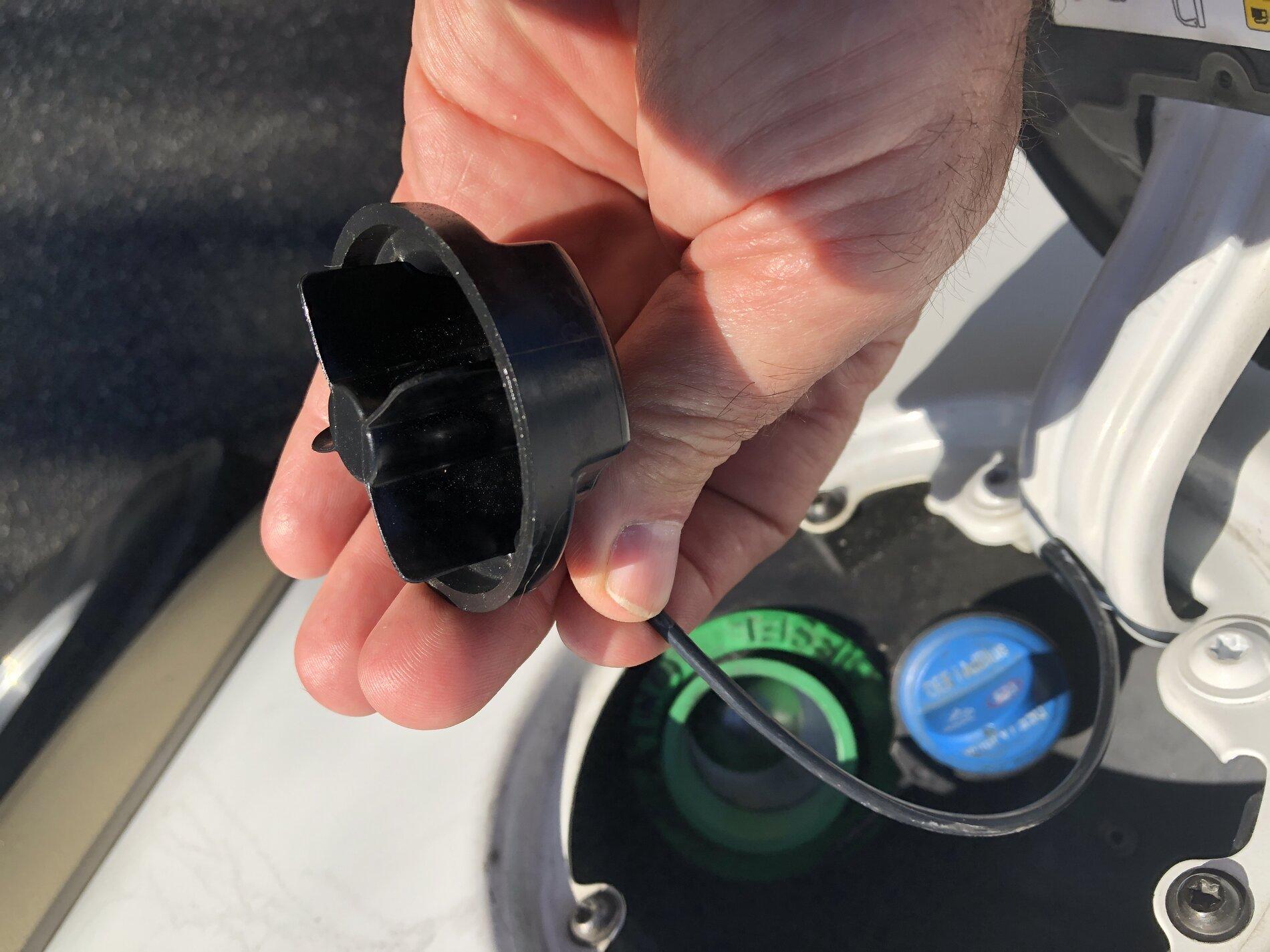

i bought the locking caps from Genos but that lock type is a PITA. I swapped it out for the non locking cap, especially since fuel prices were so low. Now that prices are climbing in may be worth putting the locking caps back on and fussing with the lock.
Non locking from Genos:

I really like this simple MOPAR cap.
The book says engine wants to be at 180 f and that high idle will help with that.
Exactly why you want to run high idle at those cold temps. At idle they struggle to maintain temp not only in the engine but in the dpf. Again a winter front will help. Pressing the exhaust brake button in conjuction with high idle will further restrict the turbo and assist in maintaining heat.
Is it even possible to siphon diesel out of these newer truck tanks? I bought a locking Geno's cap, but I hated it and went back to an open neck.
Yes, it siphons the same as a you have to get the hose to the fuel which means you would hold the trap doors open with the hose.
I have the MOPAR cover for my truck and haven’t ever owned a locking fuel cap.
I’m not worried about what they are taking out at all but what they might be putting in my fuel tank. What would a bottle of coca cola do to your diesel fuel system. Or something else??.
Do the shutters block this much air flow? :)
The shutters are designed to reduce aero drag going down the road. Ram includes the winter fronts with their cold weather group, for good reason. I agree they are not needed as much as pre emission trucks but at -30 they absolutely make a difference, especially on an unloaded truck thats not towing anything.
