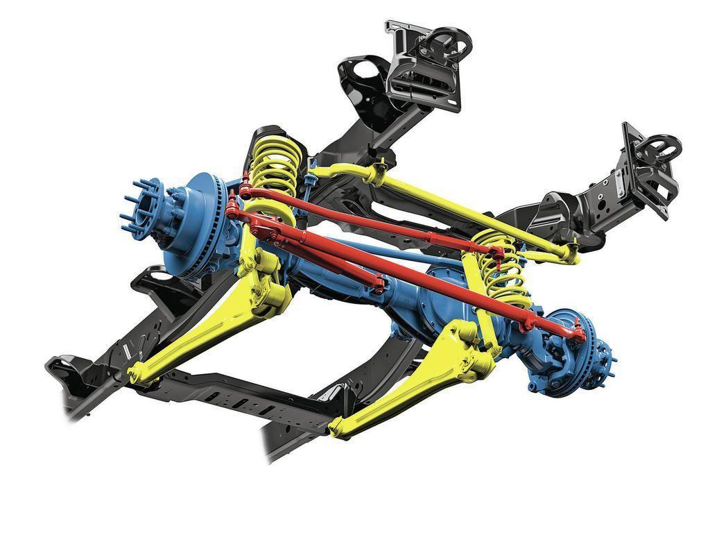

It's only been debated / discussed no less than 999 times that on a 2013 & up 3500 truck OR a 2014 & up 2500 truck the new frame enhancements are the source of no longer being able to service the oil filter from below. Your 2013 2500 still has the old style frame. The transmission (G56, 68RFE, or AS69RC) has ZERO bearing as to removal of the oil filter from below.

Ah, Yes! Thanks for the reminder. I knew there was a difference in the 2013 2500 Rams. But with all of the talk of removing the intake and changing the filter from the top, i was thinking that the difference was from the top.
You just helped me realize why some are able to use the Oregon chain saw lube for the front drive shaft. On the 2013 2500, there is a frame cross member right below the lube point (preventing access). If that cross member was moved 1-2 inches, there would be room. I'm guessing the frame change on the 2014+ 2500 (& 2013+ 3500) moved the crossmember so that those with the new frame have room to use that tool. So (hopefully without getting too far off topic), I can say that your comment just helped me rarionalize a whole different issue i had encountered last week.
