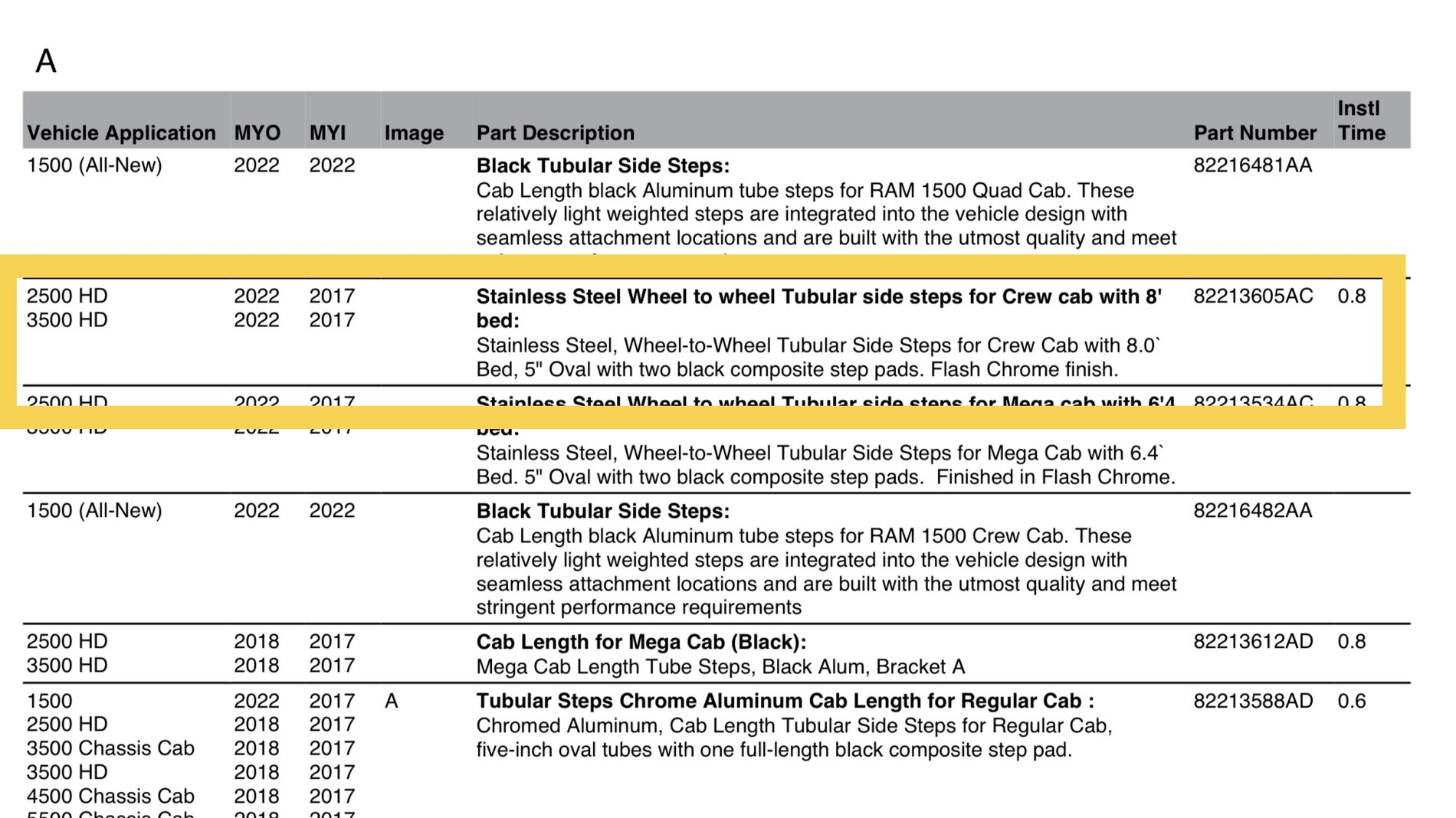

I'm not seeing any wheel to wheel steps for an 8' bed, of any year.. to include the Mopar wheel to wheel steps I had on my 18.

Stainless Steel Wheel to wheel Tubular side steps for Crew cab with 8'
bed:
Stainless Steel, Wheel-to-Wheel Tubular Side Steps for Crew Cab with 8.0`
Bed, 5" Oval with two black composite step pads. Flash Chrome finish.
82213605AC
3500 HD
2022
2017
bed:
82213605AC
Checked that out and it says 2WD only, which doesn't make sense to me as it is fixed to the body.

I agree with Topzide, 82213605AC
I see the 2wd thing using the part number in a web search, but where Mopar does not mention it in the Catalog I would not be concerned.

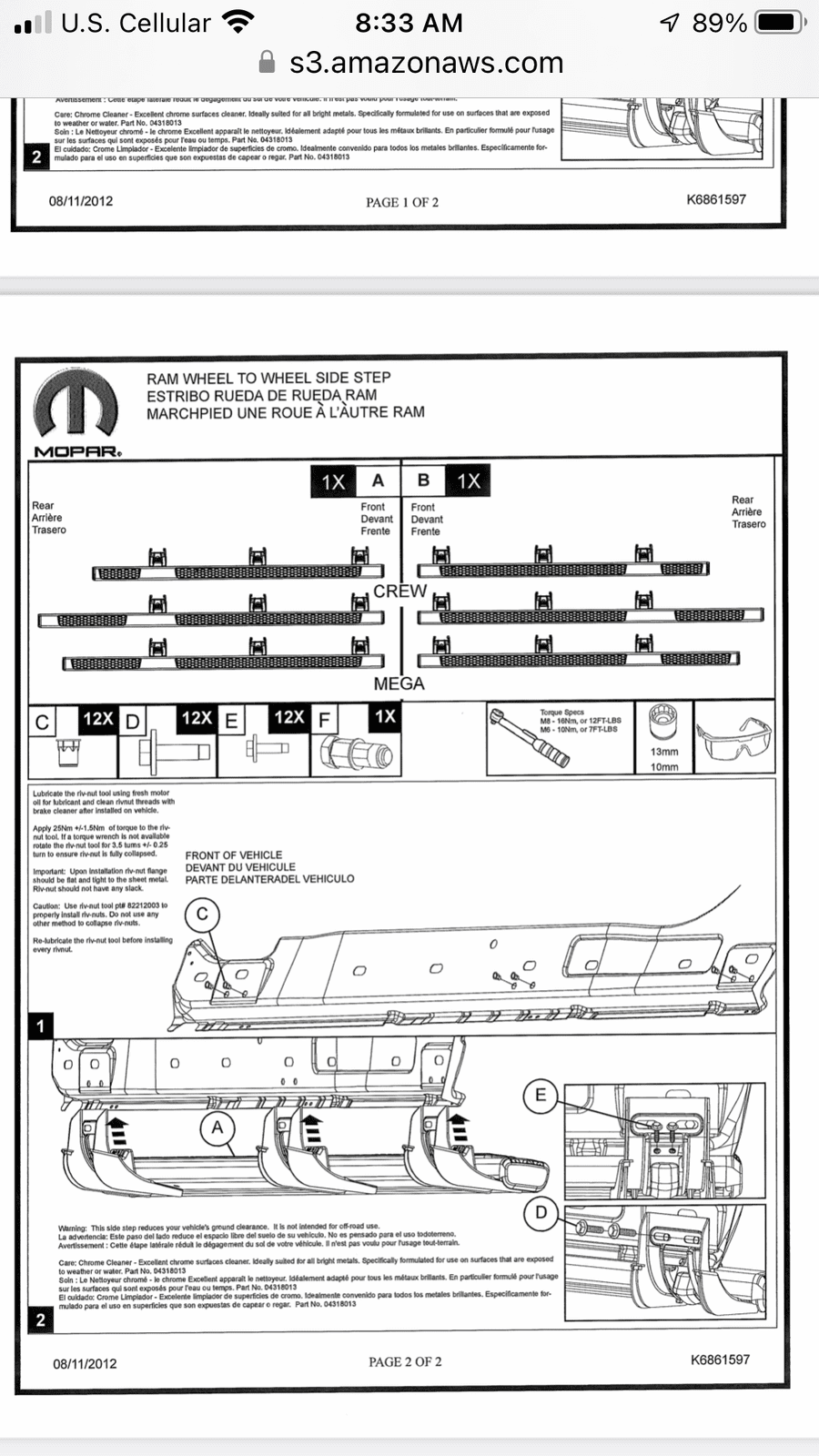

This will mount just like mine only with one more support per side. Holes are there.
There are the directions that will come with them.
