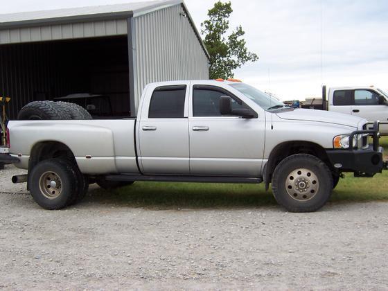

Do you have any pictures of your truck or other duallys with the 058s? Those are the ones I'm interested in.

My '03 Dually with 058s and 315s. Yes, there is a spacer in the rear... .

What's with the black center cap on the front? It looks a bit different from the one on their website.

Might be a manual hub... .
Dynatrac hub conversion kit. Love the kit, hate the price... :eek:
It really hasn't noticeably helped fuel mileage, but it seems to not be as bad about hunting on rough roads. Pulled my Peterbilt out of the field a few weeks ago weighing around 100,000lbs. The real test was when the front tires got on pavement. White-smoked two 315s for several seconds... . :D That's an awesome truck. #6 piston exploded last year so now it's bored . 020 over with a Piers cam and new injector nozzles. Runs almost as good straight as it did with a TST powermax set on 4!!
