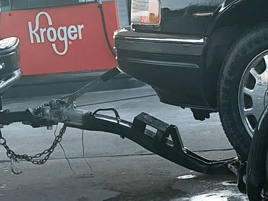

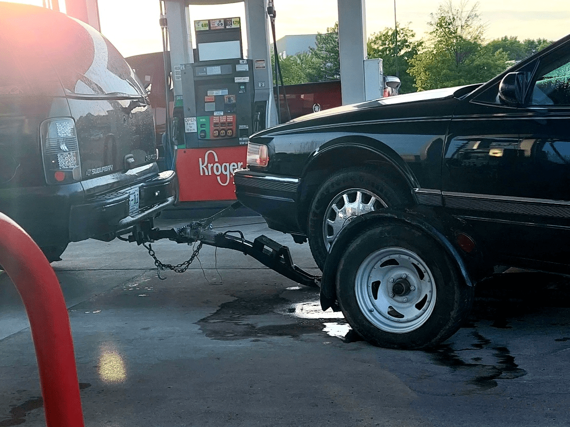

So, I was buying fuel yesterday and heard a serious dragging sound. I turned around and there was this Suburban pulling a car dolly with a Caddy on it. The tongue of the dolly was dragging the ground. There was a come-along hooked to the hitch and the tongue of the dolly, evidently holding it all together.
How is that even working? Is the part of the tow dolly missing? The part that the toad's wheels rest on? And yes, that kind of stupidity starts wildfires here in the Southwest.

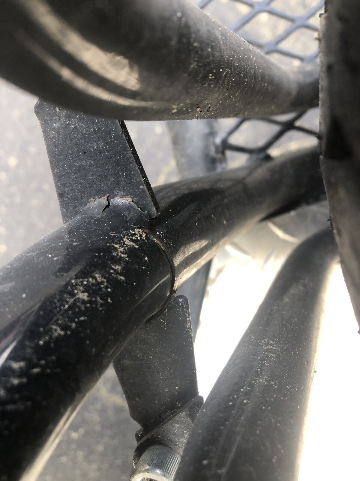

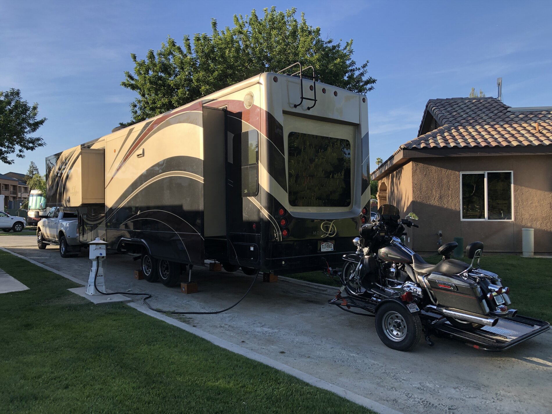

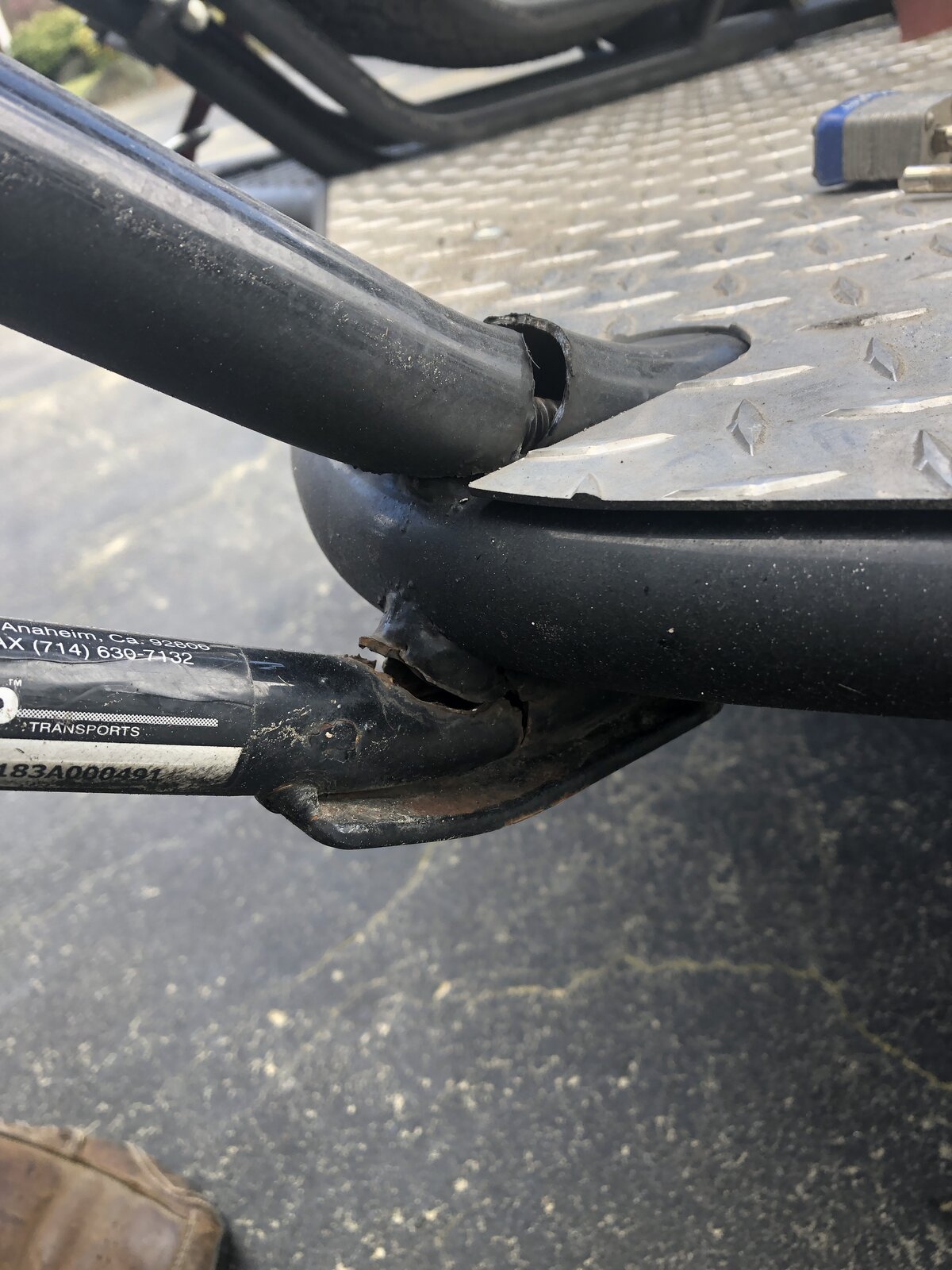

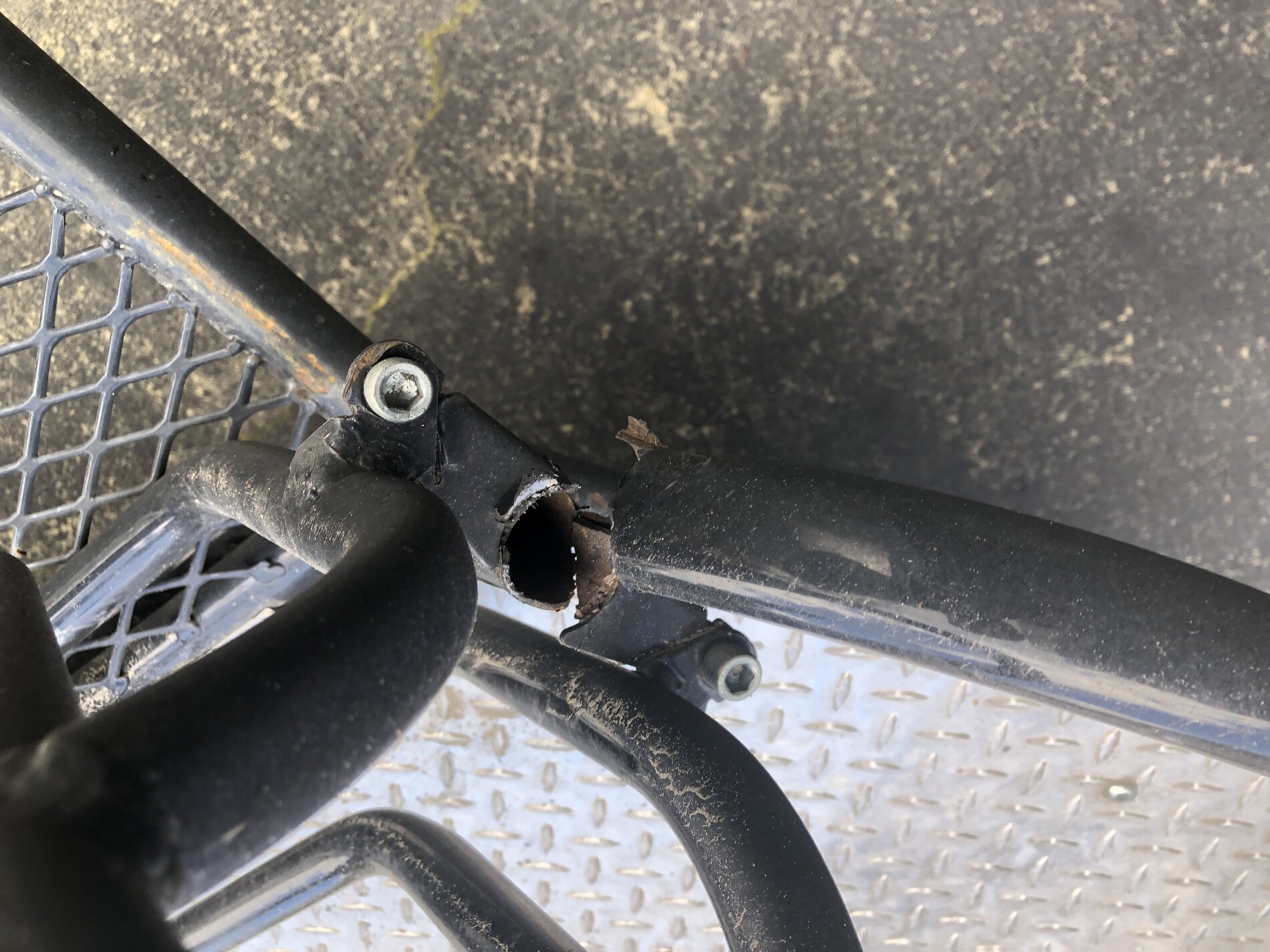

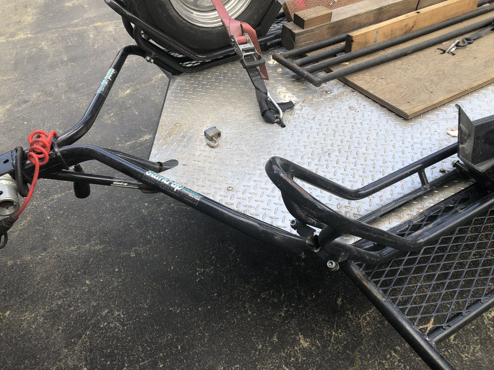

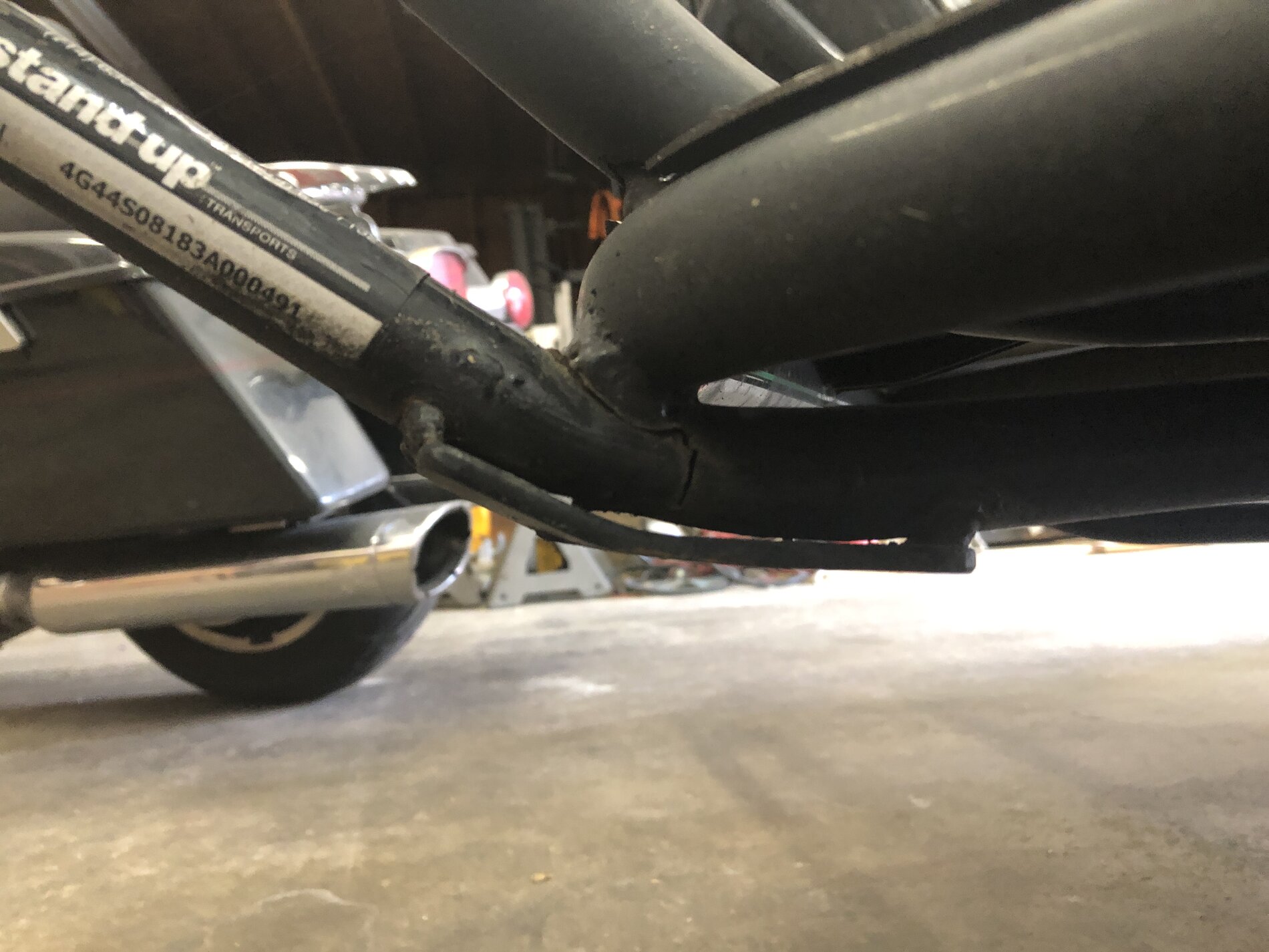

I tow my Kendon MC Trailer behind my MobileSuites 5er. Have done so for 7 years from NW WA to SoCal and back every year. Made it home to the NW and next day hopped on my MC and started pulling it backwards then all of a sudden I felt like the coupler came off the ball. I hit the front brake and looked, HMMMM still attached. Got the bike off looked and went HOLY SCHNITZLE!!!
I had a small pc of steel welded on the the lowest part of the tube steel where it would drag the ground on occasion. Good thing as that is the only thing that kept the trailer from separating and loosing it and the nice HD somewhere along the Highway.

Wowzers. It looks like that crack has been growing for a while, based on the rust that had developing in the break. The drag bar you had welded on probably kept it all together.
It looks like it's repairable by cutting out and welding in some good size sections. The welds could be rewelded, but I think that wouldn't be the best way to go unless there are some gussets custom cut and welded into place. I'm cure that you've checked the other part of the tongue to make sure that it hasn't also begun to crack.
Disclaimer. I am not a professional welder. I admire the pros and look to them to do the critical stuff.

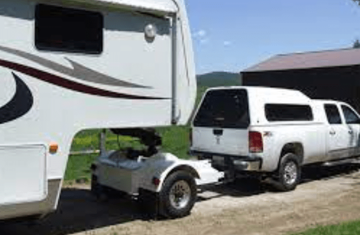

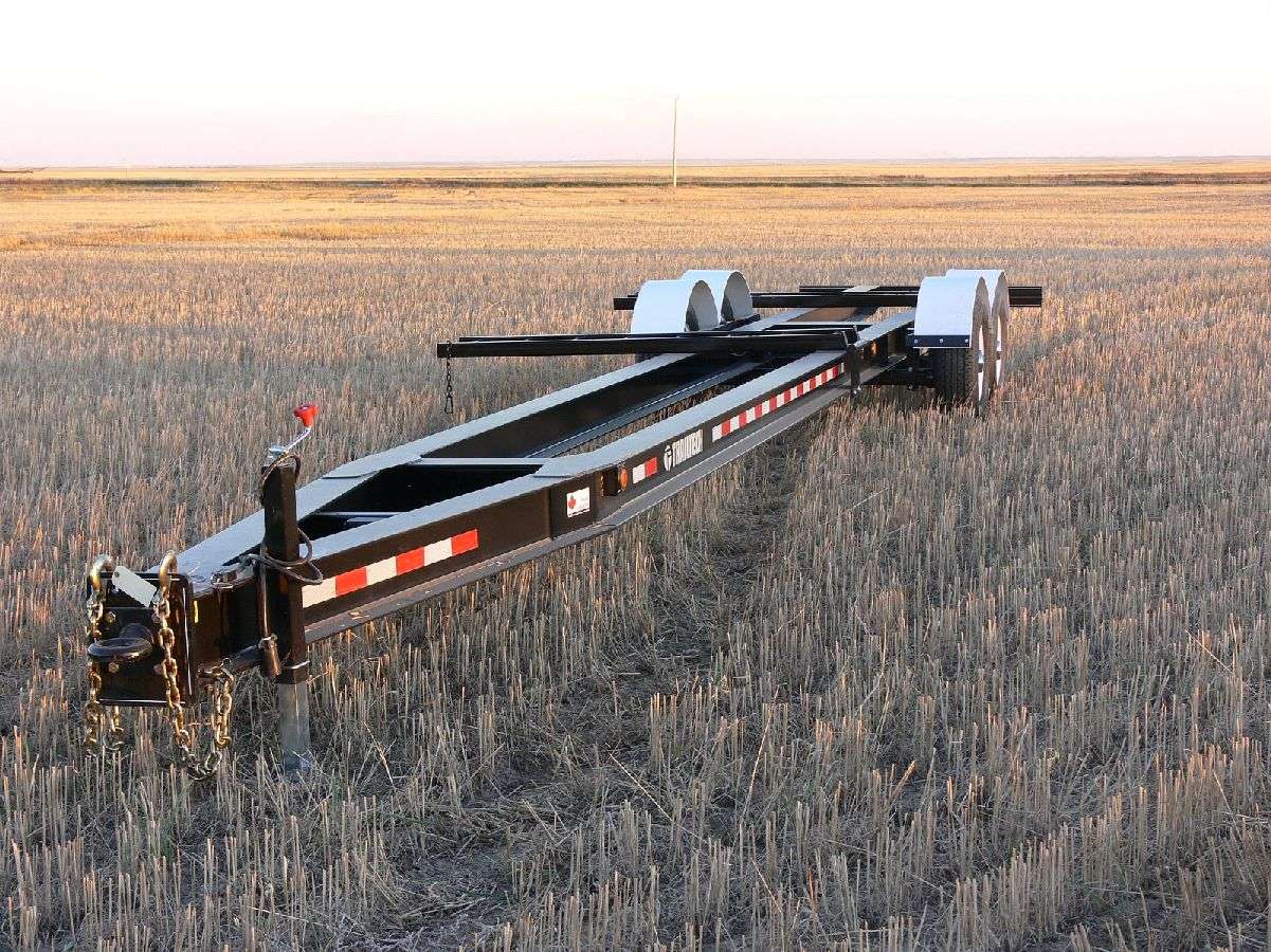

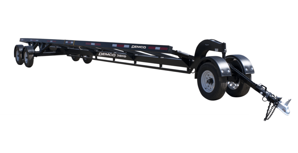

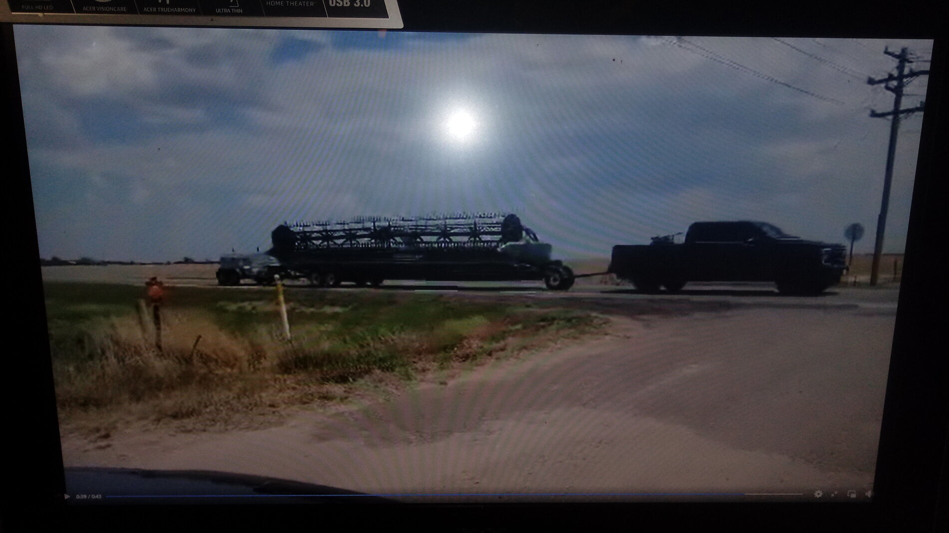

Can some of you guys explain this rig? Kind of a poor picture, I took it with my cell phone off a video. It was a video of a custom harvesting/transport crew on the move. Most of the trucks were semis towing two big trailers. First trailer was hauling the combine and the second trailer was towing the header.
With that type hitch there is no weight on the pickup plus he is double towing a fuel trailer. It looks sketchy to me, but maybe it is legit? I found the trailer but pulling them with a pickup, as high as 20k gvw??
I have seen those dolly's being used on the second trailer of two gooseneck empty stock trailers being delivered. I wouldn't have a problem with that but to pull something heavy with an empty pickup....
Something else I would not be comfortable with is two vehicles on tow bars behind another one. Two bumper pulls are not legal in Arizona, one has to be a gooseneck/fifth wheel but I see them here anyway.
I think it’s important to remember that it’s not so much HP that determines safe tow capacity but rather brake HP.
Which leads me to ask if those tow dollies have braking on their axle as well??

A lot of it depends on who is using it - private farmer or custom/for hire, and the state in which they operate. We retired to Missouri to my wife's family farm and I work part time for some farmers. They have two combines and a corn head and draper head for each. They farm a little over 5,000 acres, spread out over two counties. So, that entails a lot of moving of equipment. They have several header trailers, none of which have brakes. I believe the 16 row corn heads weigh right around 12,000#. I'm not sure what the drapers weigh. That means having both heads at a particular place, as they raise both soybeans and corn, (and sometimes wheat). When we move, it's usually two combines, four heads and trailers, a tractor and 1000 bushel grain cart (sometimes two), and four semis. Mostly, it's just a few of us moving a few machines at a time so it doesn't all look like a circus parade. If that is a custom outfit in your pic, I can't imagine they would have the fuel trailer full, but could be wrong.
To drive a farmers's tractor/trailer in Missouri, no CDL is required within a 150 mile radius of the home base and it's not for hire. I'm not sure what you are allowed in other states. Also, during harvest, we get a 10% overage on weight, so can be legal at 88,000#. Personally, I'd like to see drivers required to have CDL training...

Those header trailers are common around here. Never hear any horror stories of towing them either. The reason the dolly style trailer is so common is ease of hookup behind a combine. The Demco trailer in the picture comes from a factory less than 10 miles from me.
