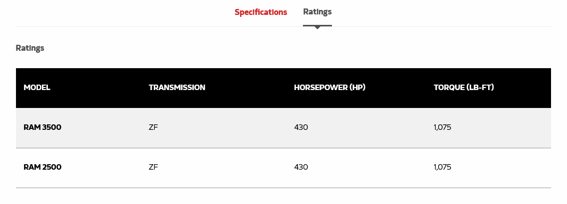

Looks like it will be a ZF:

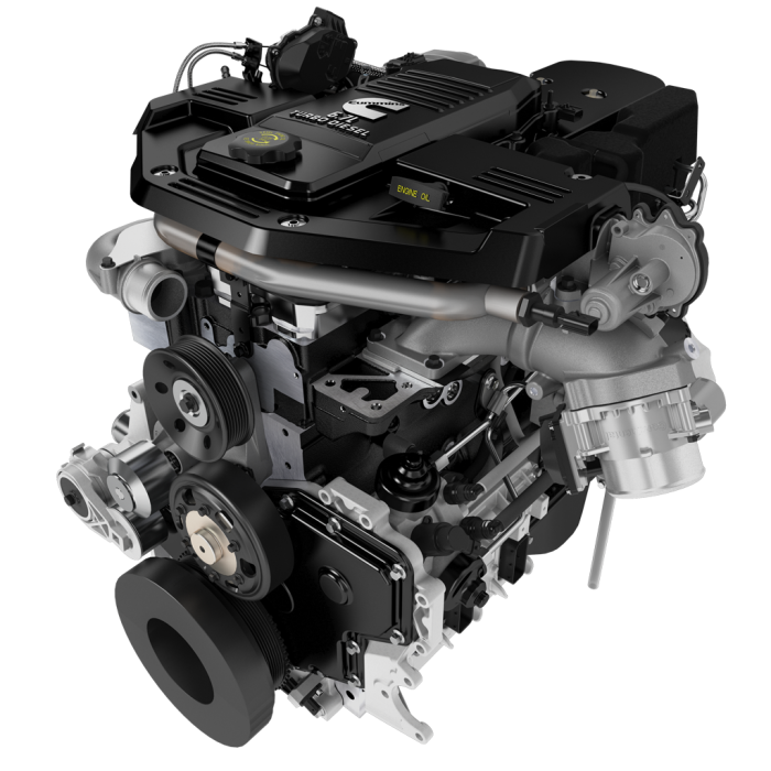

Looking closer at Nick's link, that is really the new picture of the engine.
Looks like some massive changes to the engine. Honestly, it looks much easier to service. Which as a potential future owner is a blessing.
New 2025 Cummins 6.7l engine:
Old 2024 and below Cummins 6.7l engine:
