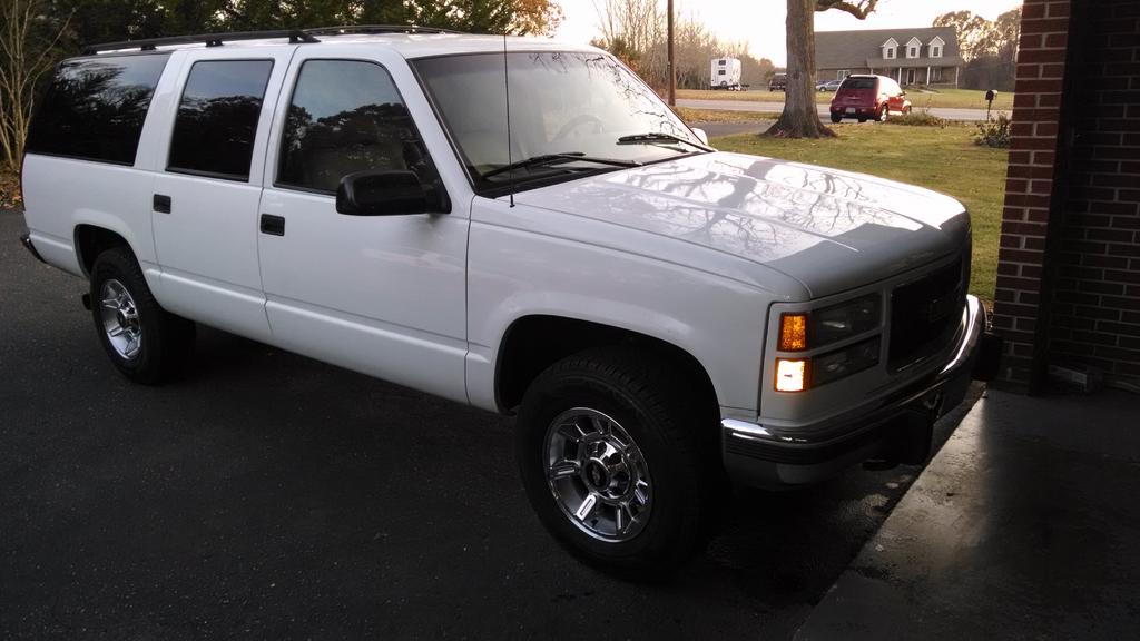

Bump. Just wanted to let everyone know that the burb/cummins conversion is still running strong. No issues. Wife is doing vendor shows for her/our bussiness loading it up pretty good. She is using it to burn up the highway like there is no tomorrow. FYI
The Suburban is still running good. Runs a lot smoother since I rebuilt the injectors. Has some occasional surging. Not sure why Hoping it is not the injector pump but will replace/rebuild if it keeps up. Getting ready to go thru the front end as well as replace front coils with 1ton springs. Also going to install bigger stabilizer bars from Belltech to keep it from handling like a land ark. Will keep you posted.

Just wanted to post an update. Went thru the front end. Upgraded to 1 ton springs in the front. Replaced two tie rod ends and the wheel bearings on one side. Brakes up front and also bigger sway bar in front and added a sway bar in the rear. The CTD is running strong as ever. Starts up instantly with the slightest touch to the key even without the heater grids hooked up. It has turned out to be a very reliable daily driver that gets good fuel mileage for its weight and can still haul the family around as well as loading the back with whatever we need. Someday I would like to upgrade to a trans with lockup but that is not an immediate need.

Posting an update on the Burb. She is still running good. I got some new tires about two months ago. New wheels also. Had to change out a water pump, serpentine belt about three months ago. A thermostat today. Other than that she is still running steady. Going on 4.5yrs since the conversion. No regrets about time and $ for this vehicle. Would do it again no question asked. I would like to do a 4BT in an older K5 Blazer at some point in the future.

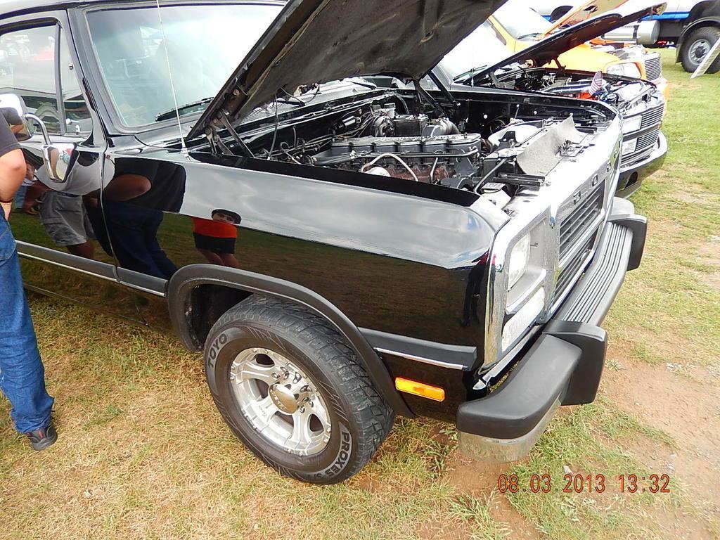

Take a look at this- I saw it at Carlisle several years ago. It looked like a factory install, right down to the Getrag transmission.
