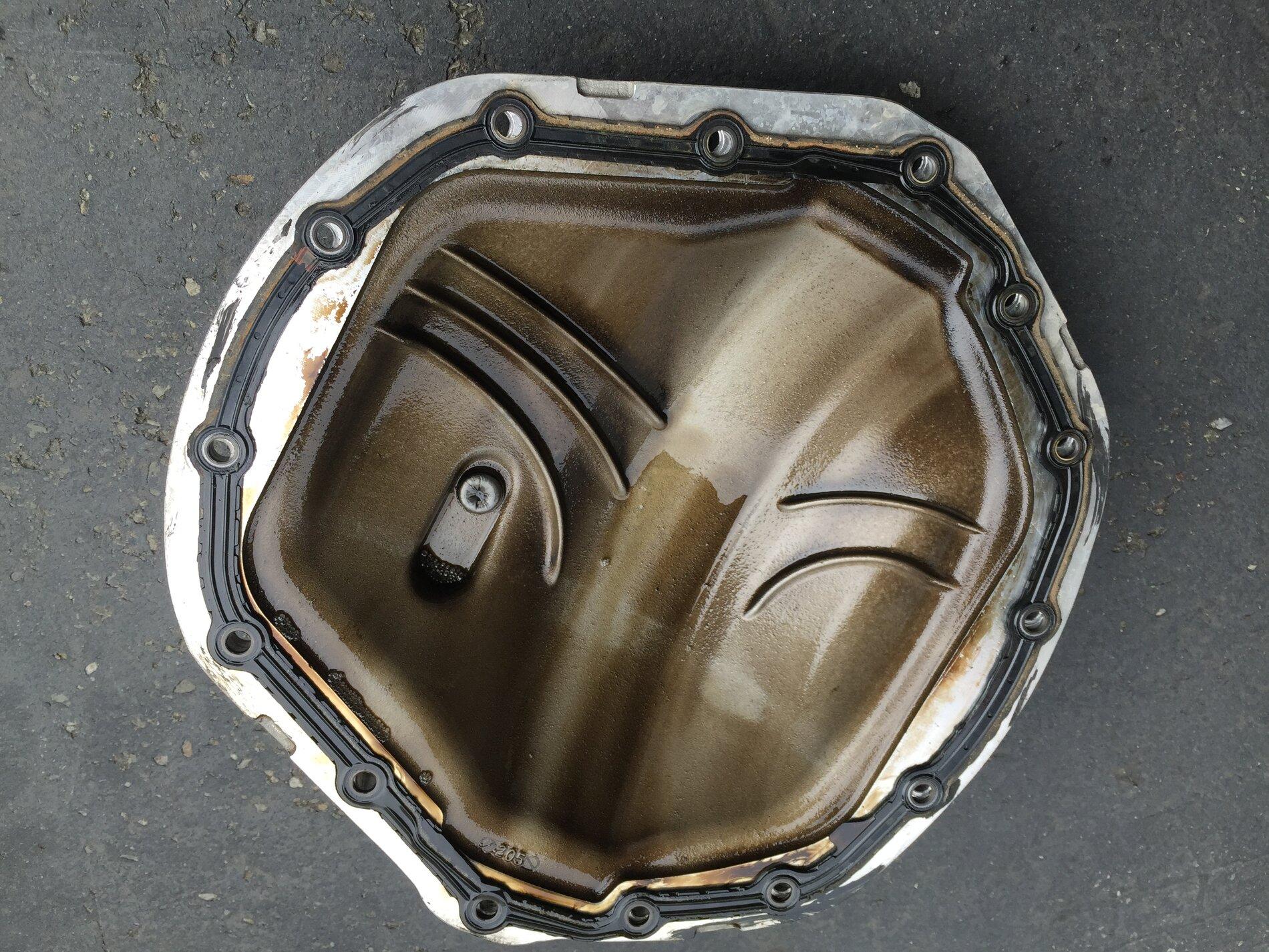

Based on the condition of this rear diff fluid I’m glad I don’t wait until 20K and probably should have changed it sooner. Not sure how long I’ll run this fluid. I went 50K on my 05 and it always looked/felt new but that was with 4 extra quarts.

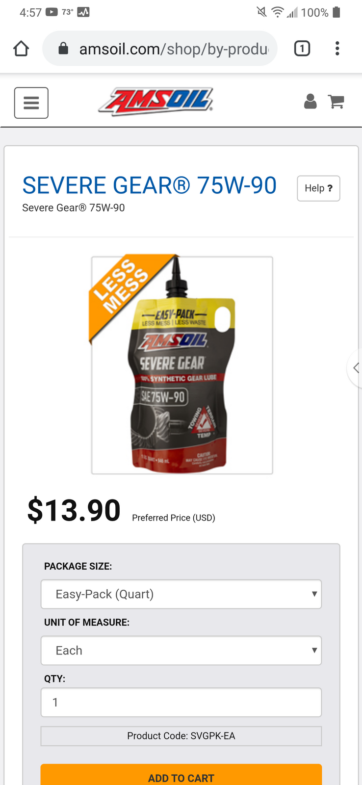

What is the member pricing on a quart of Amsoil 75w90?
Disclaimer: this photo is not designed to sell any products. (Trying not to abuse forum rules). At these prices, it won't likely sell any gear oil?
It is 1/100 of an ounce of gold..... Approximately.

Thanks Newsa. That's right at retail for Schaeffer's.
The bad thing about logging into Amsoil on my preferred customer account is i inevitably get a sales email asking me why i didn't purchase what i looked at. So yes, i got an email telling me how great their severe gear 75w 90 gear oil is......

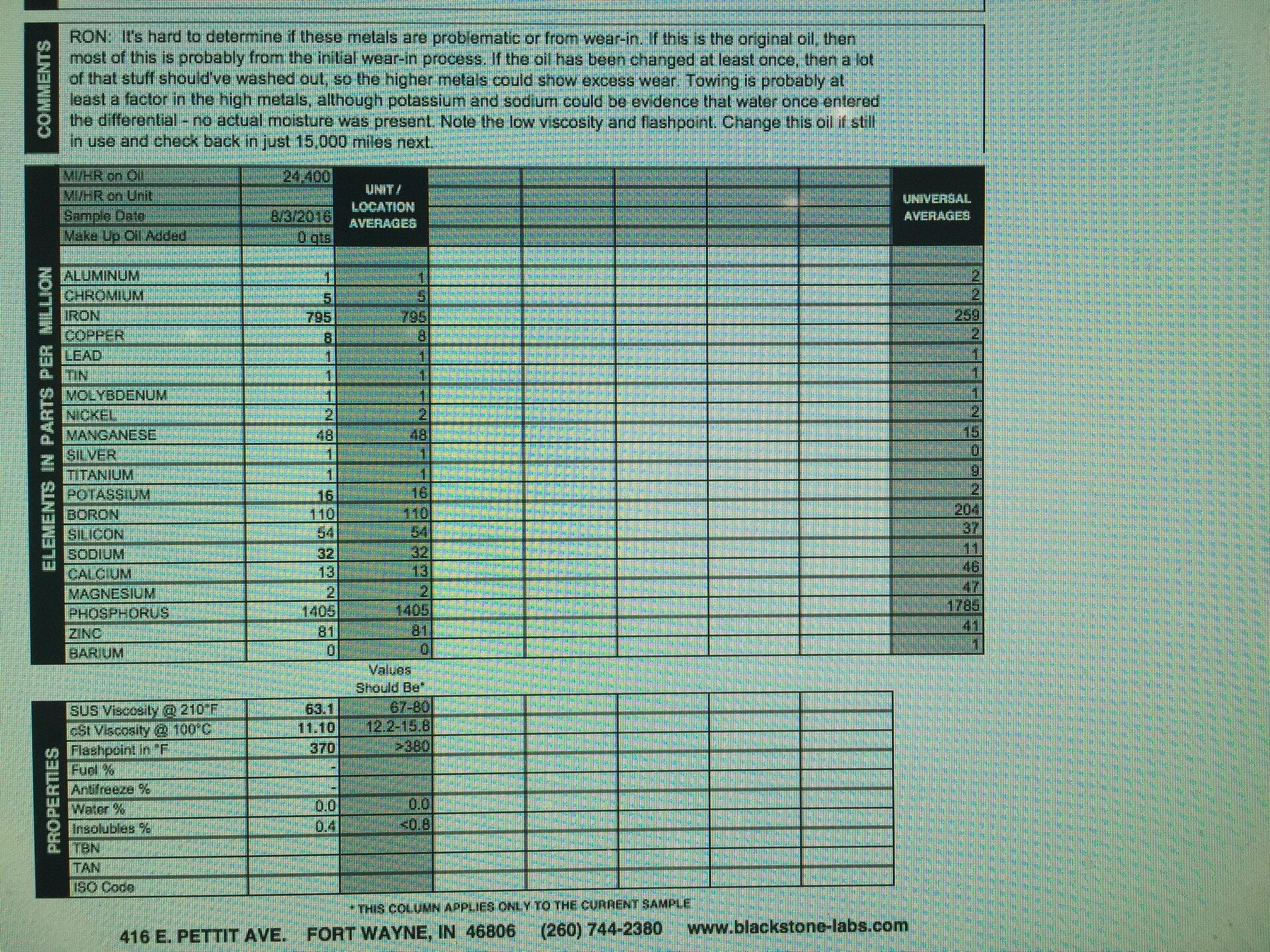

I paid $13.90 for the 8 quarts I received today. The squeeze bottles are pretty handy. Fluid looked OK at 19,000 miles and I took a sample anyway to see what they say. The magnet had a little fuz. Gears looked good. Changed the transfer case, it looked perfect, no metal at all in the drain pan. I took it around the block and fuel economy was up 40%, maybe more!
My highest combined was the Columbus trip at about 14k. I'll drop off the sample when I get a chance. Iron has to be high as there isn't anywhere for it to go but the magnet.
