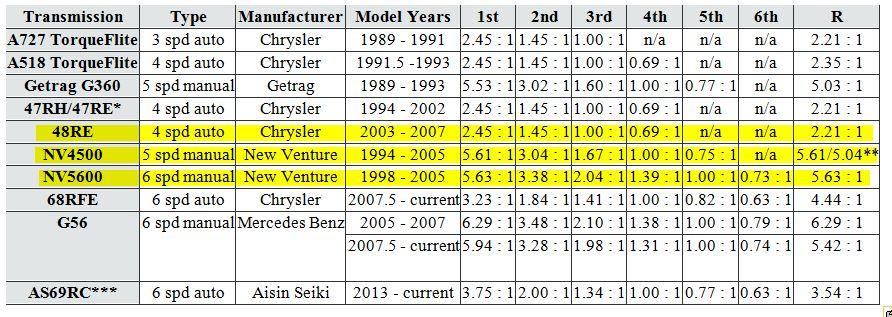

Here is comparison of gear ratios for many transmission, including the Getrag and the NV5600.
- John
I would really like to have the early G56 with it's 6.29 1st gear. My 5.63 1st in my NV5600 just don't get it on a uphill launch with a heavy load. The 6 spd shines on the down hill with exhaust brake too, more choices. Humm, 7 spd?:)
