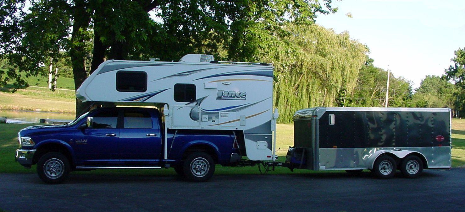

got a "shorty" a small camper and a small trailer , loaded I have about 8200 lbs on the rear axle. Bigger things would have bigger numbers
