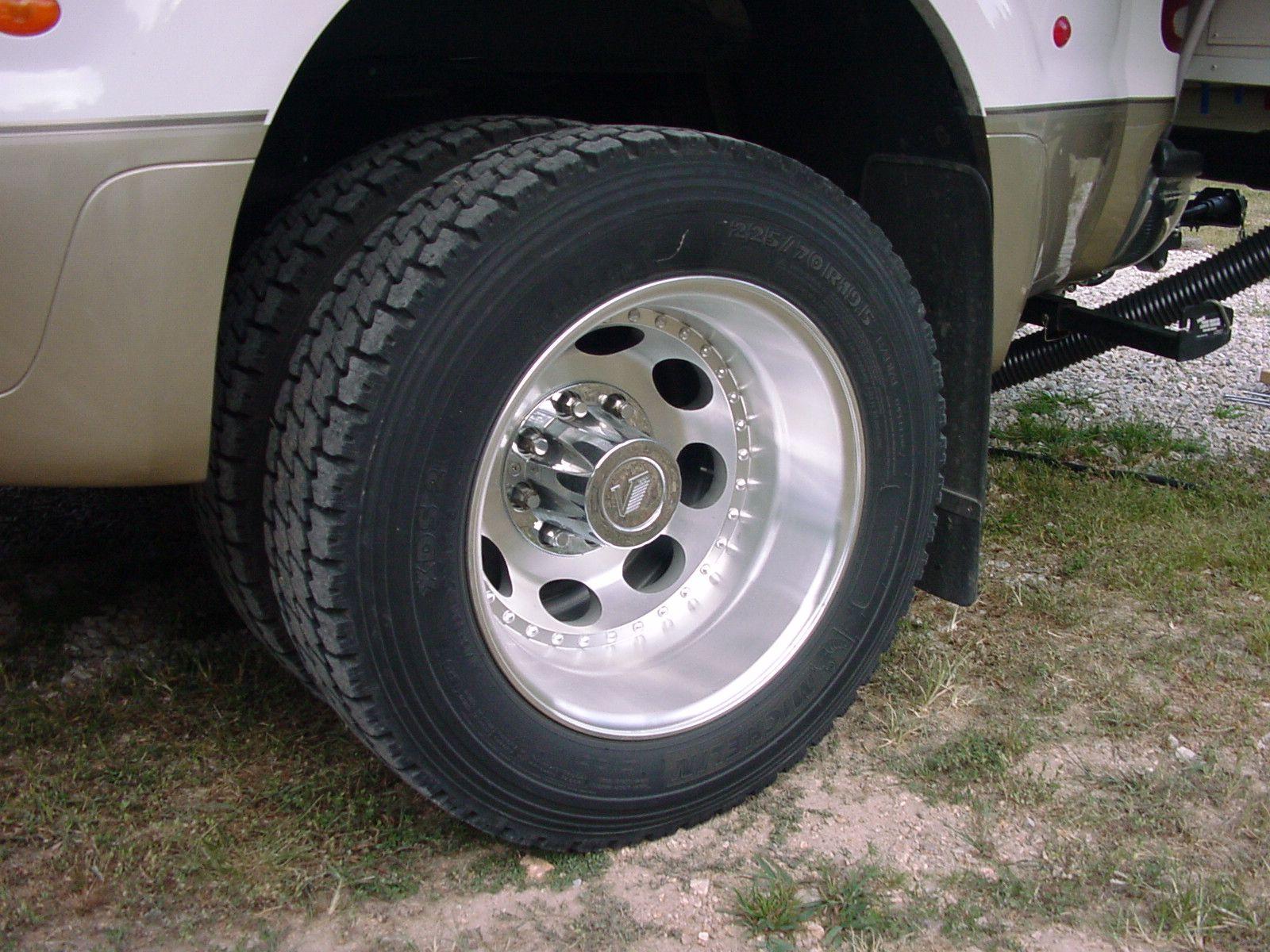

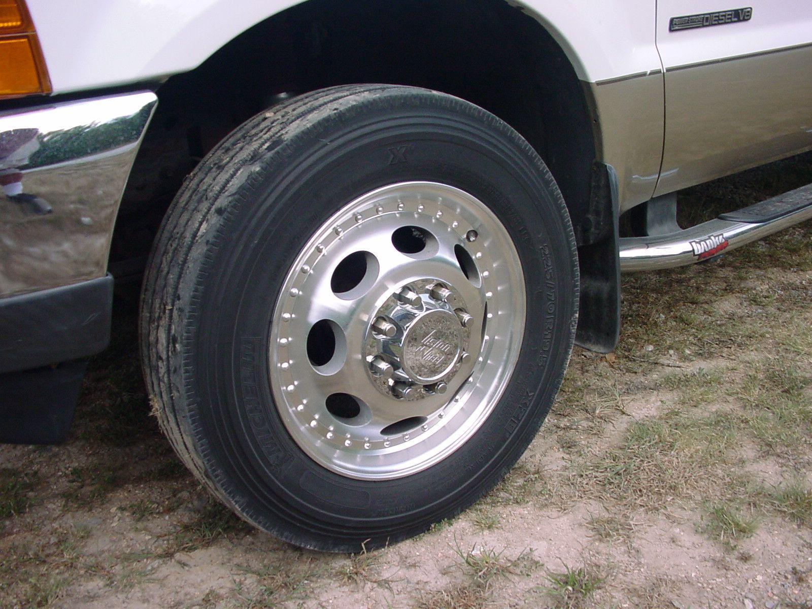

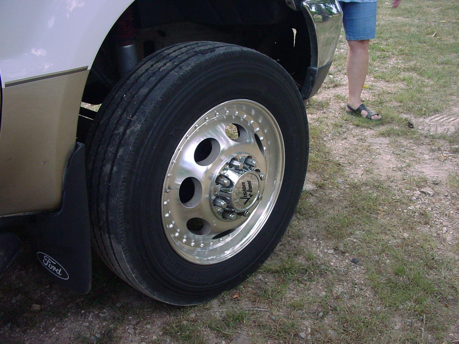

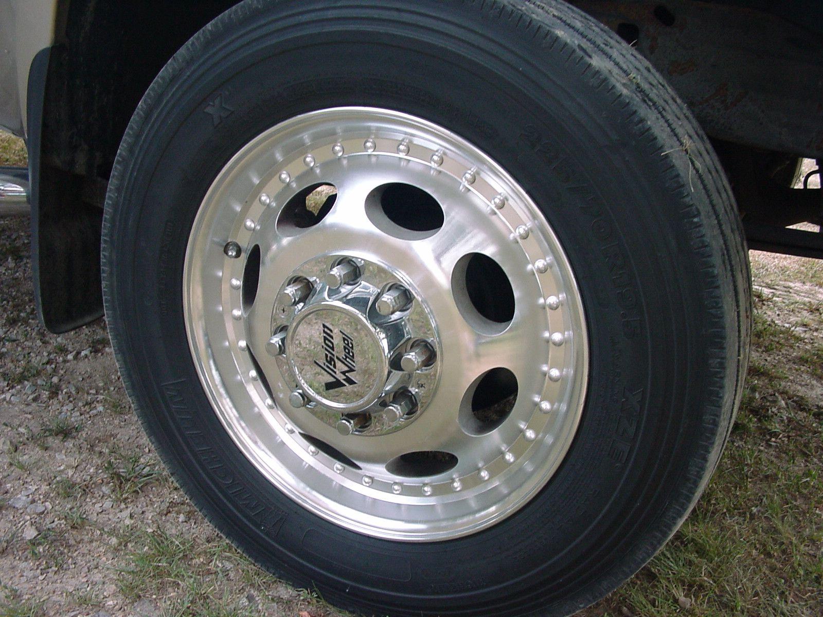

You probably will need upper spring torklifts, saw these wheels at the pick up camper rally a few years ago.. Visions I think
If you’re planning on 19.5’s I’d just get a 4500. The increase in frame/suspension/axles warrants 19.5’s, and if you need a DRW 19.5 setup then you need a 4500.
