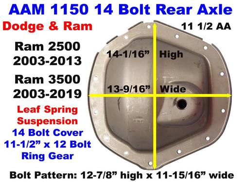

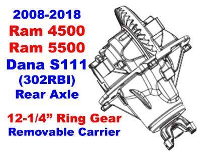

Here is some axle info:
4500-5500:
Here is 3500 info:
It doesn't have load capacities: the manufacturers calculate that in the GVWR.
4500-5500:
Here is 3500 info:

Actually......2013 through 2018 RAM 3500 DRW trucks w/AS69RC utilized an AAM 11.8 inch / 300 mm rear axle.
Additionally......best of my knowledge, the 2019 3500 DRW are now sporting an even newer AAM with a 12.0 inch rear axle, as @TFucili states.
IIRC the 11.8 was the same housing as an 11.5 with a slightly larger ring gear. The 11.8” ring gear can be retro fit into an OE 11.5” axle.
I also recall reading all R&P’s were swapped to 11.8”.
All 2019 3500’s have the 12.0, SRW or DRW. What I’m not sure of is what is in the 2500. Seems silly to have 2 axles, but then again Ford has 3 axles between F-250 and F-350 DRW.
