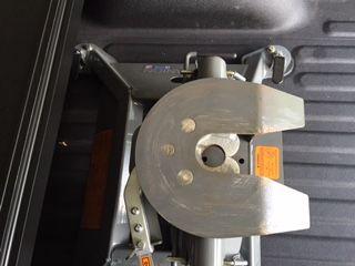

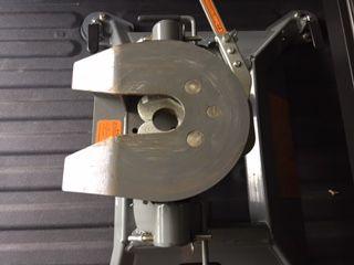

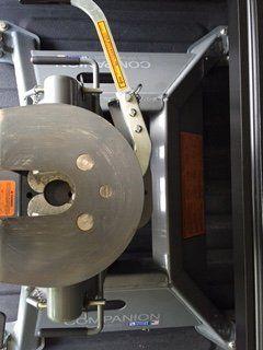

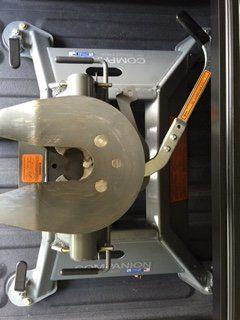

Could you give me a couple measurements?
Inside of the upper lip of the bed back to the closes point on the release handle both with it in the open and closed position. Picture of the hitch head in relation to the front pucks would be nice also. Thanks Snoking
Inside of the upper lip to closest point on the release handle closed 30 3/4", open 20 1/8". The black edge in the pictures are the back of the tri-fold.
Thanks that is the kind of info I needed. Rules out the B&W hitch for what I wand to do with my existing boxes. Snoking
