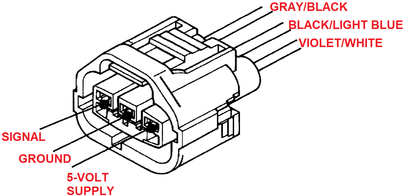

i have stuff to do tomorrow but with all 3 pcm's plugs pulled i still had 1 wire nothing, (test light) center hot brite w/test light 3rd wire was dim ( like 5 volts). i would like to check tps to see if any juice going to it while all plugs out of pcm

Are you talking about the wiring at the ESS connector? The only power to it is the 5-volt supply, the other two wires are the signal and ground. None of the three should have 12-volts to it.

wow thanks for the offer. i want to check dss wire w/multimeter that should have no power when PCM is unplugged?. its getting cold and that sucks,next few days i got stuff to do. were do you live ? i don't want you to pay any thing, this is my plow/back up vehicle. have the 20 eco diesel as a daily driver........again thanks

This should be correct for the '97. The only one that should have power to it is the 5-volt supply, and only when the key is on. It would make your test light glow dimly.
