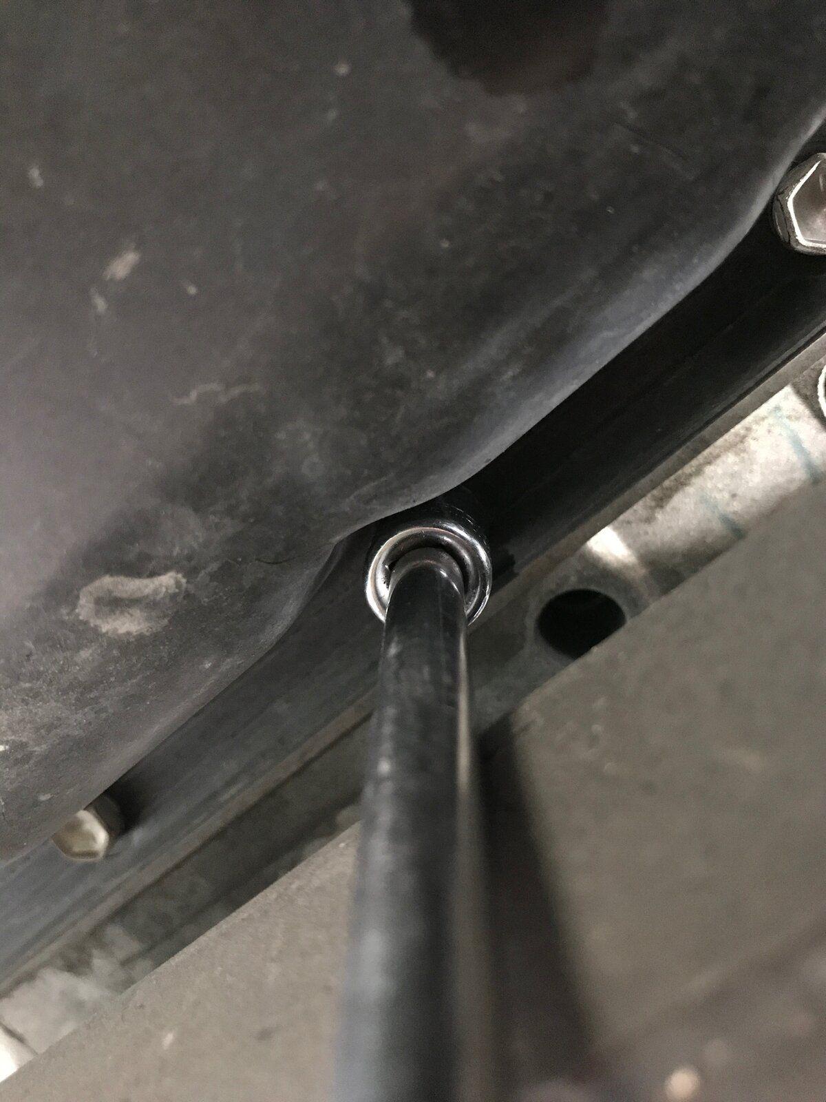

Since the PML pan utilizes 5mm hex bit style fasteners, I ended up purchasing a set of Craftsman ball socket style hex bits from a nearby Lowe’s.

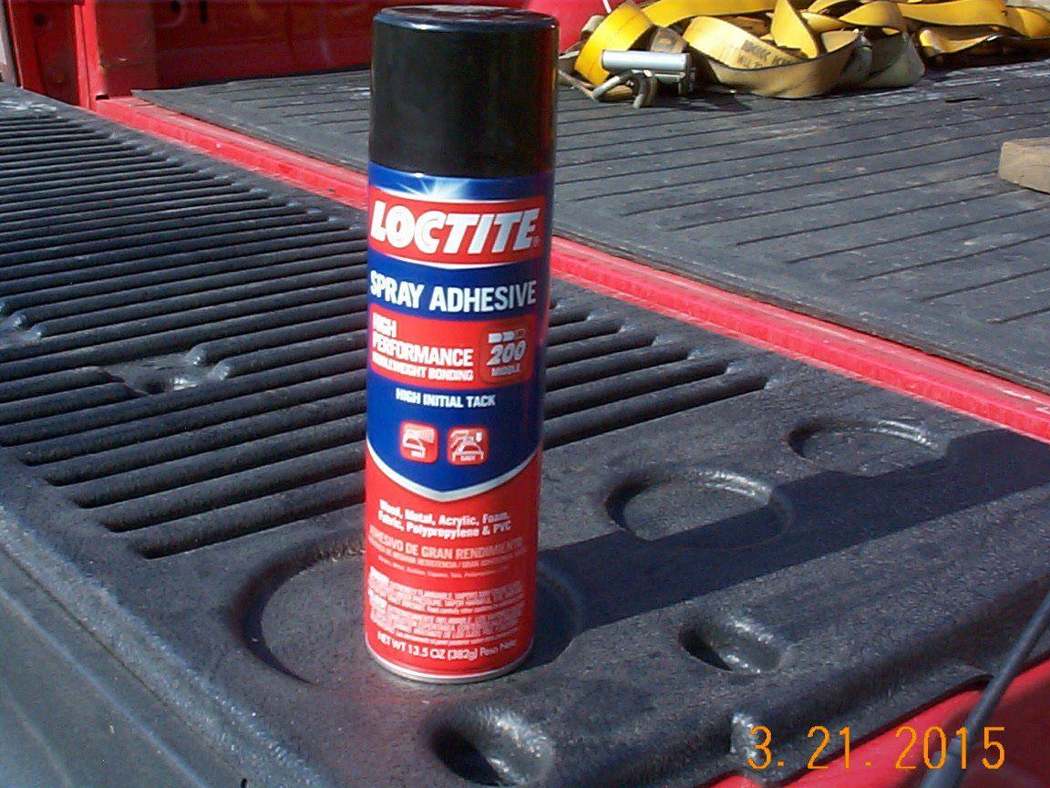

I have also found (during 6 sump filter changes on my previous 2014 RAM 3500 DRW with AS69RC and compromise 3.73 gearing) that a light coating of Loctite Spray Adhesive works wonders in keeping the gasket in place during reinstallation, and it does not prevent one from using it a few more times.

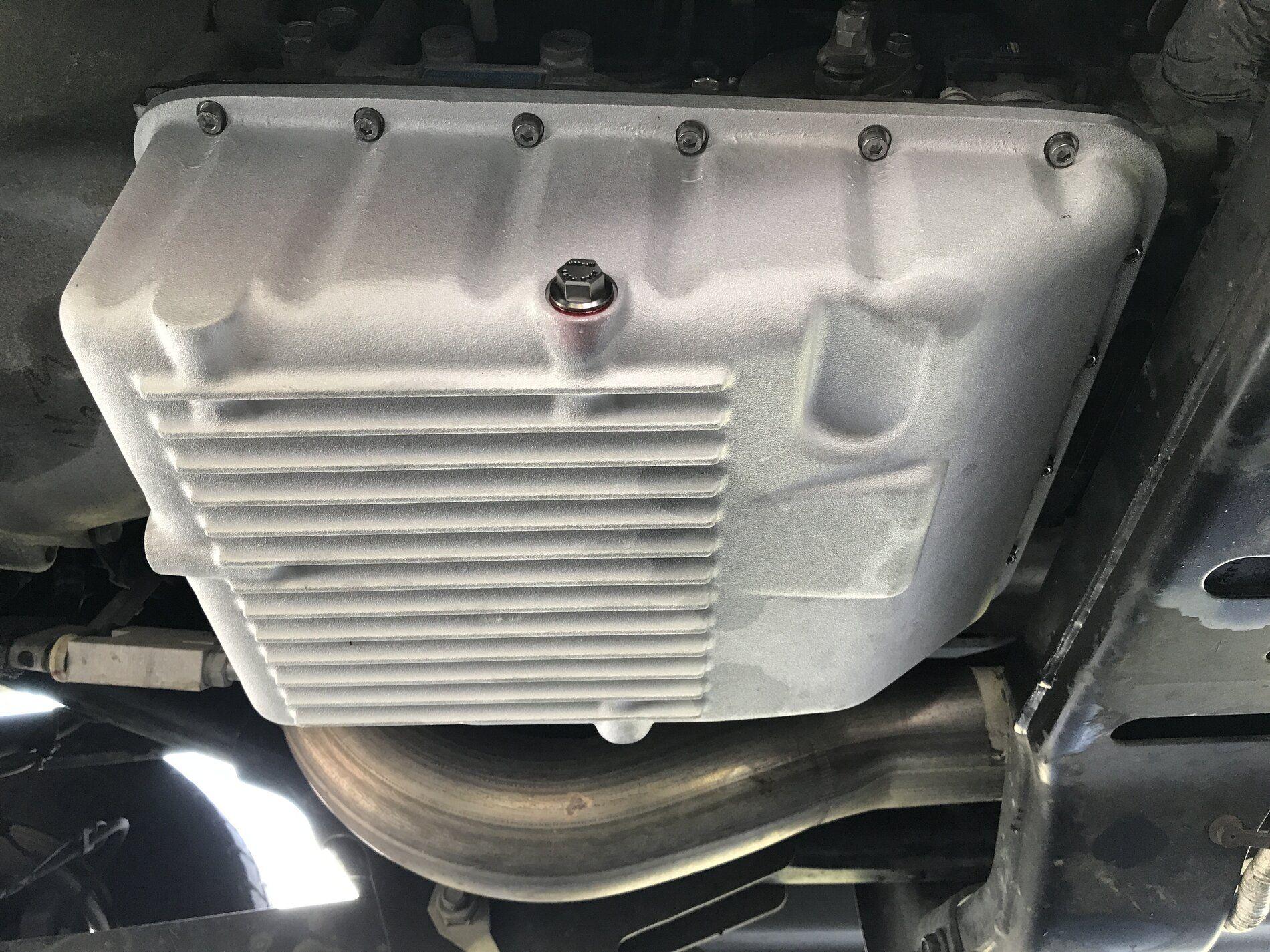

Since we all like pictures....here’s a few.....
View attachment 112305View attachment 112306View attachment 112307View attachment 112308
That pan looks slick (and the fluid capacity bump is nice) but the first thing that I noticed is all that room around the back pan bolts! That design combined with a hex fastener will make future pan drops a breeze.
All that room is a function of the 4500 cab and chassis crossmember vs the crossmember in our pickups. It is a very nice pan allthe same.
As the current owner of an AS69rc equipped cab and chassis truck (as well as a seasoned Aisin pan-drop veteran), I can assure you that is not the case. The 5500 trucks may be an exception, as I have not performed a service on that particular mode, but the crossmember is very much an issue on the rear pan bolts on the C&C trucks, as I’m sure you’ll notice if you revisit the photos uploaded earlier in this thread, particularly the shot taken directly from the side. Follow the rear taper of the pan leading to the bolts that are DIRECTLY over the front section of the crossmember. Replace that tapered section with the “inconsiderate” lines of the factory pan, and you’ll see that it is all but impossible to access these fasteners on a C&C truck, as well (at least on mine).
Doesn’t appear to be the case on Greg’s truck. That’s obvious looking not only at the picture he just posted but at the photos of his alum pan installation. You can see the crossmember isn’t shrouding the back of the pan. Since the pan mounting holes are fixed, it’s not the pan that makes the bolts accessible. It’s the crossmember.

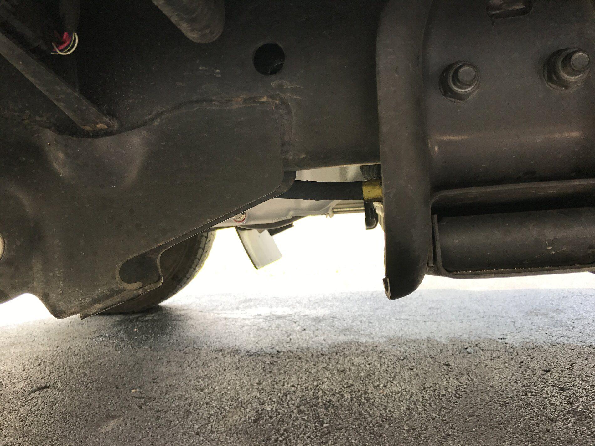

Due to the drain plug location of the PML pan, it will be interesting to see if I get the P0868 code, like I normally always got with just the sump filter replacement.
Since this is my first drain and fill with the new pan, I will need to measure the fluid drained. I’m expecting to replace between 10.0 to 10.5 quarts or so.

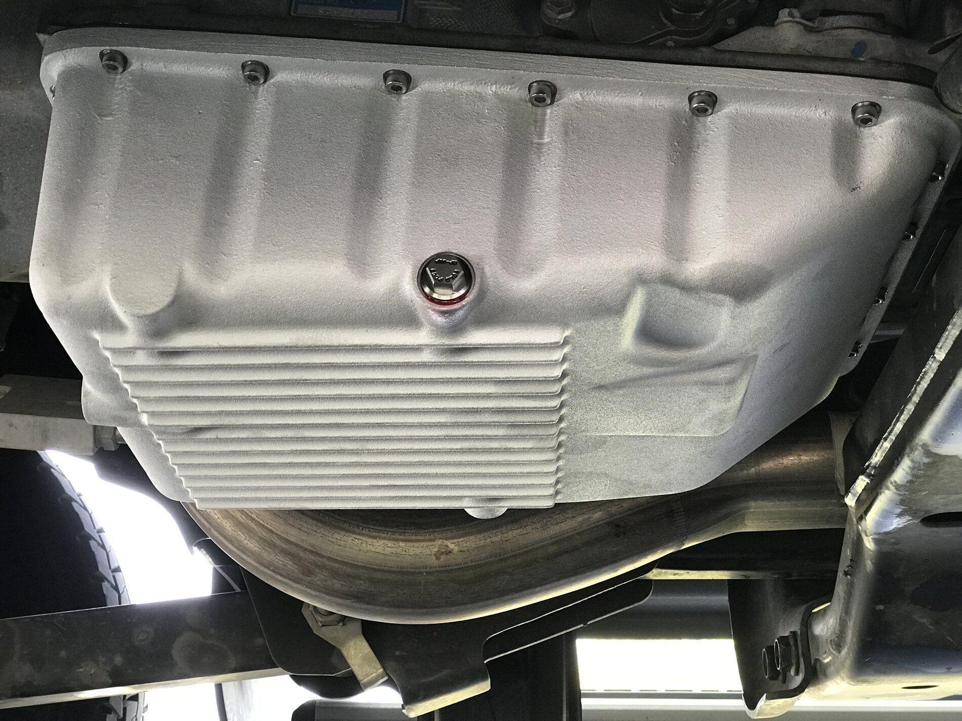

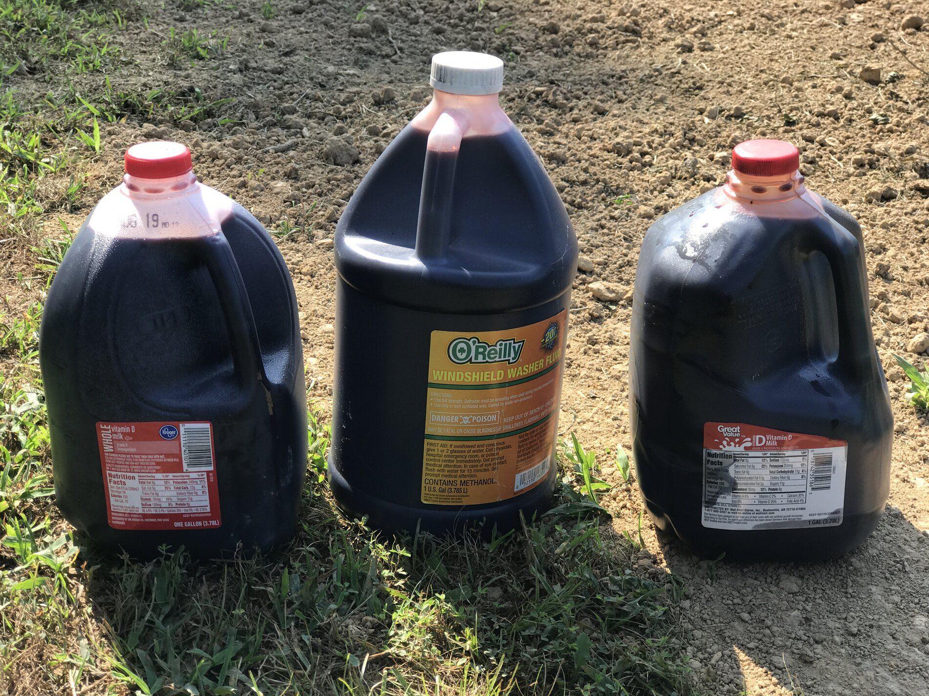

Well....the results are in.

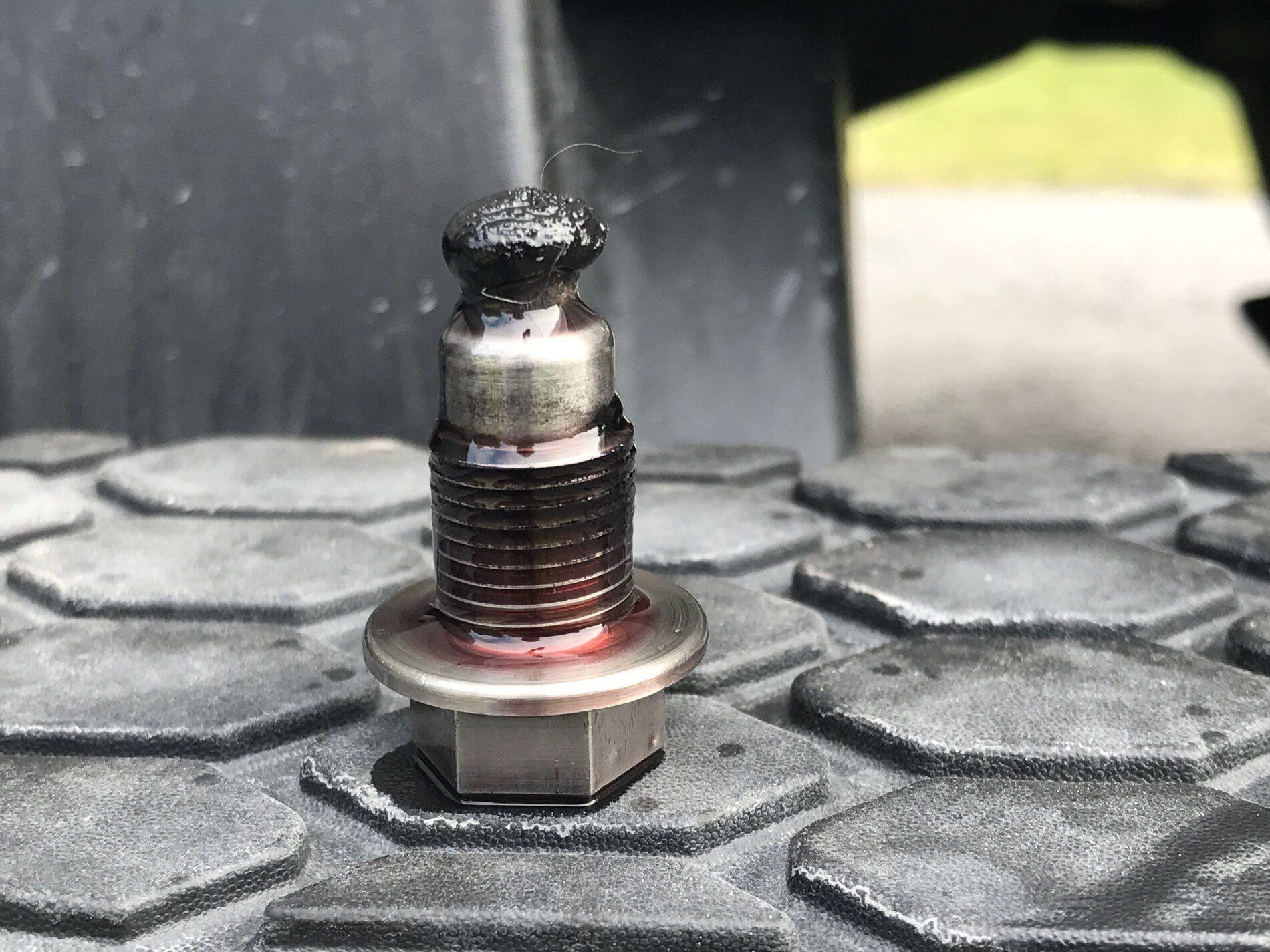

Looks like I was off a decent amount in regards to the amount drained. According to my empty containers, I drained 12.0 quarts of old Mobil 3309.
Attached are pictures of the magnetic drain plug and my 3 (1) gallon containers of verified Mobil 3309 drained. :D Yeah.....it was just a partial / half-azzzzzzzzed drain, but my AS69RC thanked me for it.
Additionally......I feel the additional fluid drained is due to the pan design. The OEM pan is angled, keeping the sump filter submerged. The new pan is more flat, and deeper, allowing the sump filter to drain freely after the drain plug is removed.
With that being said....PML touts a 3 to 4 quart increase over the stock pan.
On my OVERNIGHT drain, I will be seeing a 5 quart increase.

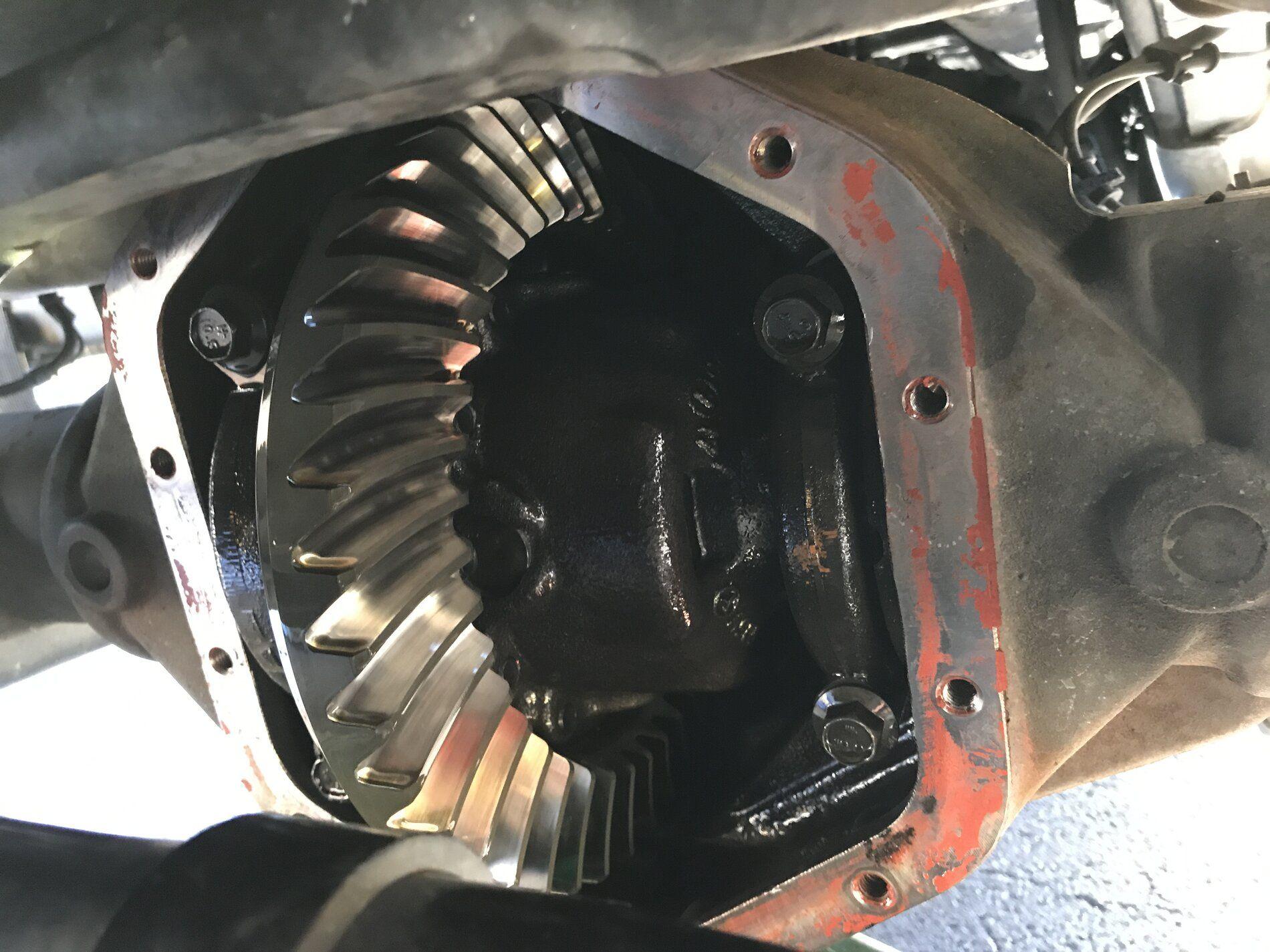

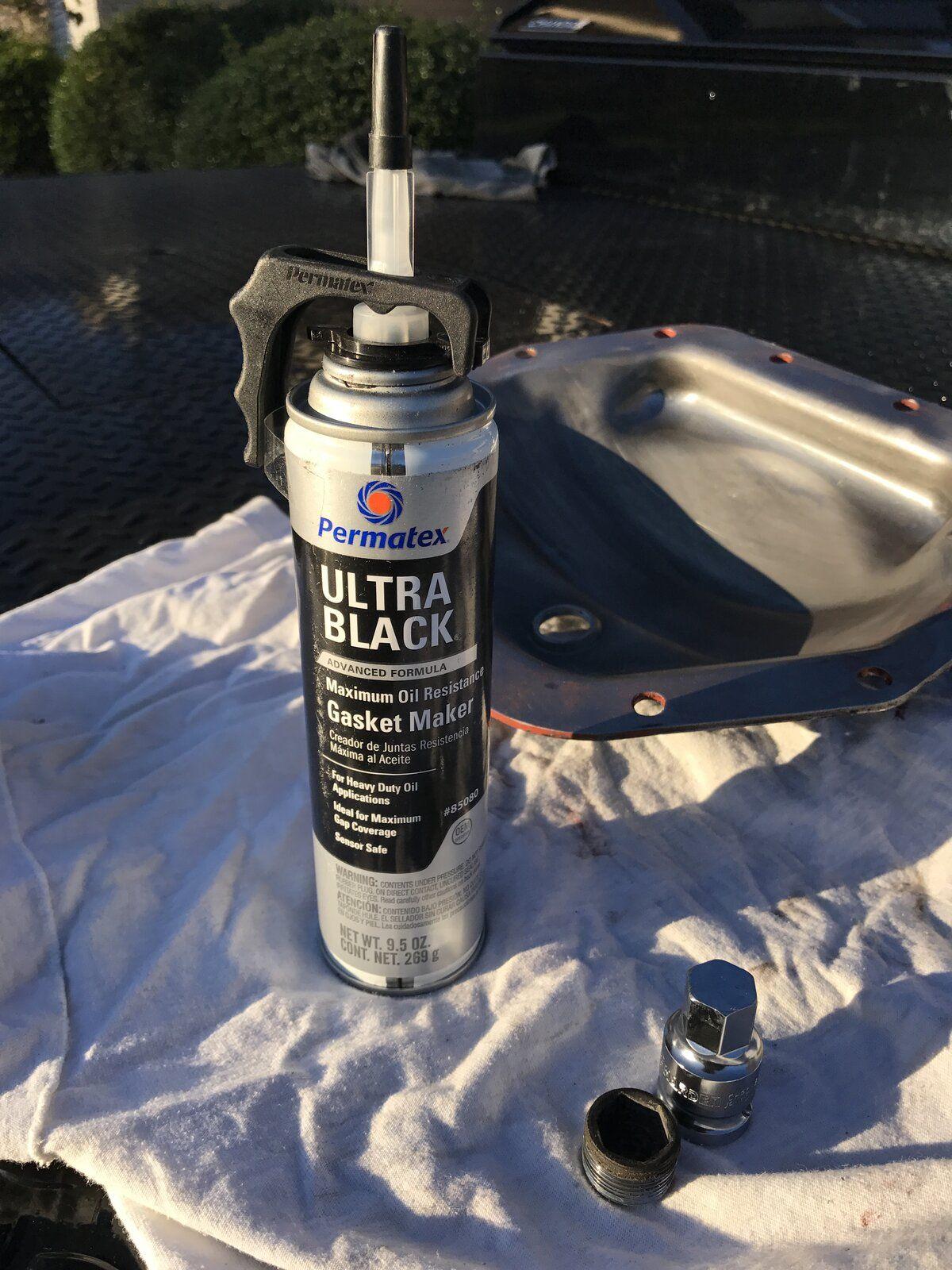

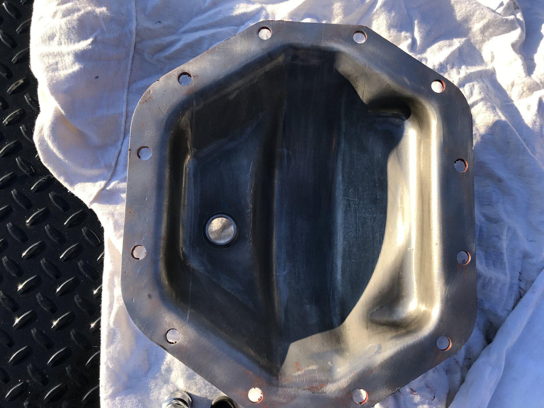

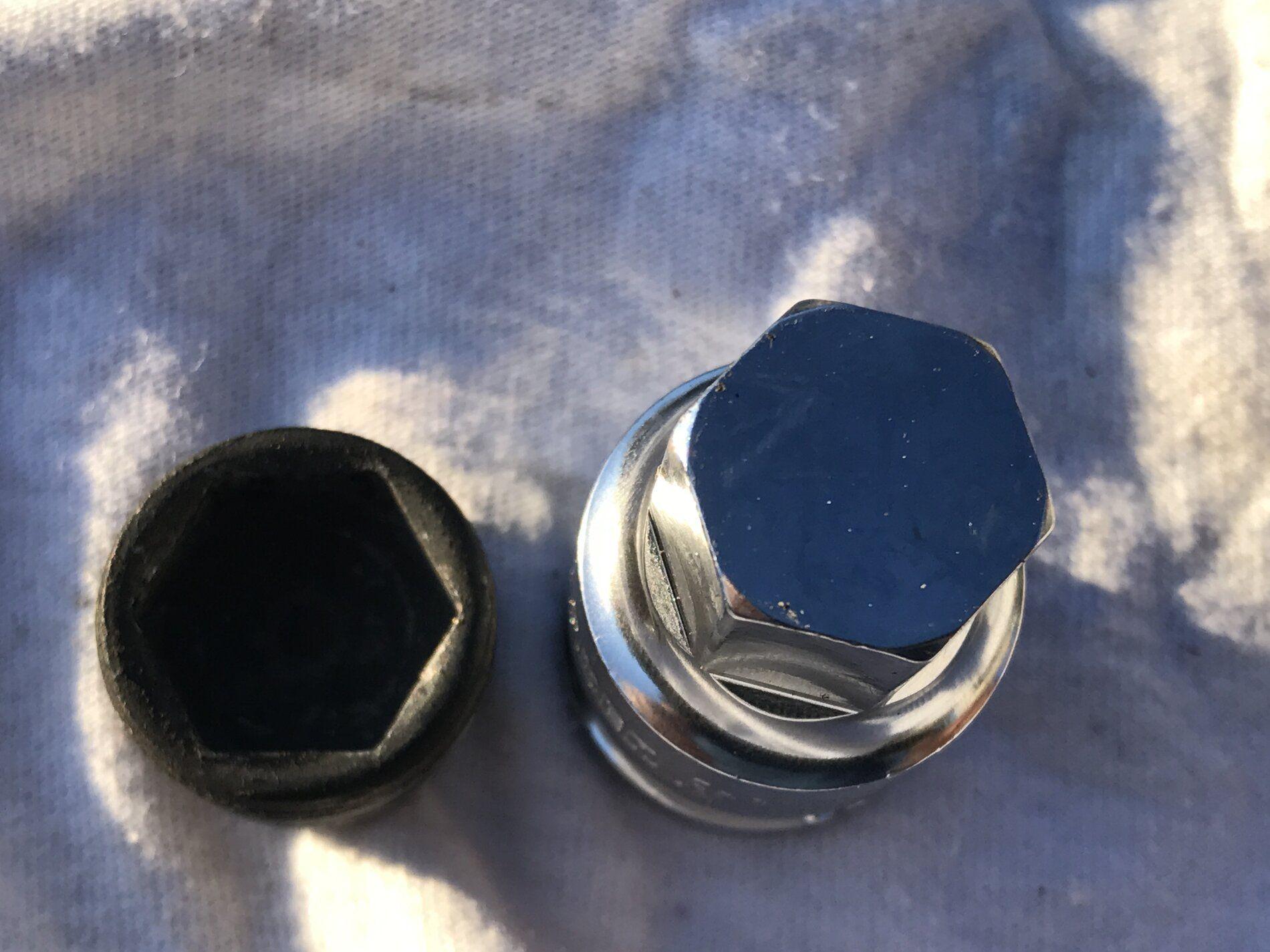

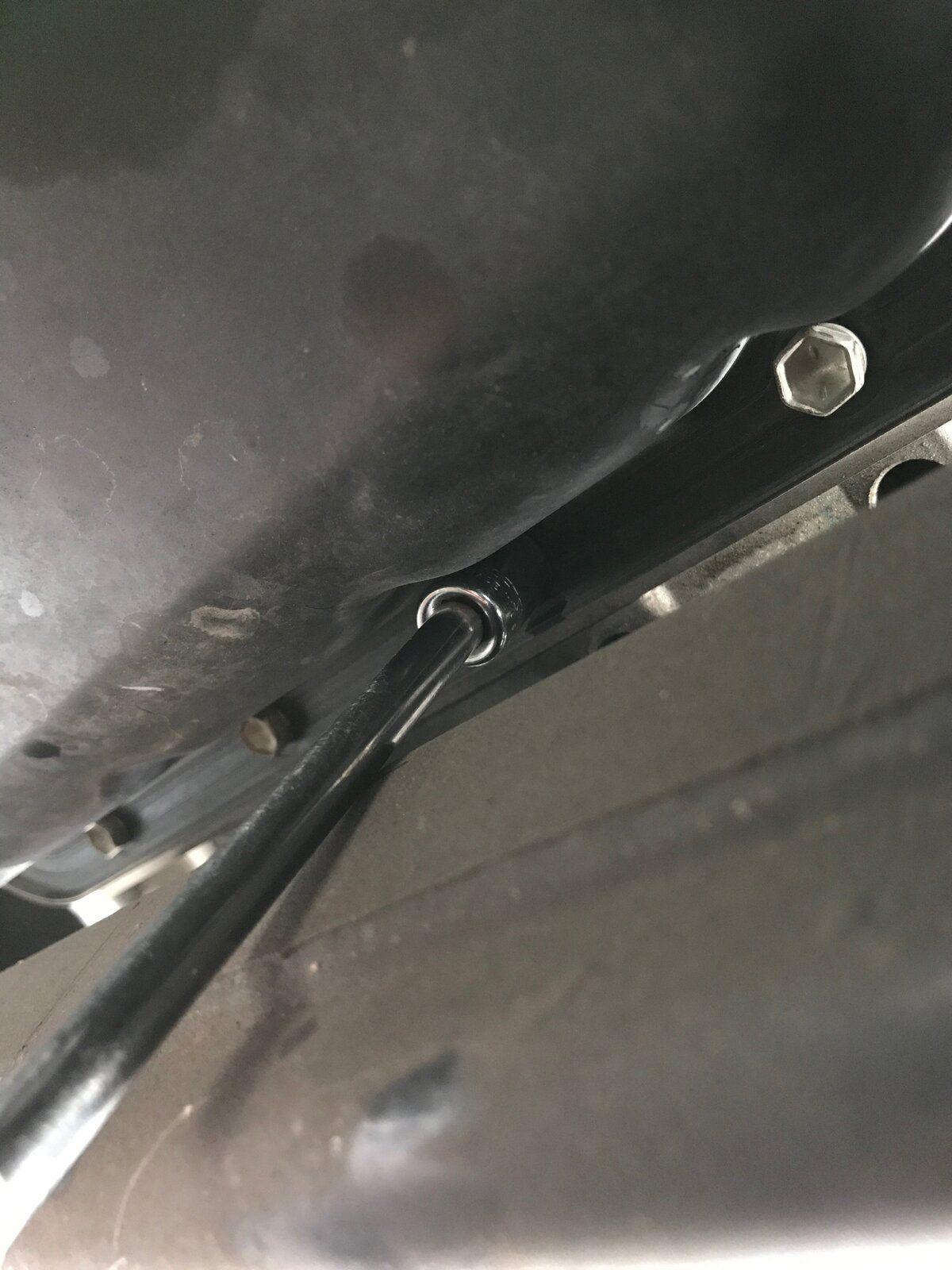

Today, at 176,235 miles, White Lightning received all kinds of TLC, in the form of...
  • Transfer case fluid change. Once again, I used two quarts of O’Reilly house brand Dexron VI.
  • Front differential change with Castrol 75W90 GL5 Synthetic.
  • Rear differential fluid change with Castrol 75W90 GL5 Synthetic.
Transfer case was the simplest of tasks. The house brand O’Reilly fluid in the form of Dexron VI has done me well all previous changes. I also rotated the tires on White Lightning. The Firestone FD690 Plus tires are doing me well.
Earlier this week, I had another 5 gallon pail of Castrol 75W90 GL5 Synthetic gear oil transferred to my local O’Reilly Auto Parts.
Today is only the 2nd time the front differential fluid has been changed in the 4500. The first time was done at my selling dealer, as I developed a leaky differential cover and the re-seal and fluid cost me $0.00 as it was a warranty item. My not-so-scientific method of checking the fluid condition (removing the plug and FINGERING THE HOLE) gave me enough confidence that it was still good. Today, when I dropped the fluid, it confirmed my suspicions that all was indeed actually well. The magnet indicated no wear as the magnet was free of debris. Having owned several 3rd and 4th GEN pickups, I’ll admit I was quite spoiled with the ease of servicing the differentials. The 4500 must be resealed as it does not have a reusable gasket. A can of Permatex #85080 gasket maker worked wonders though...
The rear axle is a breeze. Remove one of the lower bolts and out comes the fluid. Down side is it is impossible to check the “health” of the innards as the 4500’s do not have a removable rear cover. This fluid change also confirmed no excessive wear as the magnet showed no debris on it as well. Today makes fluid change #4 for the rear axle.
