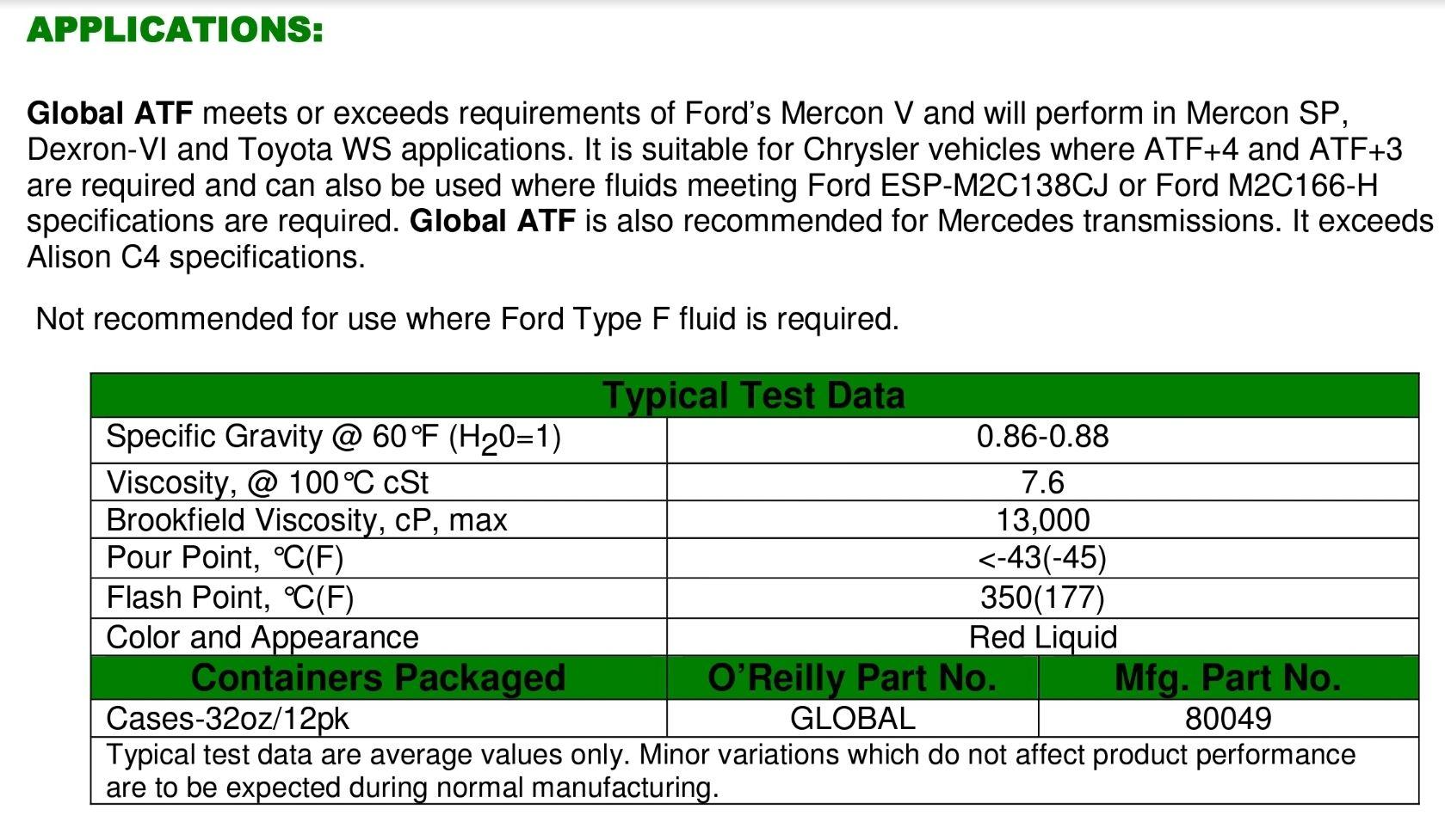

When in doubt pull the MSDS sheet for any sort of chemical they typically list the real mfg.
I run the store brand ATF+4 car quest stuff all the time, I try to pull the spec sheets it's all pretty good stuff by the numbers.
I cant easily find the DEX-VI, but the O'Riellys Global ATF is good oil by the numbers would not expect any issues with the DEX-VI from them.
Sometimes these don't link thru.
https://www.3eonline.com/EeeOnlinePortal/DesktopDefault.aspx?tabid=90

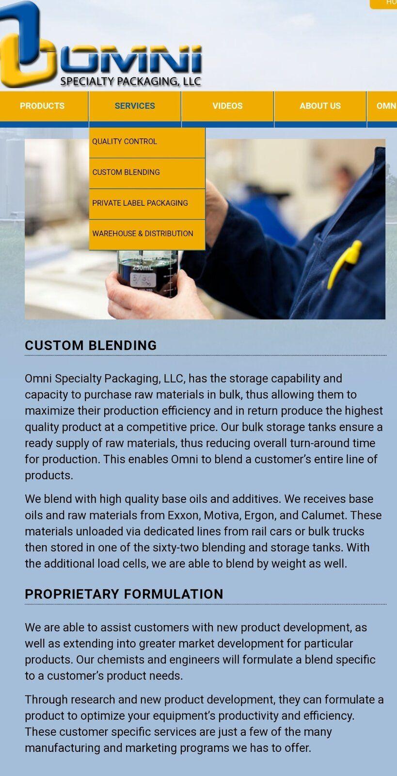

O'Reilly house brand looks like they might use two packages who do the custom blending, both are pretty impressive operations.
Omni Specialty Packaging, LLC
10399 Hwy 1 South Shreveport, LA 71115
https://www.omnisp.com/

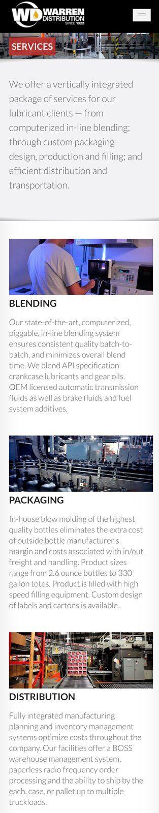

Warren Performance Packaging
Council Bluffs, Iowa 51501
Pretty neat company actually says been around since 1922,
http://www.warrendistribution.com/

I noticed carquest oil was sourced from Warren oil. It is good oil

That Global ATF is the first I’ve ever seen to cover all those specs including ATF4.
Multi spec fluids have always confused me. My wife's Mercury specs Mercon SP. The service manual specifically states no other Mercon fluid is compatible unlike most OEM fluid supercedings.
Then multi spec fluids like the Global above says it works with Mercon SP and Mercon V.
I know in the power steering and transfer case, any good ATF would do, but with the Chrysler based automatic transmissions, it had better be the right stuff or else!
Same with the Mercon SP. Notice the clever wording they use above, "will perform" o_O
I've not yet found one that actually meets the specs of SP. So Motorcraft it is for me.
