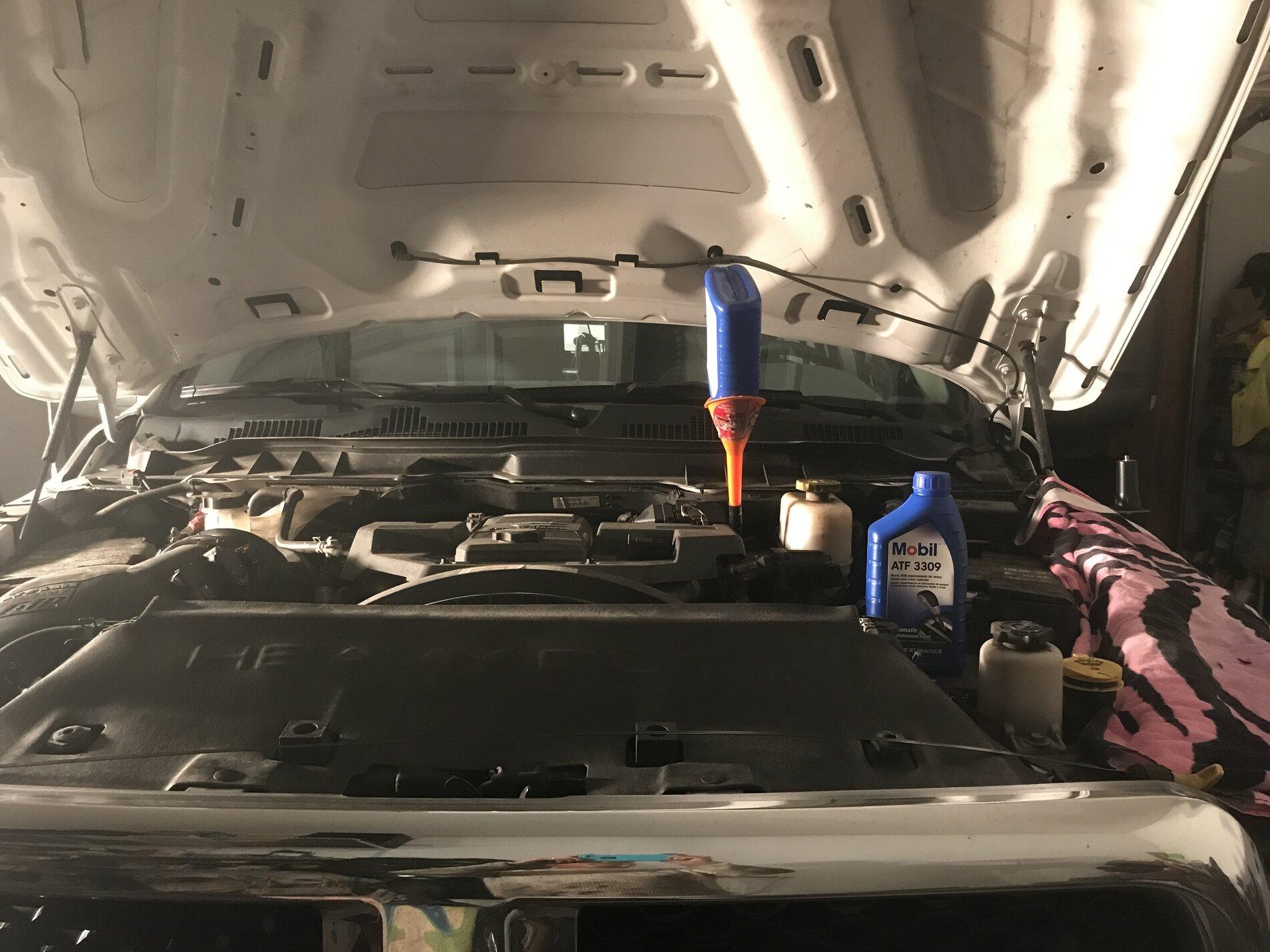

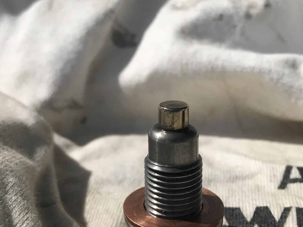

White Lightning is at 188,326 miles, 467 idle hours, and 3,300 drive hours, so that means it’s time for another transmission sump filter and more Mobil 3309 transmission fluid.
All went well, although I was a few miles over on the previous 30k drain and fill, and a tad over cumulatively on the actual sump filter change, too.
A new sump filter and 12.5 quarts later......all is well for White Lightning once again. I’m actually all caught up on ALL of my maintenance for now, which is good with winter coming around.
The ol’ AS69RC still shifts and performs as new.....and has been subjected to some fairly high GCW figures.

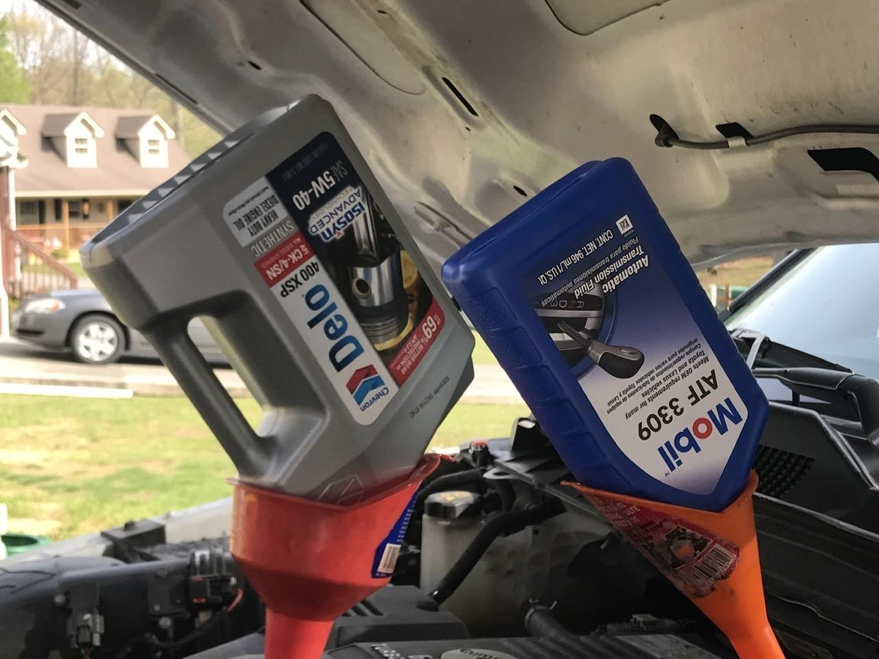

White Lightning is steadily creeping up in mileage (223,840) so more maintenance has been performed the last little bit.
On May 4th, it received a DBL7349 oil filter, 3 gallons of Chevron Delo 400 5W40 Synthetic, MOPAR air filter, both MOPAR fuel filters, two MOPAR premium wiper blades, greased front end parts and driveshaft, and 11 quarts of Mobil 3309 transmission fluid went down the chute.

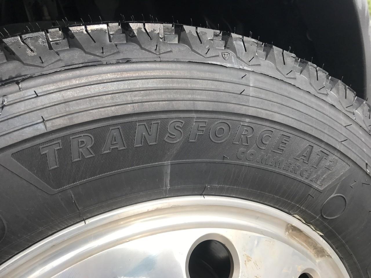

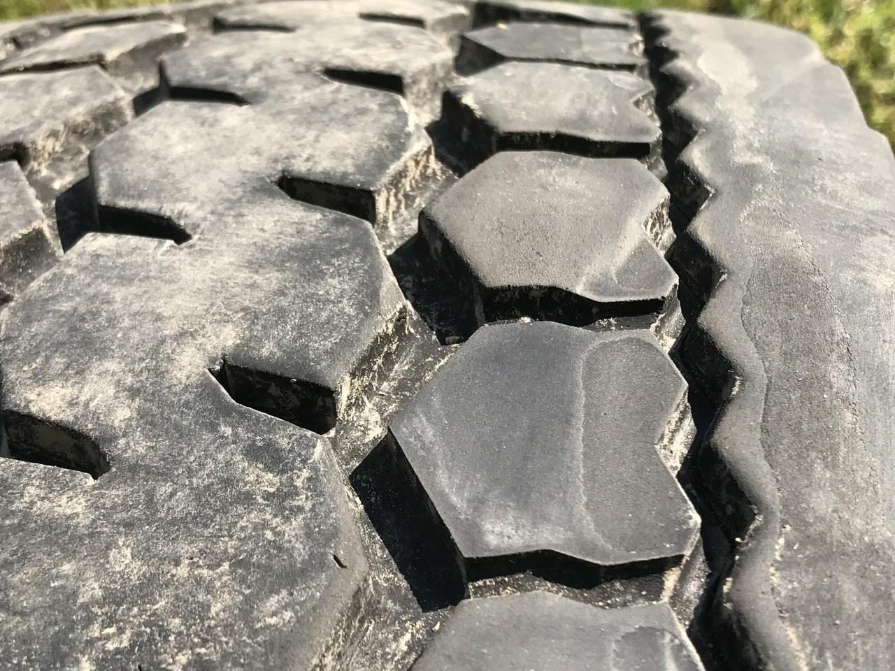

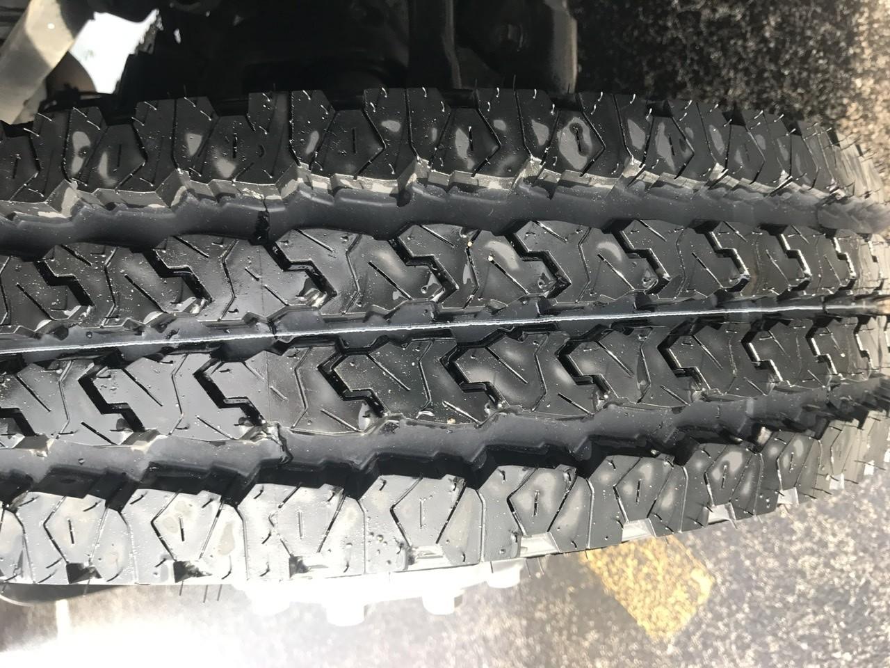

Also....I replaced the two front tires as worn shocks was causing some very uneven wear. This time, I went with some new Firestones in the flavor of Transforce AT2 in 225/70R19.5 in 14 ply (LRG) article number 004-196. These tires seem great after about 1,000 miles of use, and are much quieter than the FD690 Plus tires they replace. They are more in line of the Continental HDR’s that were OE on my 4500.
Along with the two tires, I did get my alignment checked and set to -0.01* total toe. The steering wheel is straight cruising down the road.
Since we all like pics.....here’s a couple of the new rubbers. :D

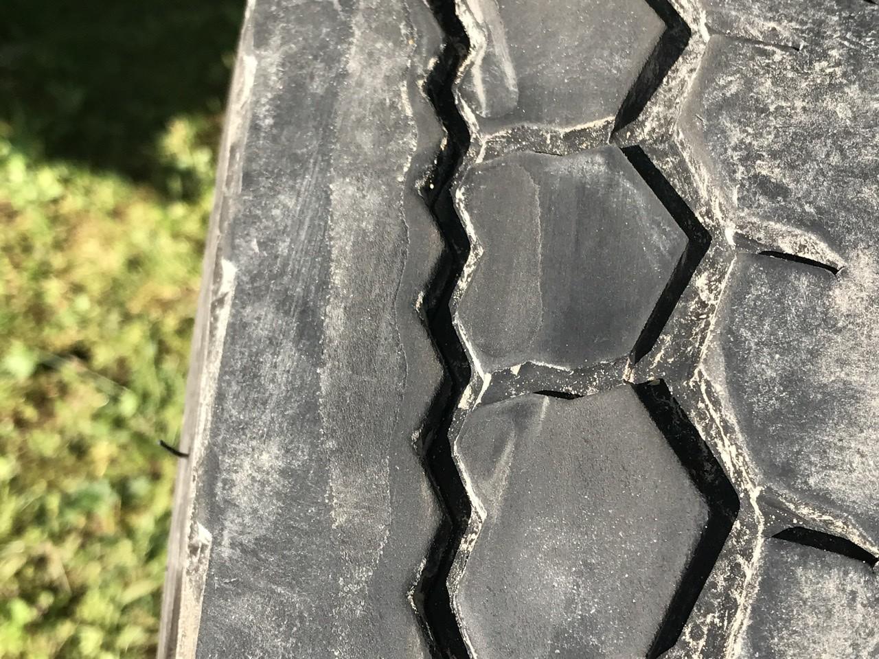

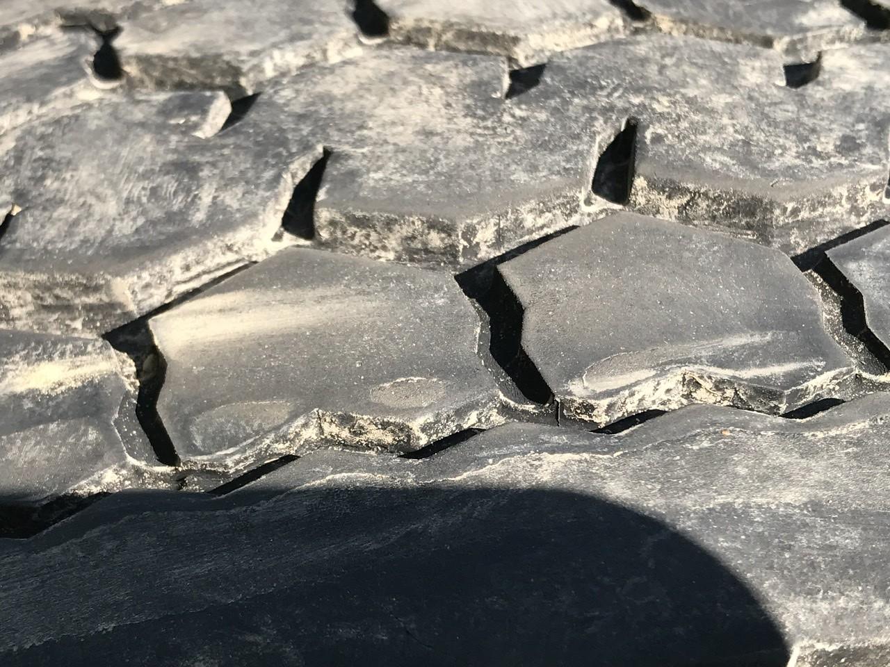

Out of curiosity, what was the wear you were seeing on your front tires from the old shocks? Inside wear?
Hey JR.....
Not sure if these pics will reveal what I’m going to describe, but the tread wear on each tread block opposite of the main center tread rib began wearing unevenly. The “leading” edge of the tread block was upwards of 1/32nds to 2/32nds higher than the “trailing“ edge of the tread block, when looking at it based from the direction of rotation. The R/F was worse, but the L/F wasn’t far behind.
Greg, was it pretty much all the way across the tread? If so, that's what mine was doing. I am hoping replacing the bad shock resolved it, but have not logged enough miles to judge, yet. Maybe I'll have to bootleg a load or two for you:D
Hey Tom......in most areas, it was in either tread opposite the main center tread, as a rule. However....there were a few worn places that was indeed all the way across the tread.
In other words, they almost feel like running your hands across a saw blade? (not quite as dramatic, just for comparison)
My boys tires started doing the same but everything in the front is tighter than two coats of paint. But the struts were original - we just replaced them last night. I'm making him get another alignment done because the tires are still pretty new but I'm hoping the shocks were the culprit.
Yes......small mountains and valleys I guess you could say....
