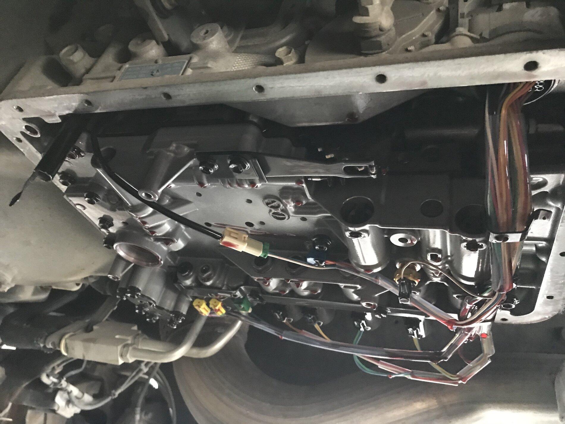

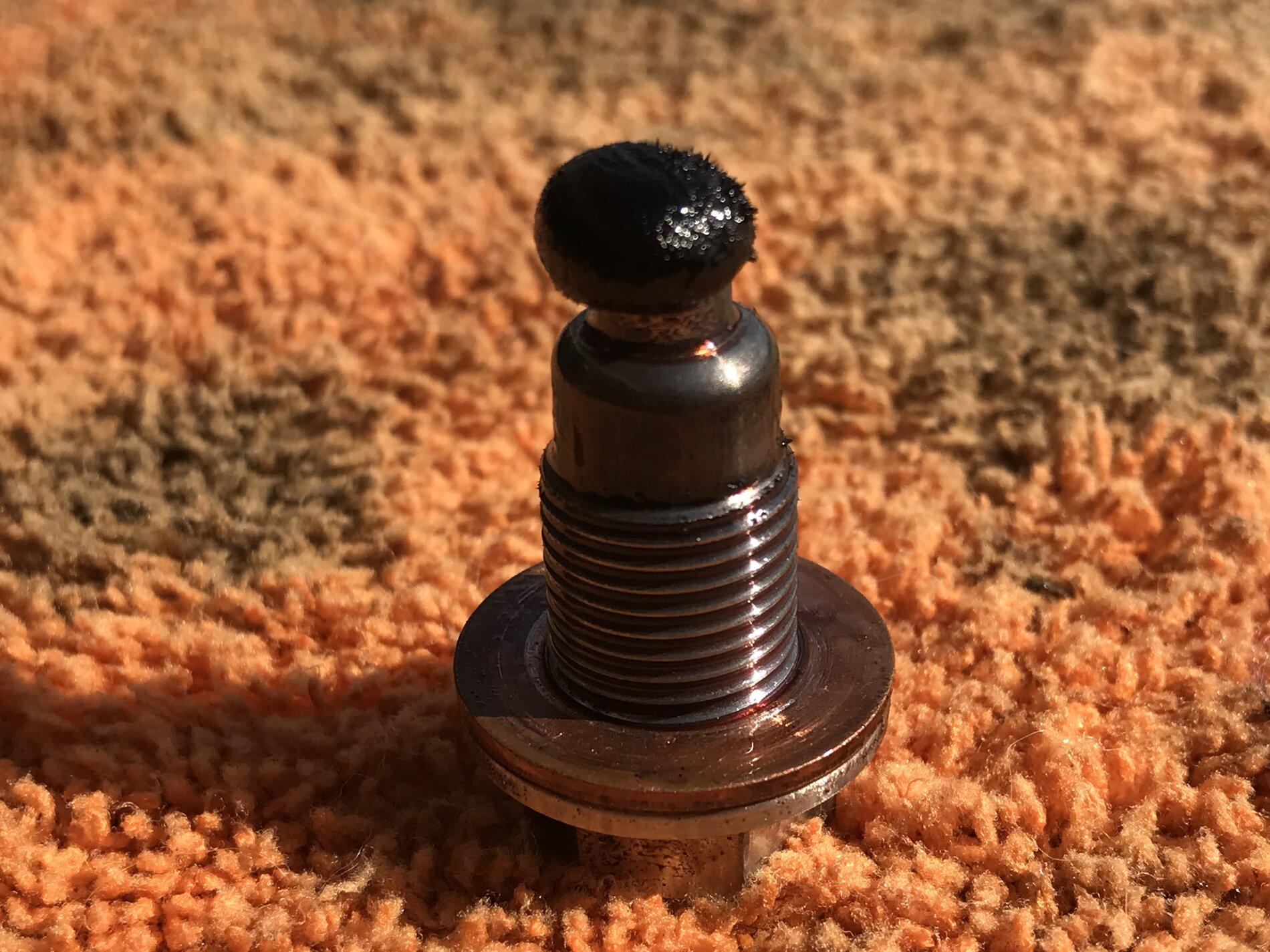

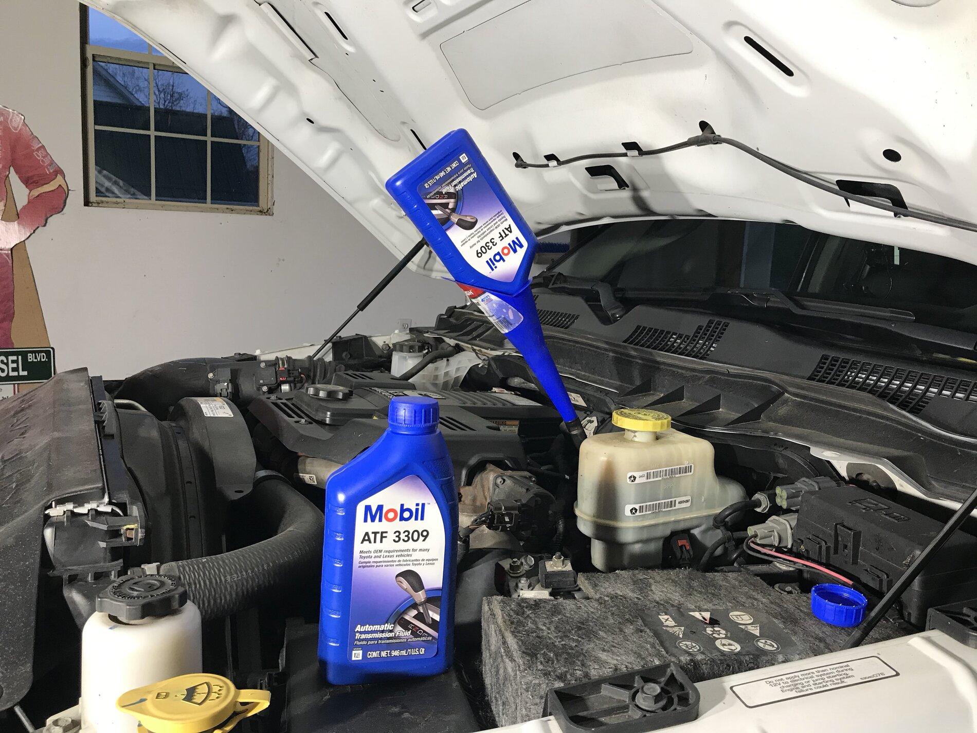

Just today I serviced the ol’ AS69RC once again with a MOPAR 68224232AA sump filter and 13 quarts of Mobil 3309. White Lightning is currently at 257,448 miles, 646 idle hours, and 4,477 drive hours. Saturday night I rolled in from a 3,032 mile run, and I was actually overdue by about 2,000 miles plus or minus. All I did was drop the drain plug from the PML pan, allowing it to drain for about 19 hours before dropping the pan later today.
As usual, I received the P0868 code, but I did also encounter a 2nd code this time that I’ve never gotten.....a P0731 code “gear 1 incorrect ratio”. Previous sump filter changes have always yielded the P0868, and occasionally a P0869, but this P0731 was brand new.
In any event, I received the usual hard slamming of gears from park to reverse, then from reverse to drive. I cleared the codes and took it for a test drive to double check the fluid level after reaching operating temperature.
My 15 mile or so test drive yielded nothing out of the ordinary. It shifted perfectly and showed no signs of any incorrect gear ratio.
I can understand the P0868 line pressure code when dropping the fluid, but the 0731 I hope is not a sign of things to come. Will Alfa OBD graph transmission functions? You might be able to see how or why 0731 is happening.
The newer Ford 6 speeds are very finicky after a fluid drop. I have a landfill road I use where I’ll put it in 4lo (gotta test that anyway) and that will tickle all the shift solenoids a couple of times without going fast or far. I wind up adding to the sump level after that. No codes get set on those.

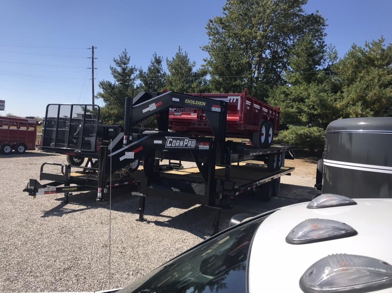

I guess I’ll find out later this morning.....heading to Elnora, IN to Corn Pro to pickup three trailers.
535 miles later.....and all is well. Shifted perfect today while towing a 6+21 tilt gooseneck, 20+5 gooseneck, and a 14’ dump trailer. Unsure on exact weights as I had no MSO’s and didn’t look at the VIN stickers that closely. I’m guessing about 17,500 to 18,500 lbs of trailers though.

Today it received a 68224232AA transmission sump filter, 68214914AA pan gasket, and 12.5 quarts of Mobil 3309 transmission fluid. I had used the OE transmission pan gasket four changes previously, so I decided to swap it out this sump filter change.
I ran out of time to drain and fill the transfer case....but that’ll get done later on Friday.
