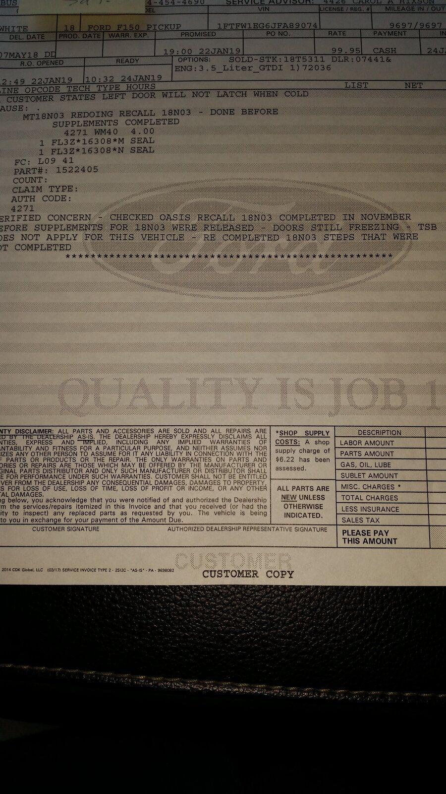

I picked up the Ford this morning. Looking at my reciept, the Recall and TSB supplement were applied in November. So, they redid the 18N03 supplement with updated seals.
I'm not expecting any different results from the last attempt.
